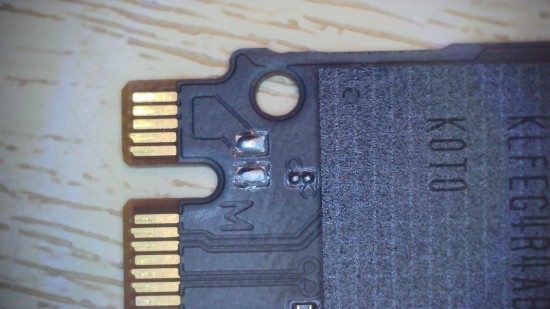

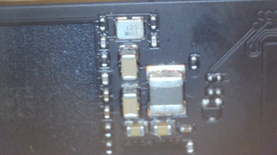

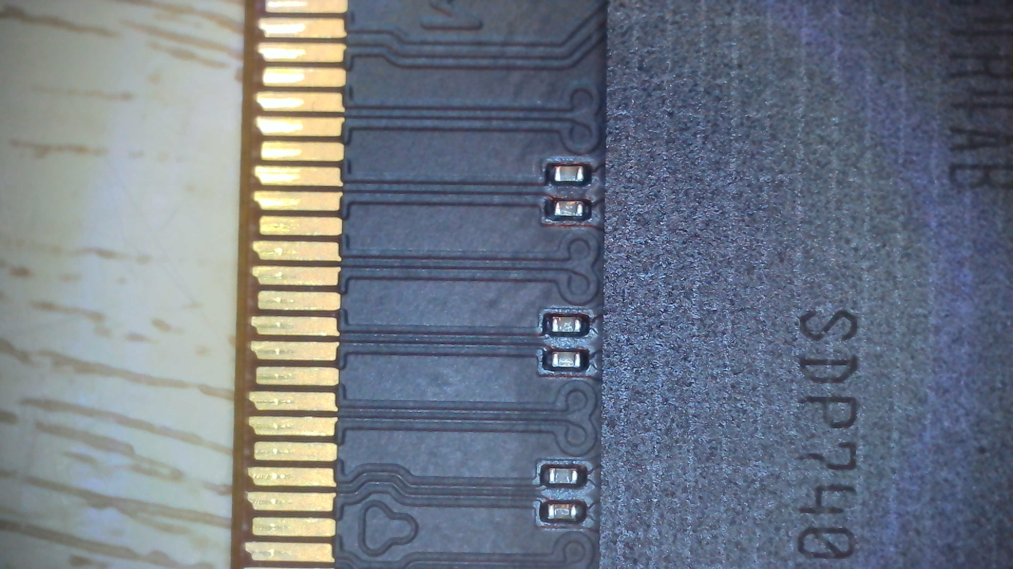

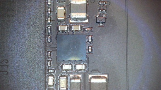

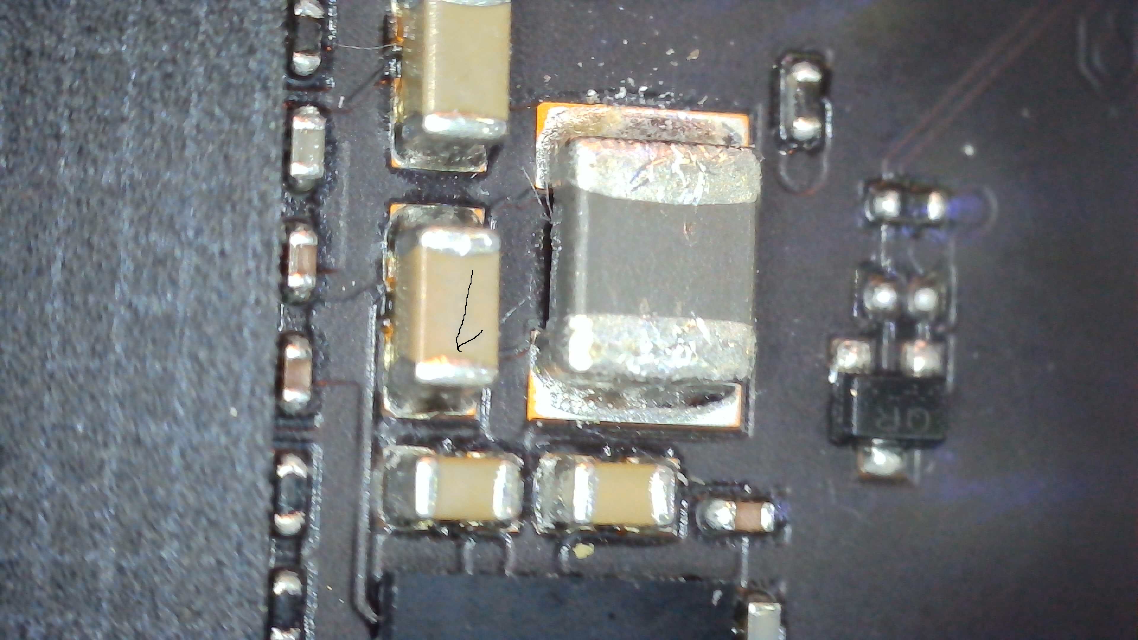

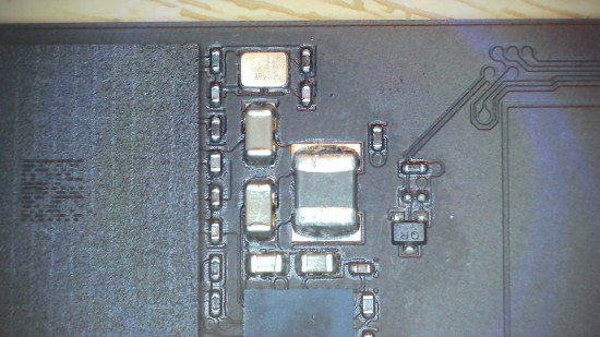

Hi everyone, I have this ssd nvme that has suddenly stop to works. It was in a laptop. I unplug it from the laptop and connected via usb adapter to another PC. The drive is not detect, nothing. I tried with Win10 and Lubuntu but same.
Then I grab my thermal camera and noticed the top side of the nand chip went hot immediatly, raising the temp from 50 to 85 deg in a minute. I inspect the board and take some resistance measurments to ground but no short detected. I suppose the nand is shorted internally. Can you help me diagnose this drive and eventually fix it?
I can take also voltage measurments but I don't know what should I aspect.
Thanks you all

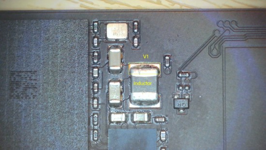

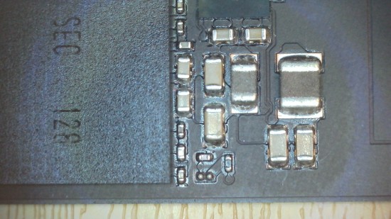

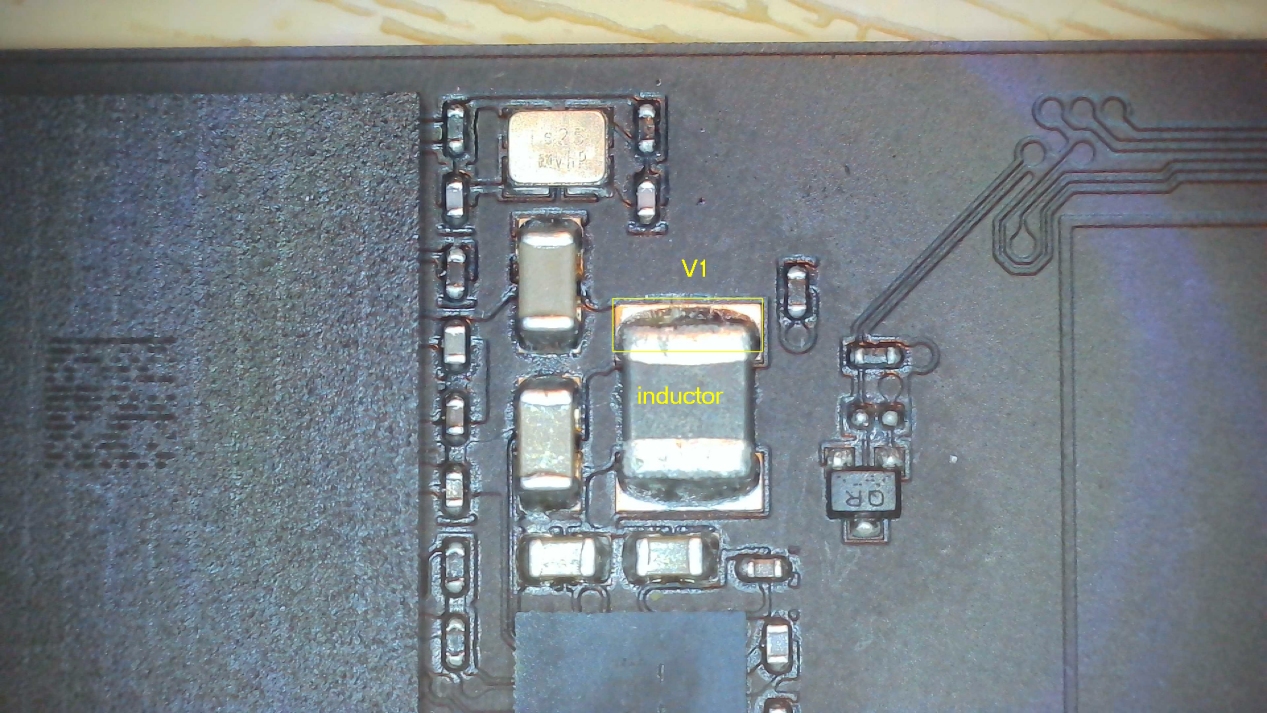

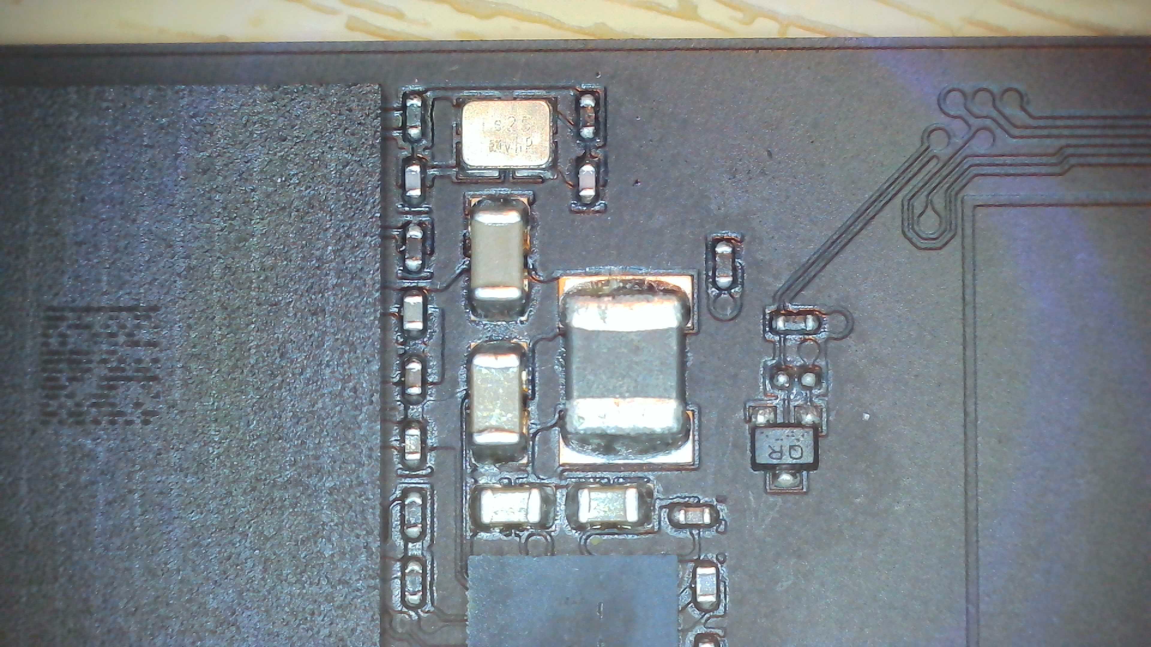

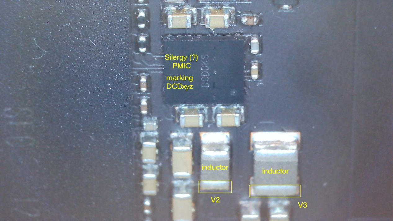

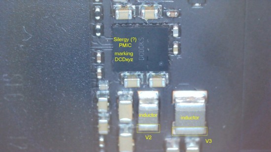

Measure voltages V1, V2, V3. Also measure the resistances between ground and each of these test points.
Resistance at Inductor1 = 147 Ohm
Inductor 2 = 4.7 KOhm
Inductor3= 1MOhm (ish)
The Ind3 resistance is decreasing during the measurments
V1= 0,9 V on top and 0,93 V on bottom on the ind1
V2= 1,8 V
V3 = 2.5 V
 Post subject: Re: SSD Samsung PM991a fail
PostPosted: November 9th, 2025, 12:07
Posts: 17335

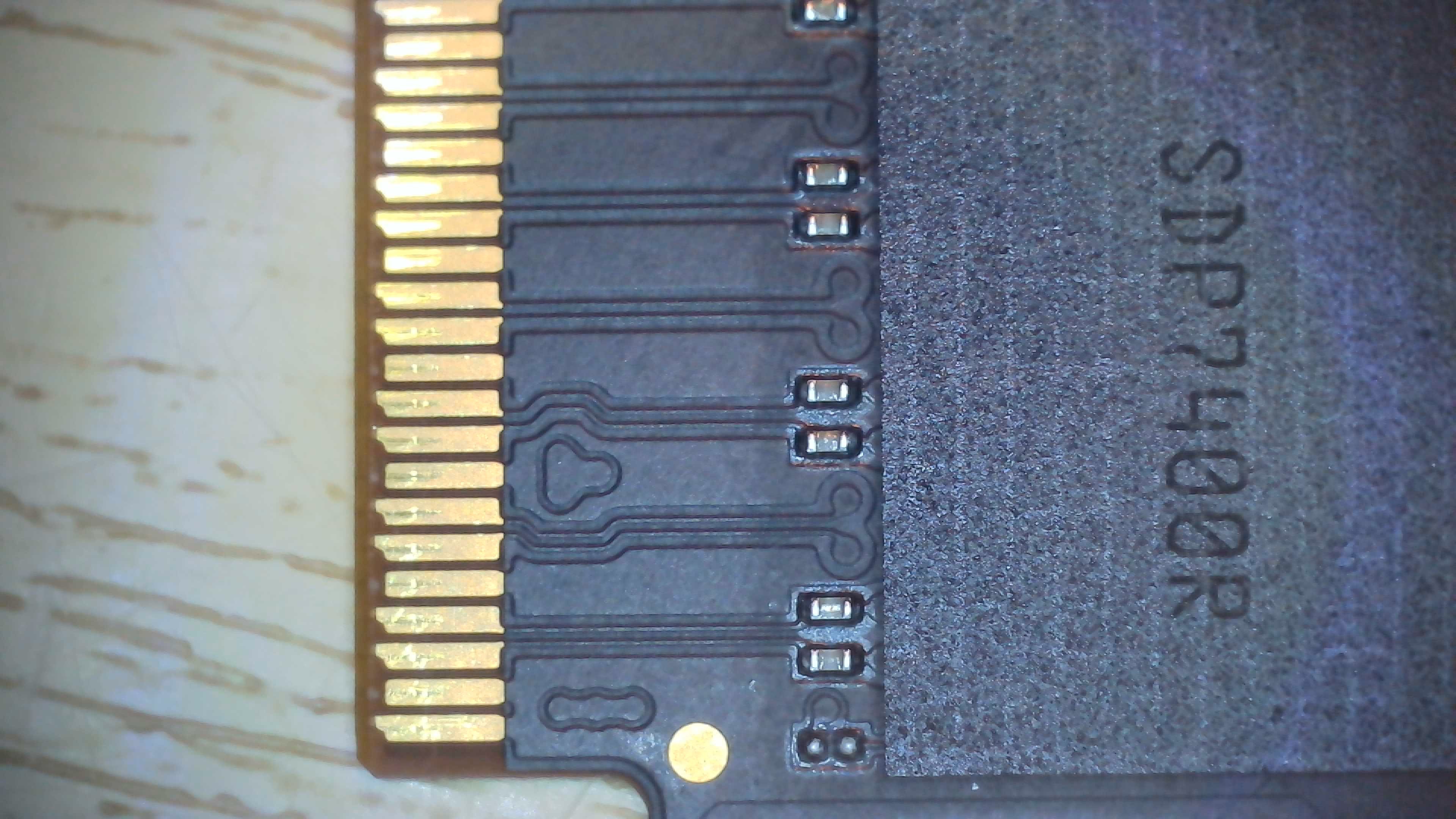

There are no shorts, but I don't know what to make of V3. I would measure the voltages on the small bypass capacitors surrounding the NANDs.

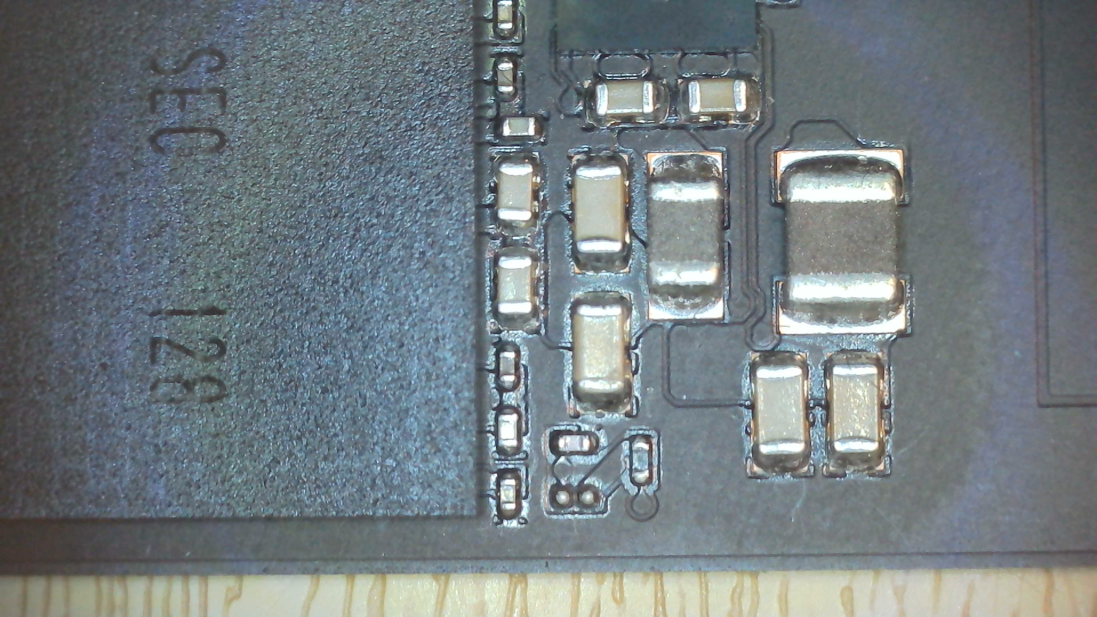

Sorry i did not understand the V3 thing. It has suppose to be different than 2.5V?
Those are the tensions of all the strips on the right of the nand chip.
0.3 on both sides
0
0
0,9
0,9
0,9
1,8
1,8
1,8
1,8
1,8
1,2
1,2
2,5
2,5
2,5

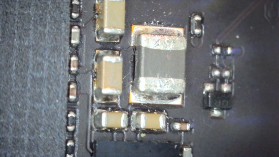

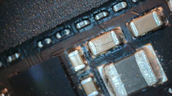

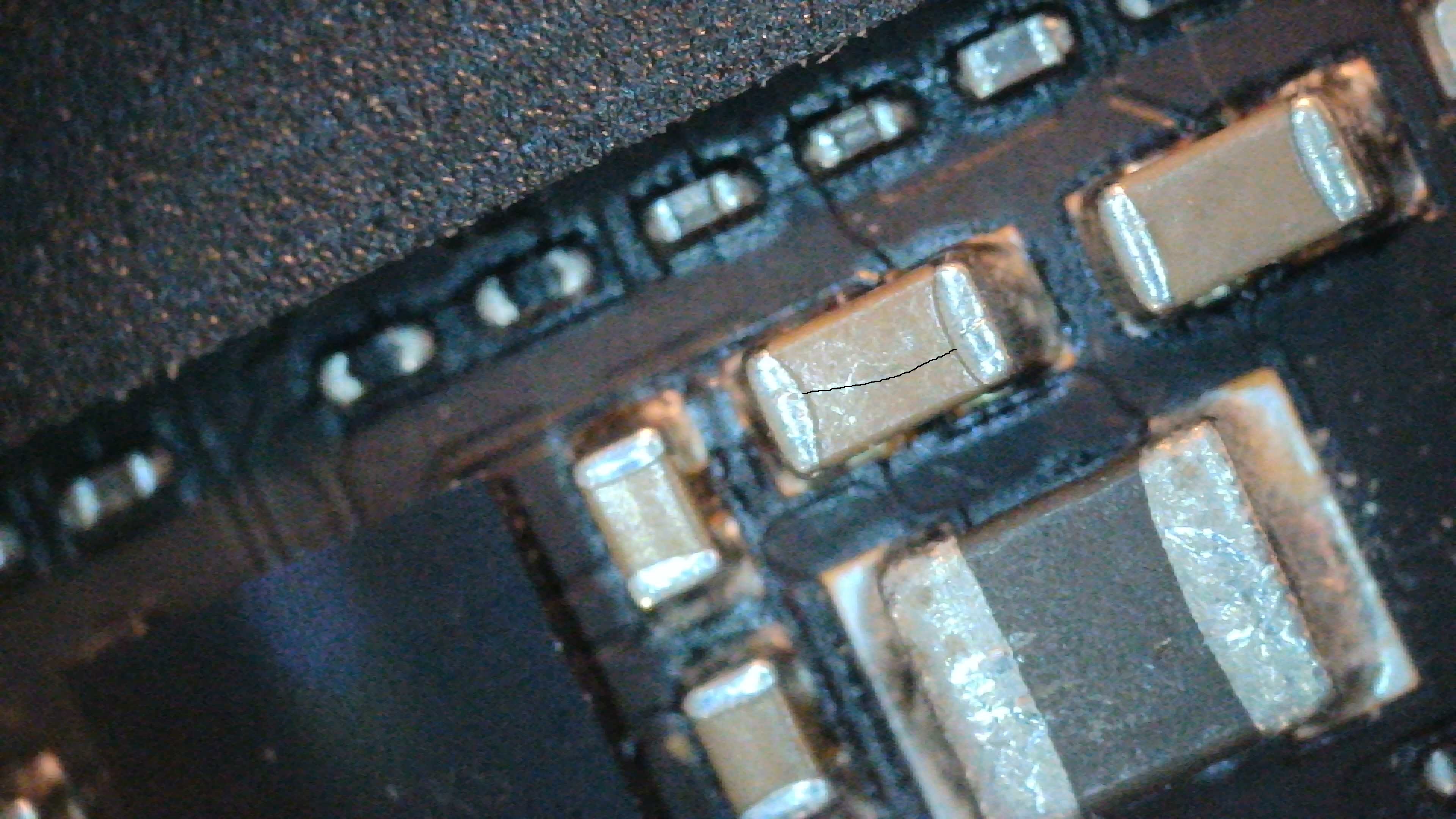

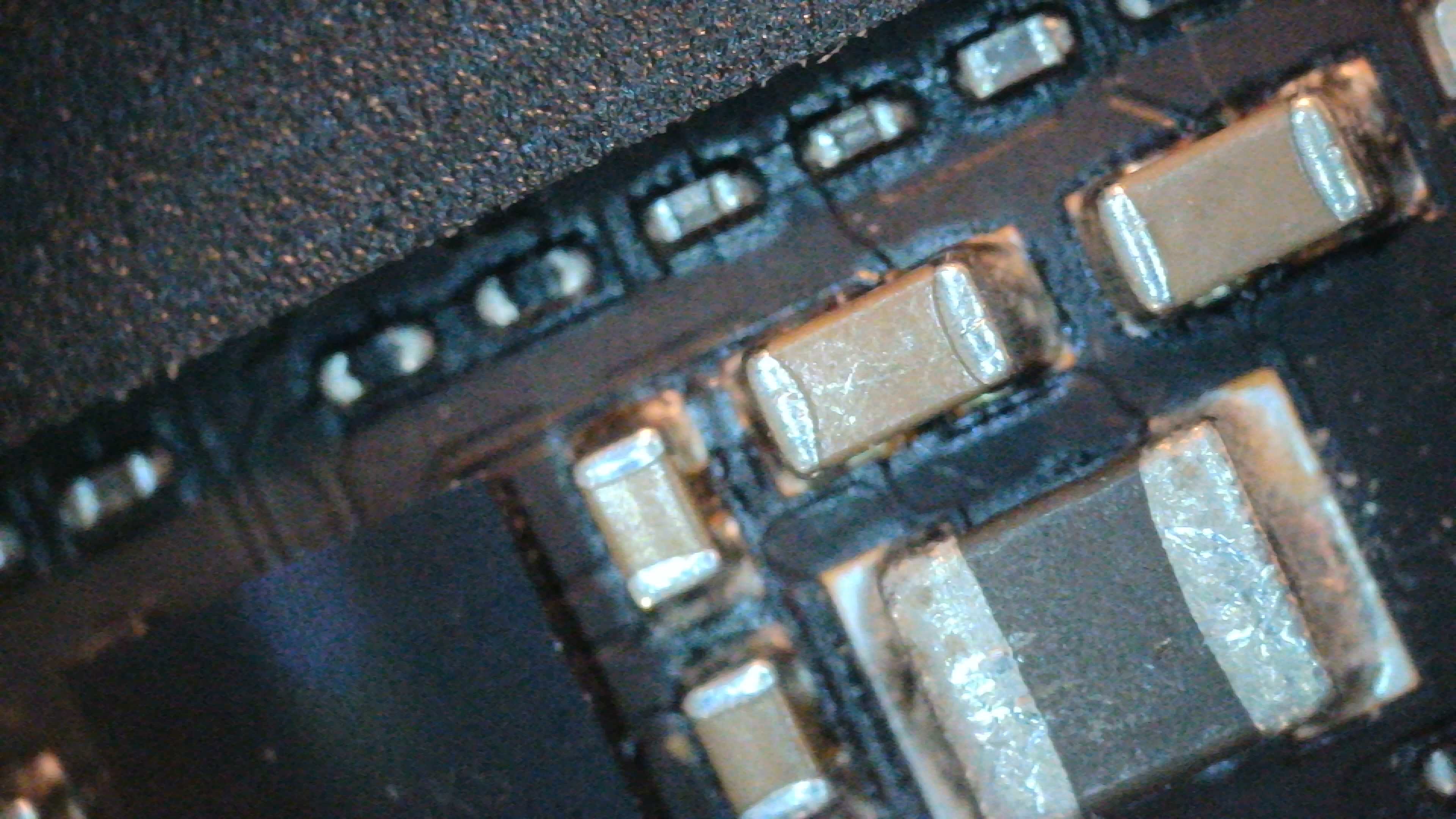

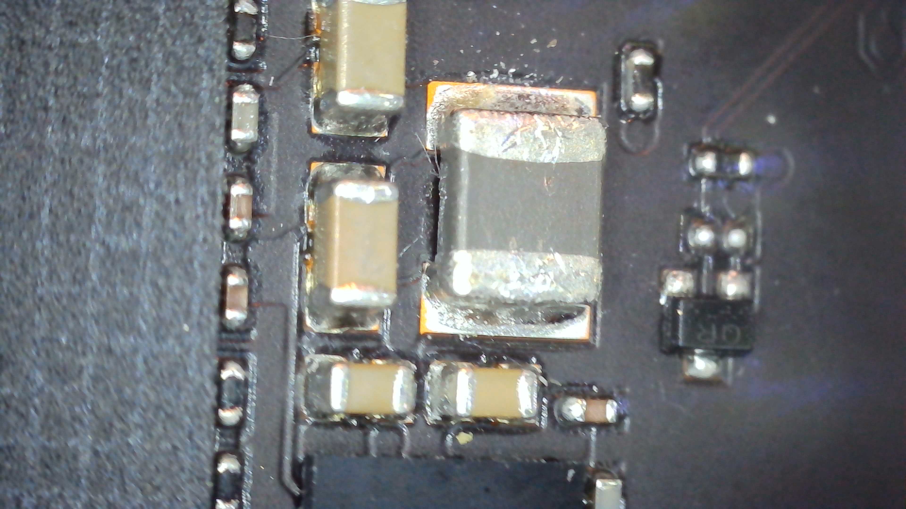

Anyway, I was looking at the cap next to V1, am I wrong or that tiny line could be a "crack" in it? I don't know if I'm just overlooking at it.
Tell my yours opinion please.
P.s. if you need the voltages i took put in the images to understand where are they, just tell me

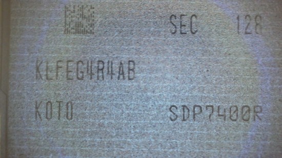

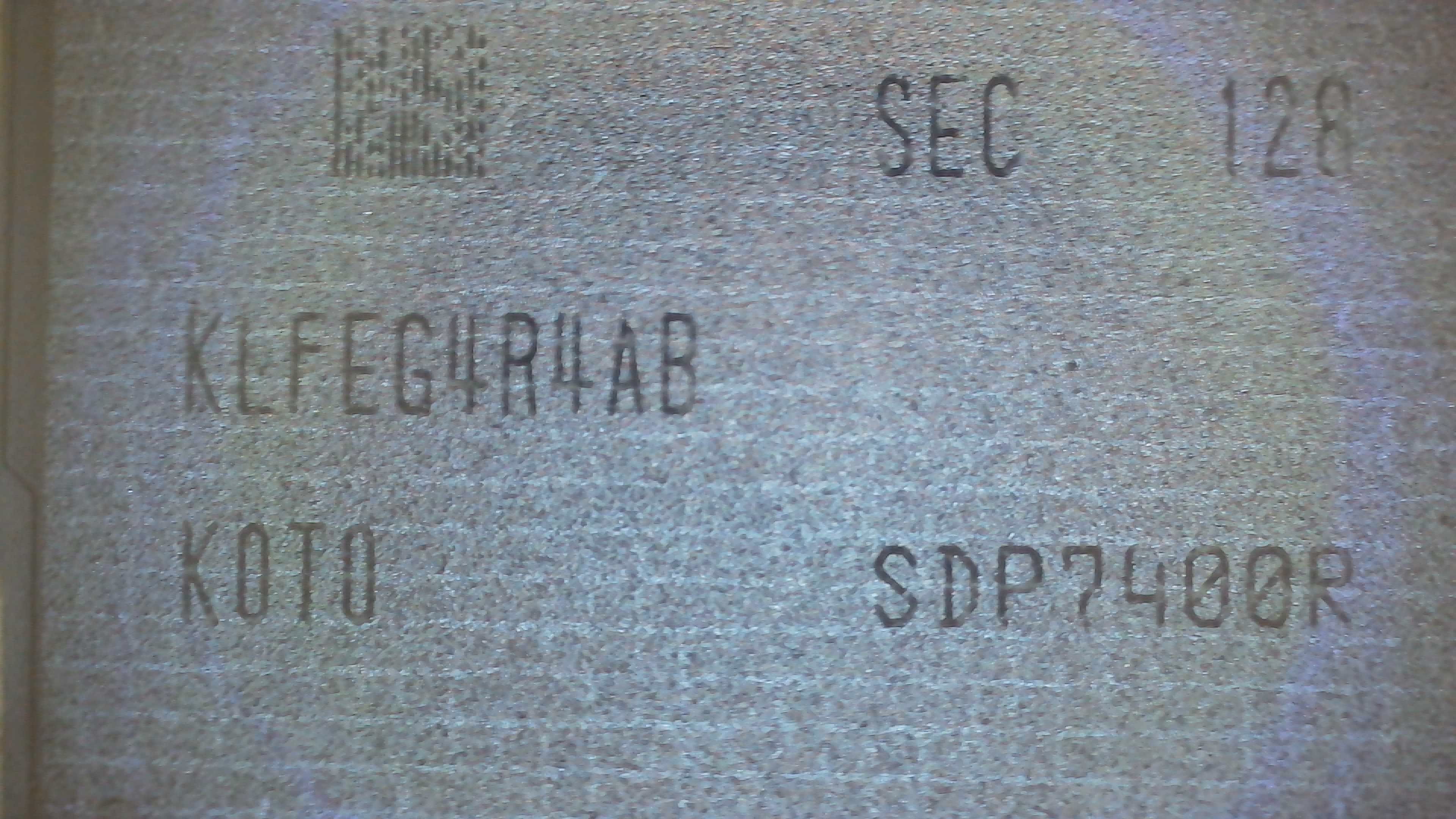

Is KLFEG4R4AB an SSD-on-a-Chip? Does it incorporate both the flash controller and NAND flash on a single IC?
I don't understand the V3 things, the voltage has suppose to be different?
Here the tensions from top to bottom
0,3 (each side)
0,3
0 each side
0,9
0,9
0,9
1,8 each
1,8 each
1,8
1,8
1,8
1,2
1,2
2,5
2,5
2,5
If you need that I put those into the image just tell me.
I also notice 2 things:
1) my adapter has a cable that one side has type C (the one goes into the adapter) and on the other side 2 USB A at Y config. The drive seeams to be powerd just with one of those, the blue one usb 3.0, with the other no power (withe one).

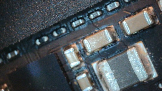

2) Is it just me or in the cap next to Inductor1 i see a little crack?

It does look like a crack on that MLCC. There are some hairline marks on the PCB, too. ??

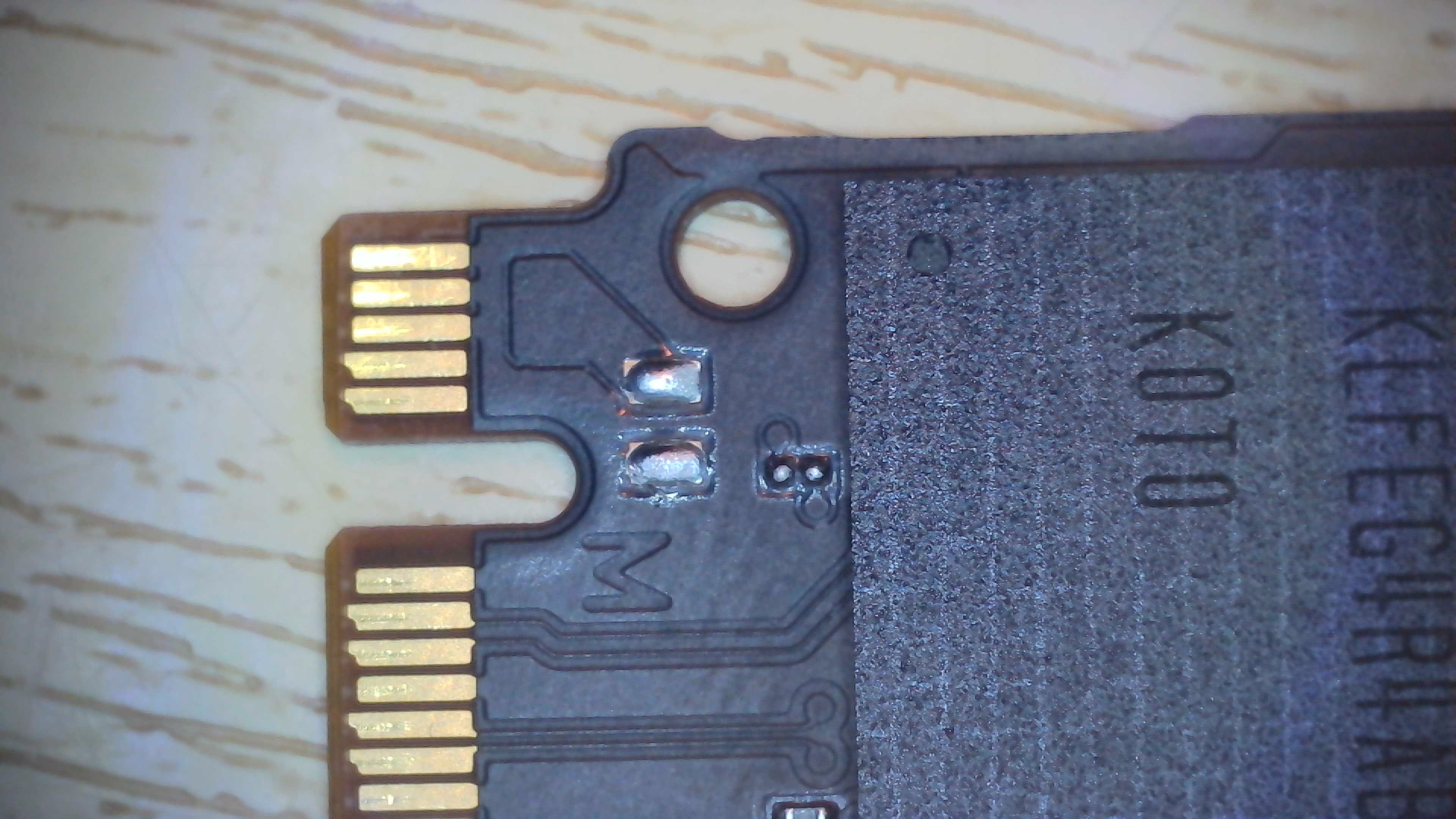

I don't know
I can try to remove it. Do I have to replace it?
For the voltage I wrote do you see something strange? Also the V1, the last message you told me something about it but I don't get it if the tension is wrong or not.

If there is only one large IC on the PCB, then it's an all-in-one package.
PostPosted: November 11th, 2025, 13:46
Joined: November 8th, 2025, 9:27
Posts: 9
Location: Italy

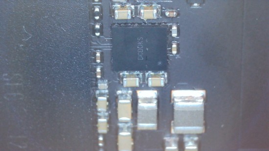

the other side of the board is empty.

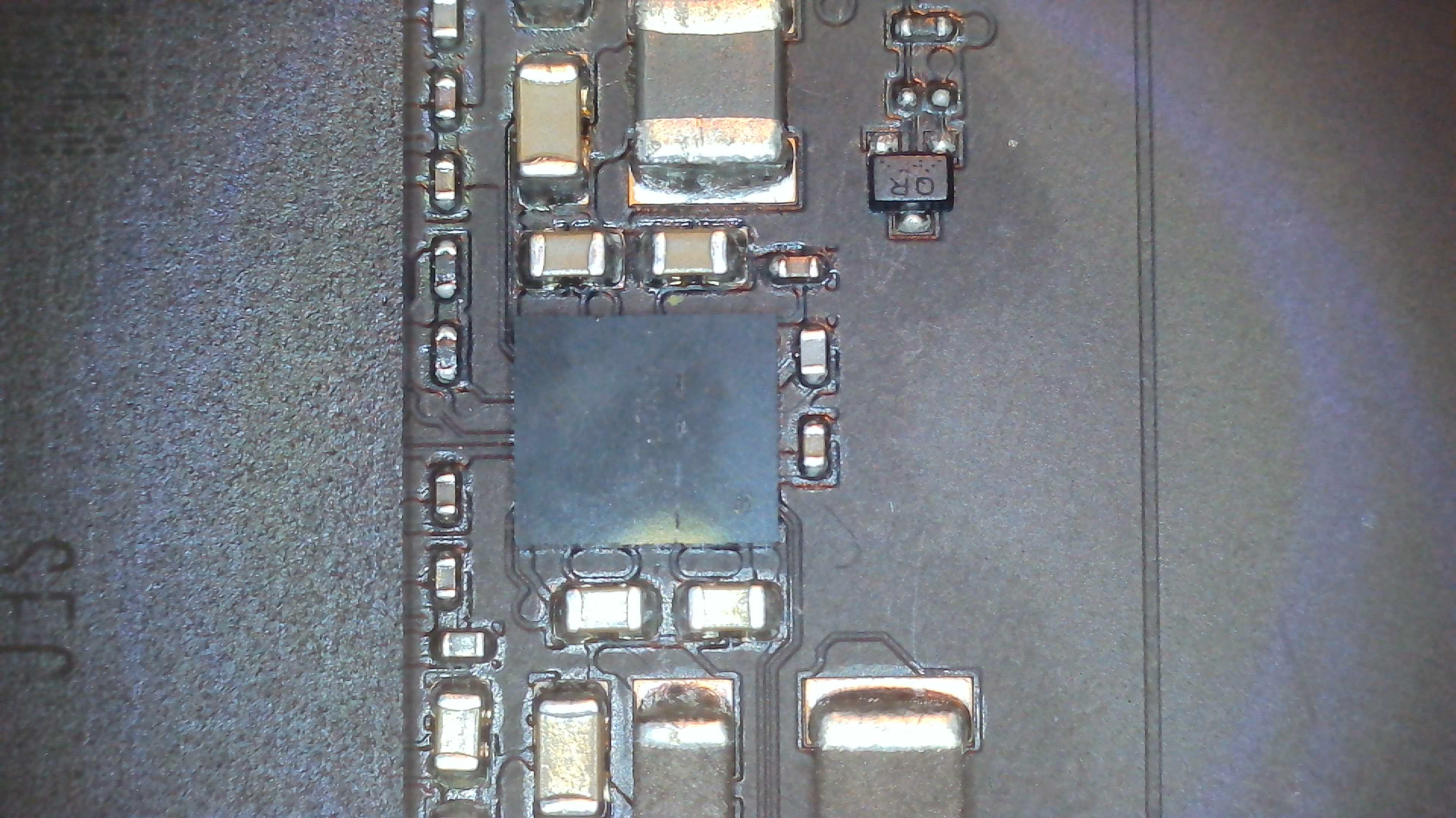

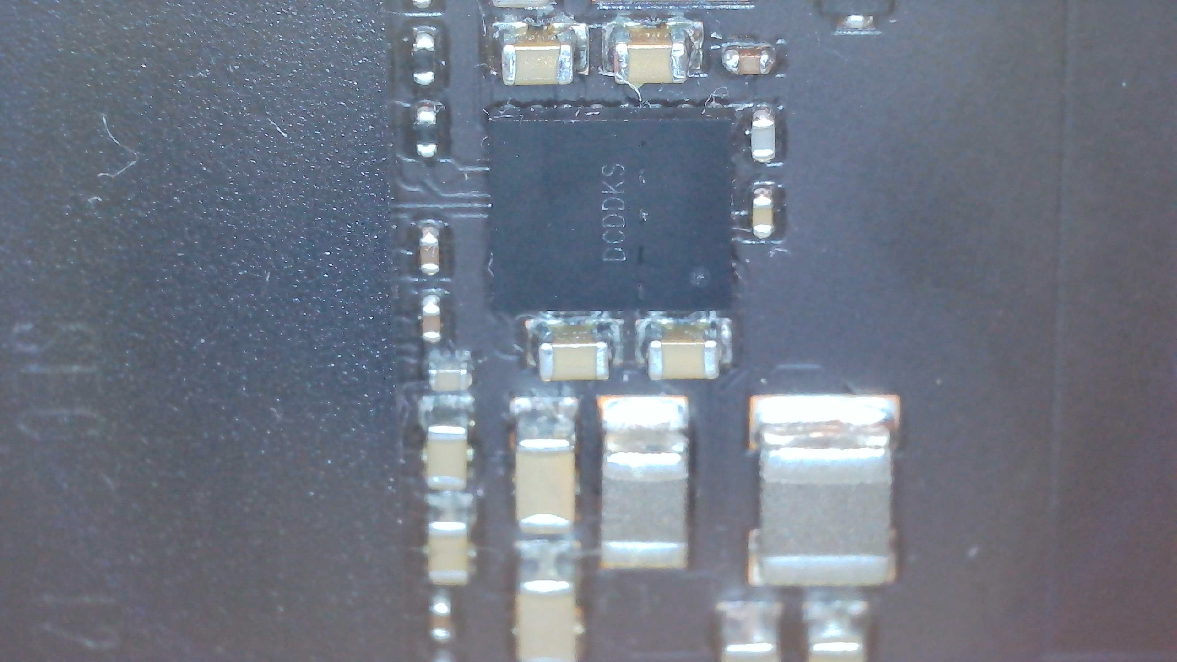

What about the black IC? Is it not the controller?

The DCDxyz IC is not a flash controller. It is a PMIC.
I can try to remove it and measure the resistence. If it is good i will have a OL, isn't it?
The black IC can't cause the problem?
And pls tell me what is wrong with the V3 :puke:
I remove that cap but it measure OL and the resistance on the board is like before.
So it's the nand or the controller. Isn't it?

Looking at the images I noticed some possible cracked caps which can lead to short circuits

PostPosted: March 19th, 2026, 20:18
Joined: March 19th, 2026, 19:59
Location: Romania
