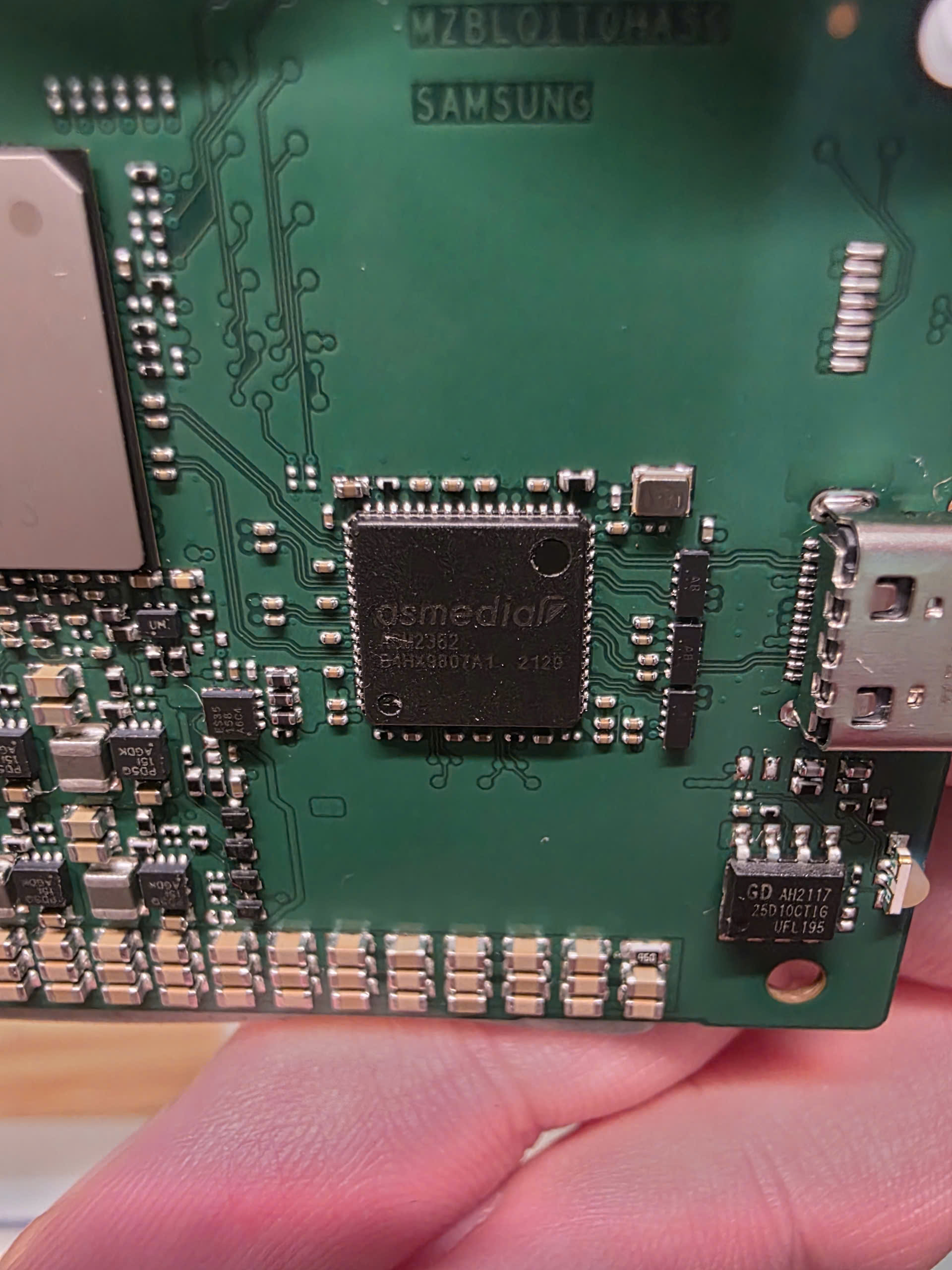

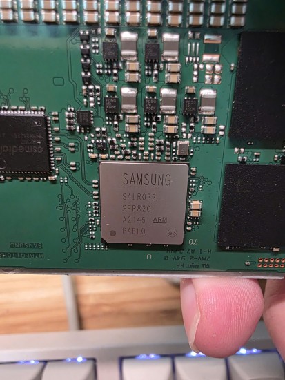

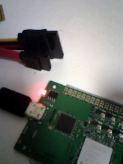

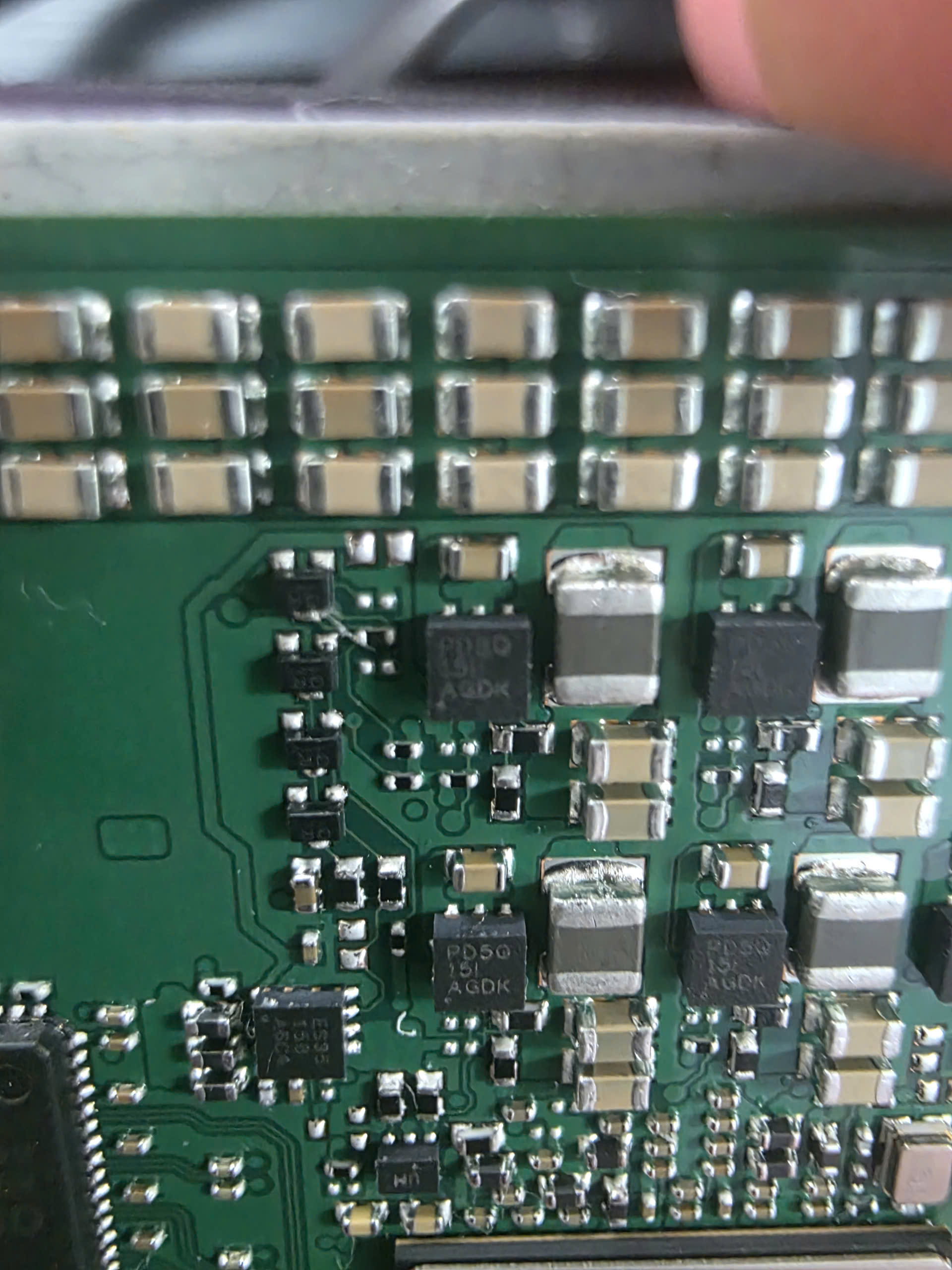

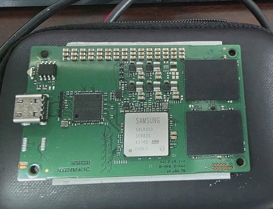

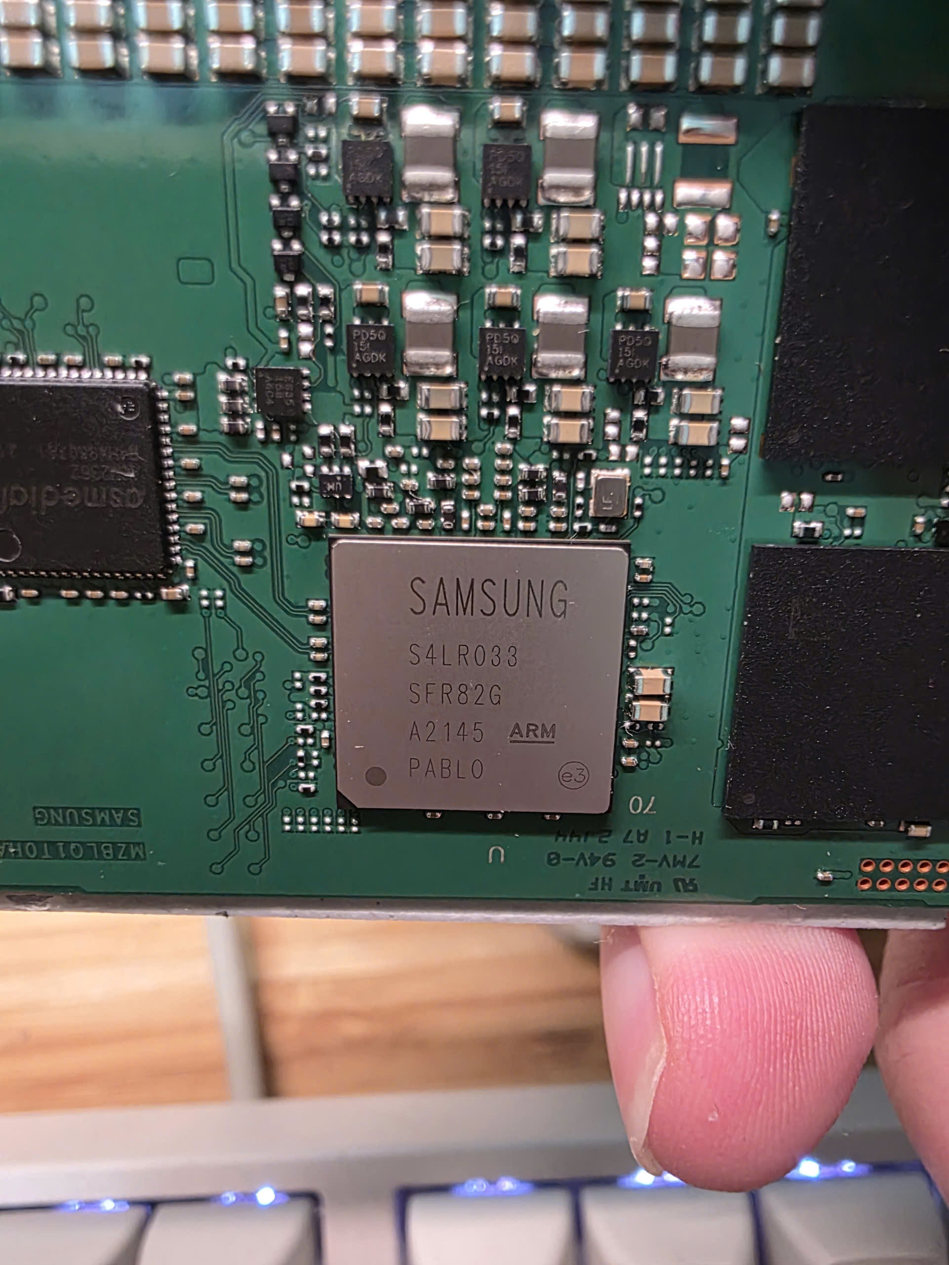

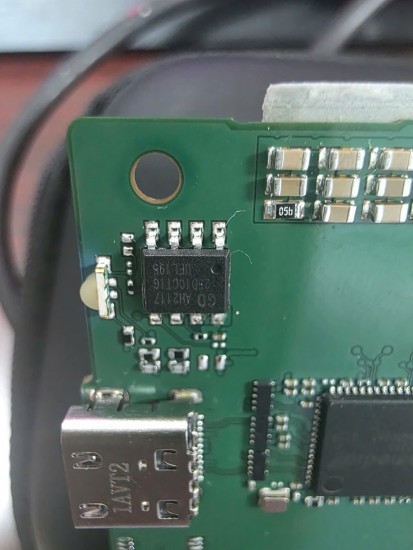

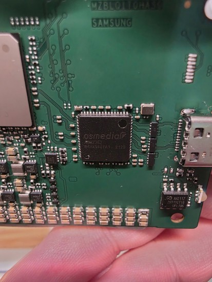

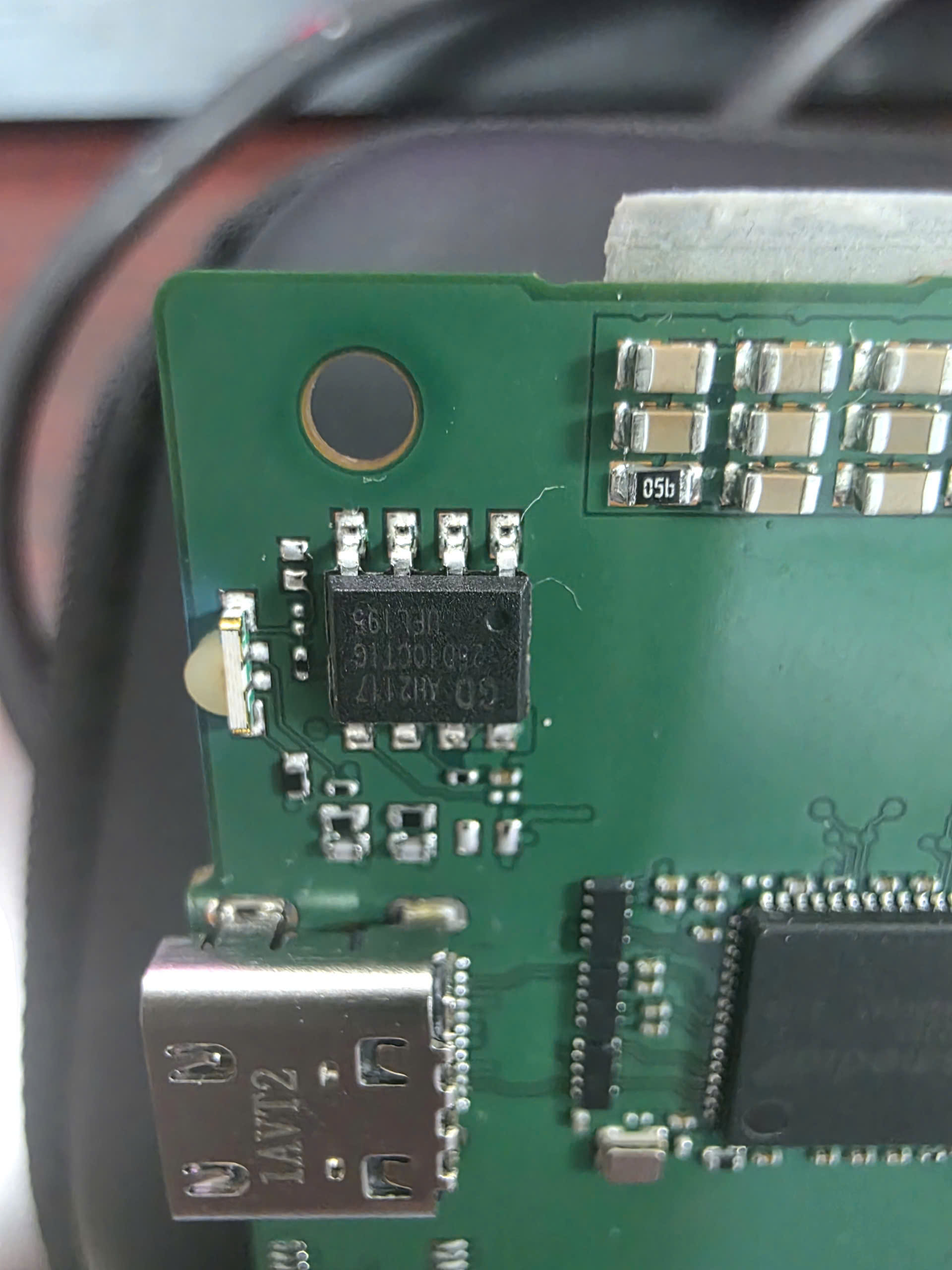

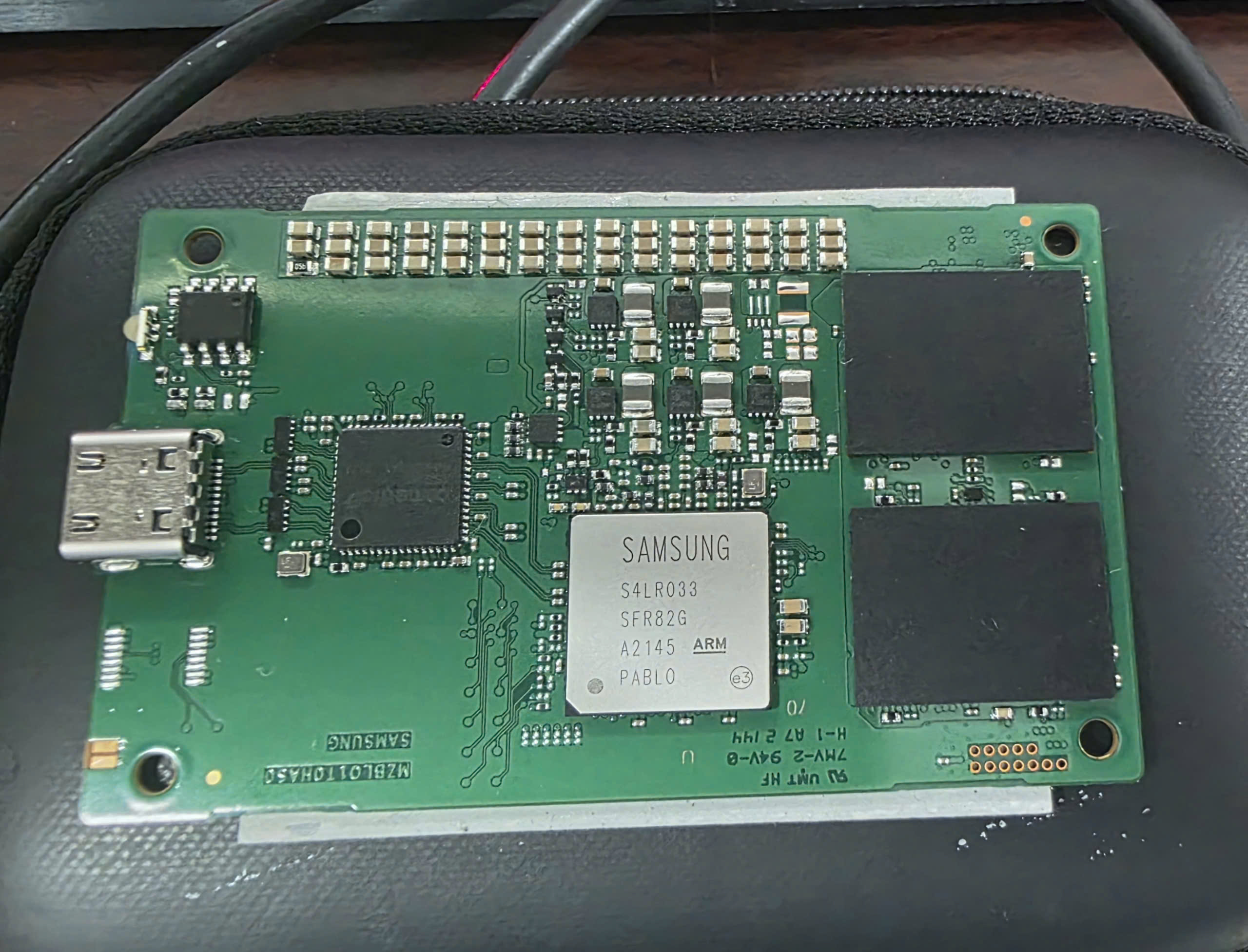

I have this T7 Samsung SSD. Upon plugging it in. It gives no power at all. What could the problem be?
I have checked all 5V shown like in this post
https://forum.hddguru.com/viewtopic.php?f=10&t=44979&p=314135&hilit=samsung+t7#p314135
all of them shows 0.0V
Maybe it is Type C connector or the Asmedia chip?
On type C pins all shows 0 as well, so no power goes through type C i think.
LED light not flashing or anything

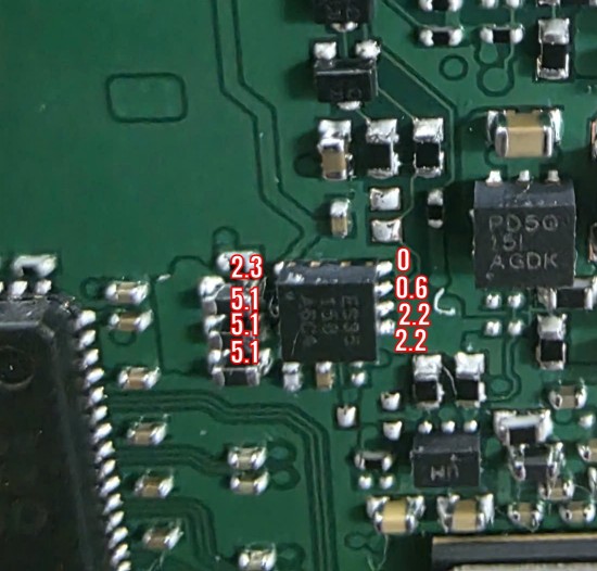

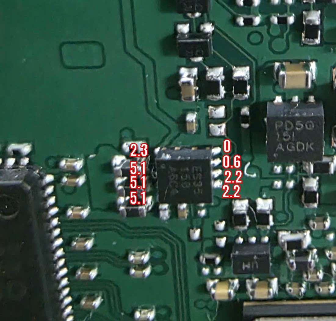

Check the input and output of ES35.
TPS259535, Texas Instruments, 2.7V - 18 V, 4A, 34-mΩ eFuse With Fast Overvoltage Protection, 5.7V clamp, marking ES35, WSON-8:
https://www.ti.com/lit/gpn/tps2595

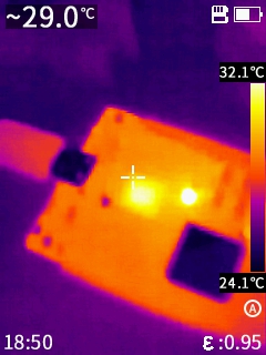

The drive today upon turning on did turn on for a split second then turned off
Here is the heat signature of the drive at that exact moment
here is what i got on in out of ES35

If you read this and compare it with the measurements - ES35 is dead.
(5.1-2.2)/0.034 = 85,3A! :lol:

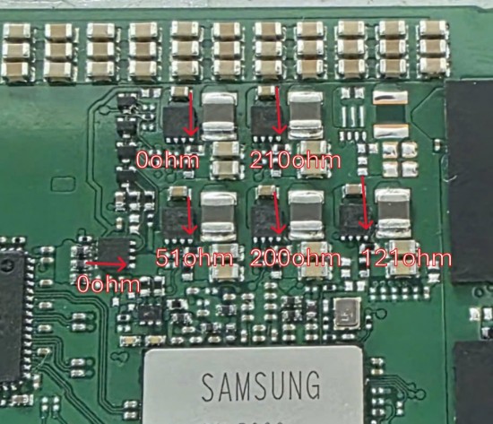

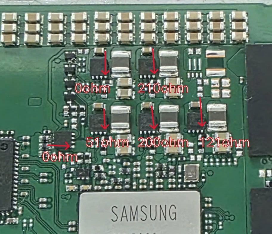

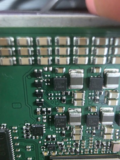

The five "PD5Q" buck regulators have an undervoltage lockout threshold (VUVLO) of 2.2V. I'm wondering whether one of the loads is drawing too much current and causing the ES25 e-fuse to enter current limiting mode. VUVLO would be the equilibrium point. Above this point, the PD5Q ICs start to draw current. Below this point, those ICs switch off.
I would measure the resistance between pin#5 of ES35 and Ground. I would also measure the resistances between Ground and each of the PD5Q outputs.
TPS62085, Texas Instruments, adjustable 3A Step-Down Converter with DCS-Control and Hiccup Short Circuit Protection, 2x2 HotRod Package, marking PD5Q, 7-pin:
https://www.ti.com/lit/ds/symlink/tps62085.pdf

Here are the resistances

I don't understand how you can be seeing 0 ohms at ES35, but it appears that the top left PD5Q converter has a shorted load. Hopefully this is due to a shorted capacitor rather than a major IC.

So the problem was the ES35 chip. I swapped it out. And the drive powered on

Why were you measuring 0 ohms at the output of the 3.3V regulator? And how is it possible to measure 2.2V at the output of ES35 when the resistance is 0 ohm?
So it must be somekind of locking mechanism when power is not stable or something.
After changing the es35. The resistance only came back to es35. All pd5q still off. After 3-4 times plugging and unplugging the drive. Each pd5q came back to normall and the whole drive worked like a charm
I wonder whether there really was anything wrong with ES35. Instead, it could be that there was a shorted capacitor at the output of the PD5Q 3.3V regulator. Repeated plugging and unplugging may have blown open the short.
