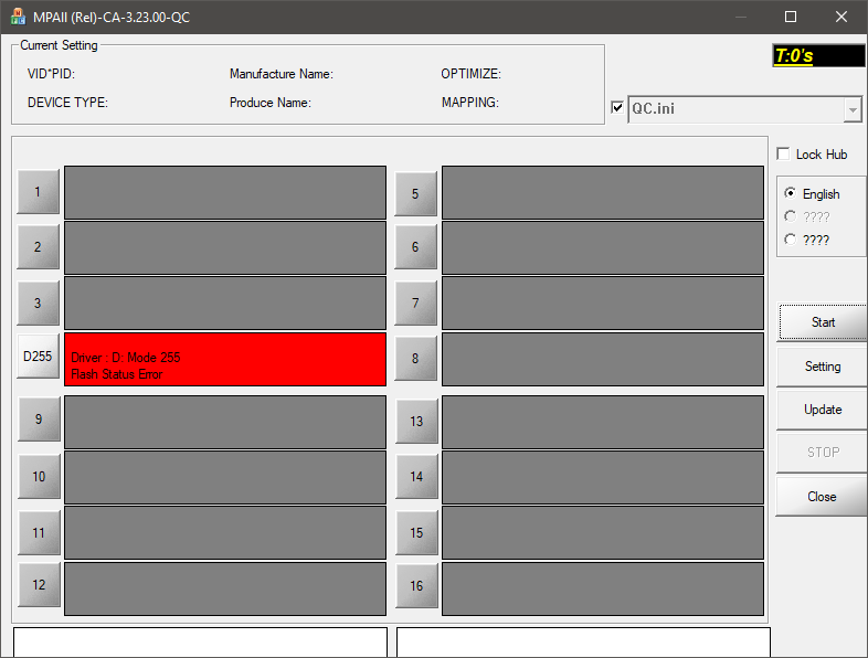

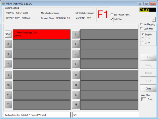

I have a Silicon Power flash drive:
Device Name: 2261 PRAM
Device Revision: 0110
Product Model: 2261 PRAM
Product Revision: 1.00
Controller Vendor: Phison
Controller Part-Number: PS2251-61(PS2261) - F/W 01.01.10 [2011-01-26]
Flash ID code:      98D798927256 - Toshiba TC58NVG5T2HTA00 [TLC-8K]
Tools on web:       http://dl.mydigit.net/special/up/phison.html
I want to fix it and when I connect the two controller pins together the following message is displayed:
Any idea welcomed!
Thank you.

Factory utilities may not work on Windows 8-10-11.

hack3rcon, I forgot to ask the most important thing: do you remove the jumper after connecting? Before defining ("Update") it in the program.
 Post subject: Re: Driver : D: Mode 225
PostPosted: February 10th, 2026, 2:33
Posts: 347
Location: Eastern Europe
p.s. We put a jumper - connect to the computer - remove the jumper.
Yes. I did.

hack3rcon wrote:
Hello, I use Windows 10. Should I use Windows 7?
I can't say anything. I repair flash drives on Windows 7 x32. I haven't tried them on 8-11.
But that's what they sometimes say on forums...

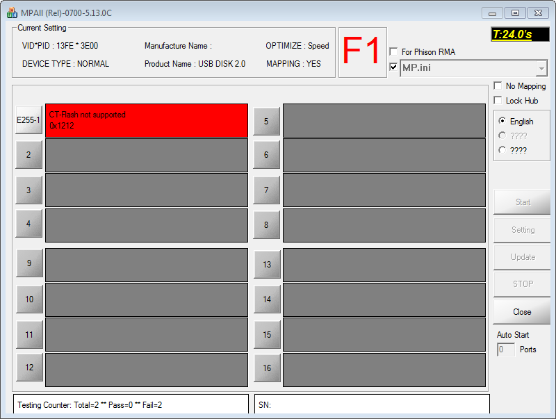

PostPosted: February 14th, 2026, 2:15
Joined: September 24th, 2014, 15:11
Posts: 195
Location: on the space
SWM wrote:
Thank you.
I followed the same steps on Windows 7 and got the following error:

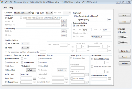

PostPosted: February 14th, 2026, 6:09
Posts: 347
Setting -> Partition Setting -> Mode 3
PostPosted: February 15th, 2026, 1:49
Posts: 195
I did:
But I got the same error.

Unfortunately, I have nothing more to offer you. Especially if the drive is physically faulty...

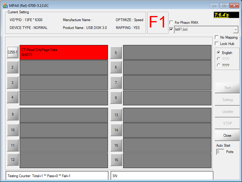

PostPosted: April 13th, 2026, 0:45
Posts: 195

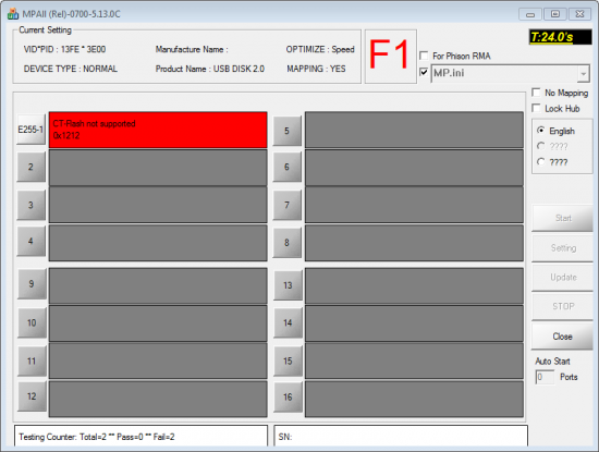

I selected BN61V118M.BIN as Burner file and FW61FF01V30953M.BIN as Firmware file, but I got:
Any idea?
