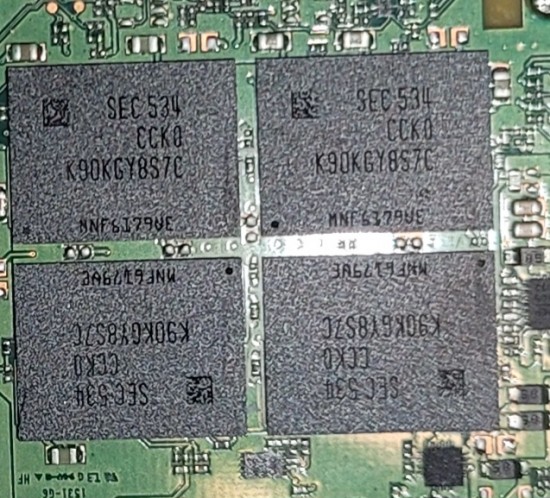

Have you identified the capacity of each NAND IC?

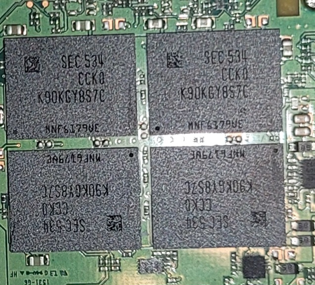

Thank you for the information. The flash chips are K90KGY8S7C. From what I read they are 128GB each. There are 8 of them, explaining the 960 GB capacity of the SSD.
Why would the model have 1T9 then?

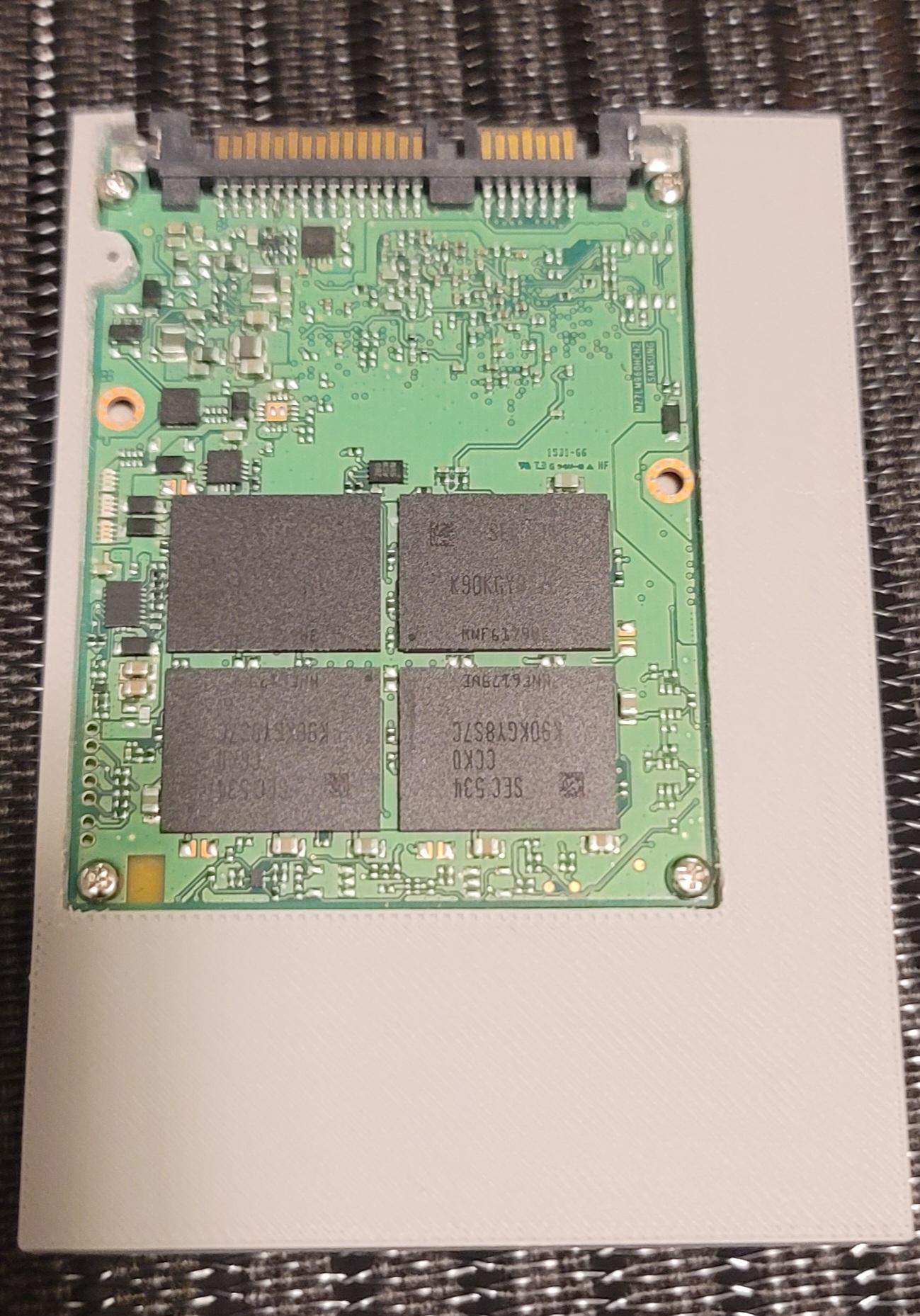

Perhaps someone swapped the PCB?
Can you show us detailed photos of the PCB and the label side of the case? I would like to compare the date codes on the ICs against the manufacture date on the label.

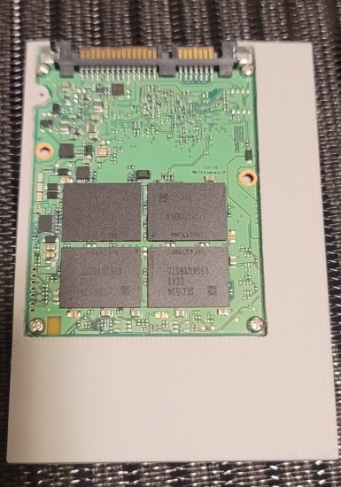

I don't have the case, just the board. The model number is what it reports to the computer. The flash chips have dates 531 and 534. It may have come from some server environment, maybe part of some storage system.
