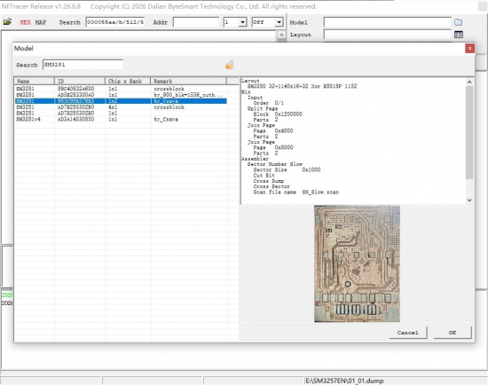

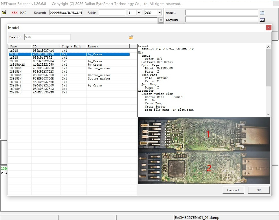

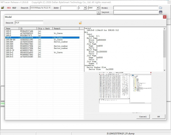

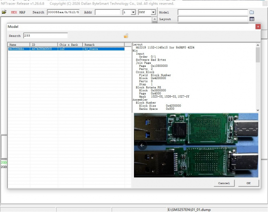

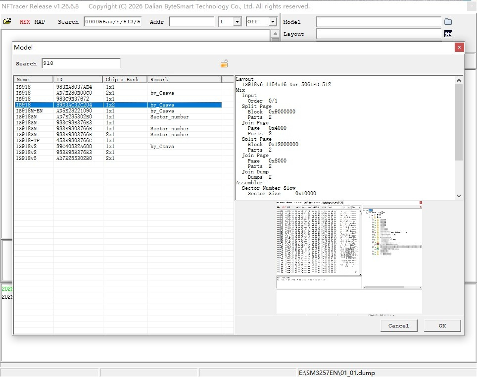

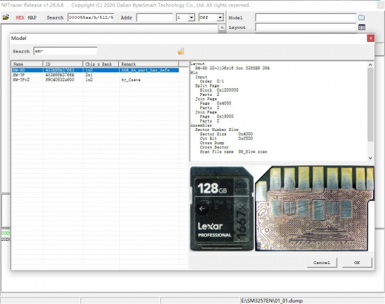

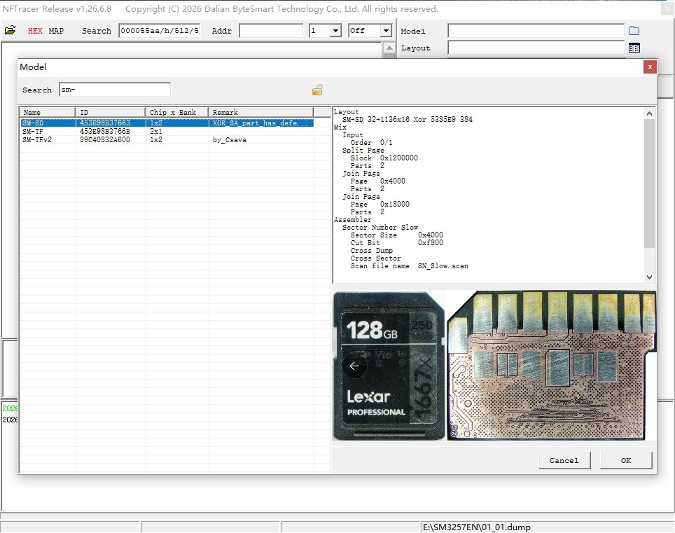

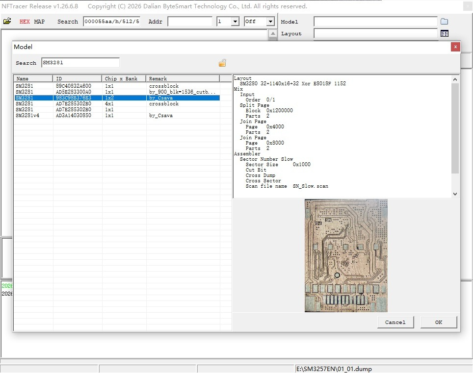

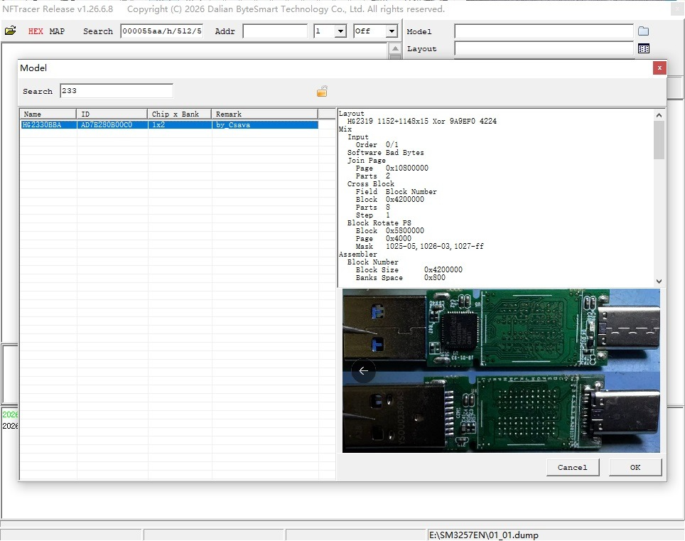

When performing data reorganization on the AU89103 chip and subsequent sector sorting, nearly half of the files and directories failed to be parsed correctly.
After investigation, we confirmed that BANK differentiation is required during the sorting process.
Since many similar chips have the same issue, we have added multi-BANK analysis to the sector sorting module of NFT to resolve this problem.
