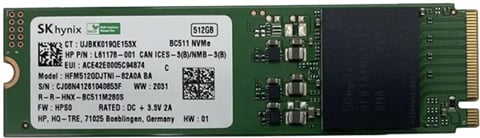

What voltages do you measure at the 3 inductors to the left of the main IC?
https://au.static.webuy.com/product_images/Computing/Solid%20State%20Drives%20-%20NVMe/SSSDHKHHFM512GDJTNIA_l.jpg
https://notebookparts.com/cdn/shop/products/HFM512GDJTNG-8310A_L15195-002__51069.1612982947.1280.1280.jpg

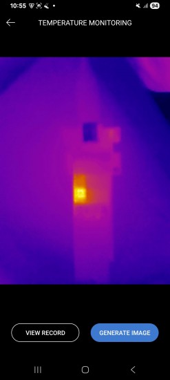

On 3 inductors (those near voltage regulators) I measured:
1,8V
0,896V
2,56V
From the last value I guess there is a short somewhere

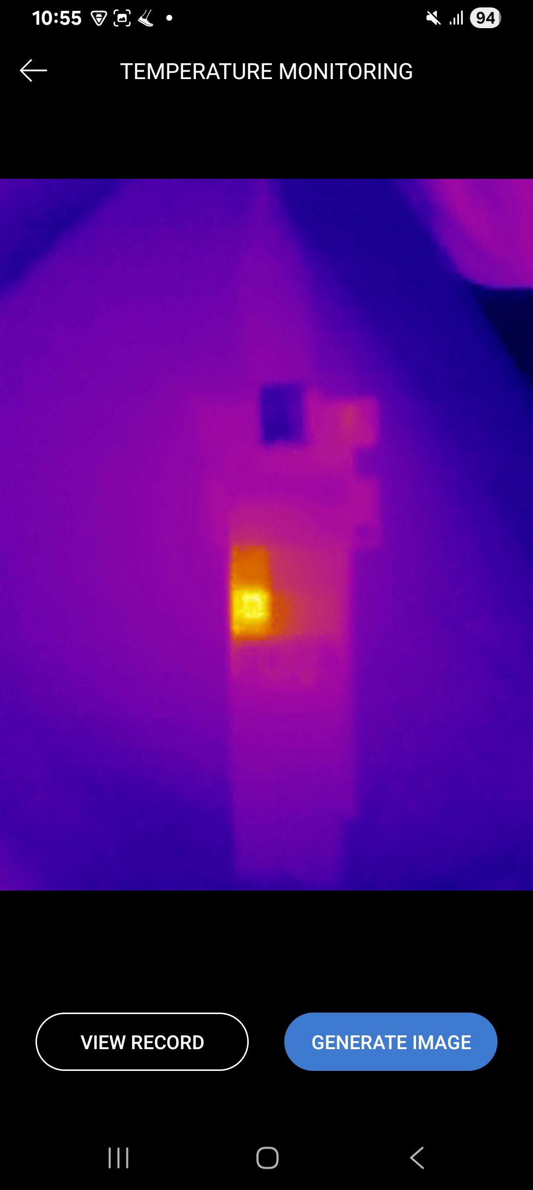

I also enclosed a picture taken with infra camera. As you can see there is a short in ( or below ) UFS memory.
Do you think reballing could help?
Or any other solutions?
Thanks for reply

They all seem OK to me.

John1 wrote:
2,56V
No, this is the correct value.
No, the drive is electronically functional. The controller heats up, but within normal operating ranges.
Everything points to firmware corruption. The only options are to heat/cool the NAND flash drive.
For me too.
 Post subject: Re: HFM512 GDJTNI-82A0A problem

But 2.56V seems to me low. Normally, there should be about 3.3V. Or not?
Besides if you check the infrared picture in details, you will see the memory is not warm in all parts the same but only one part is more hot. So from that, I guess, there is an internal short. Or can you please explain why I am wrong?
Can you explain more? Thanks
The correct power supply for this memory is between 2.6 and 2.8V.
Only the controller heats up, not the entire system, because programming has cut off access to the memory, and therefore its full initialization.
Part 5 and 6:
https://blog.acelab.eu.com/methods-of-d ... ction.html
