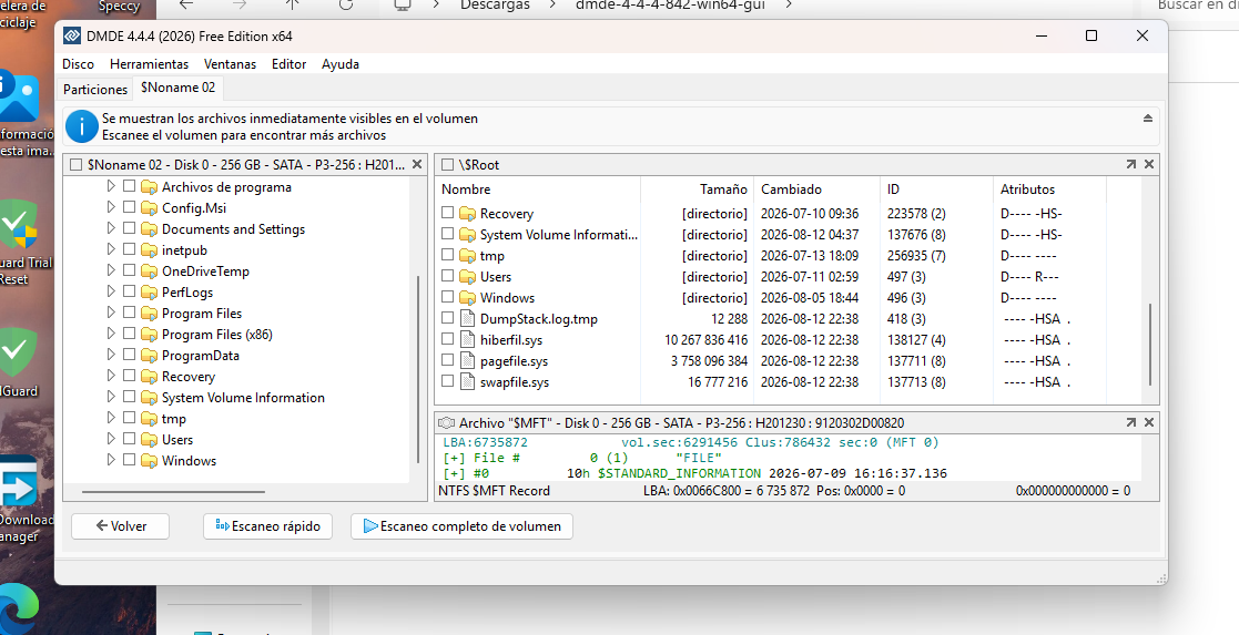

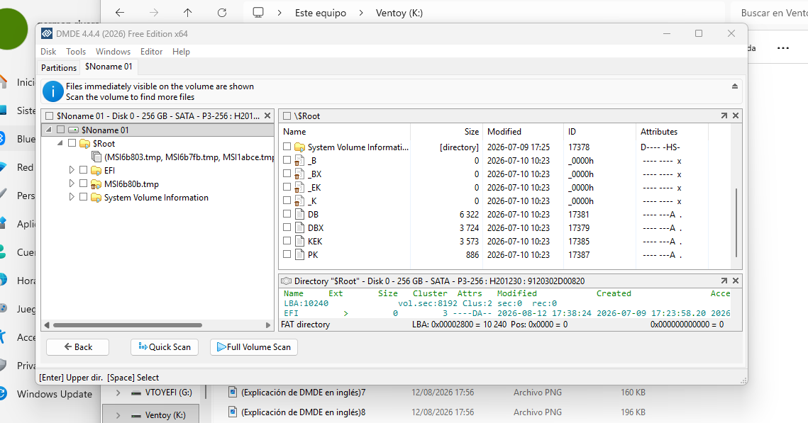

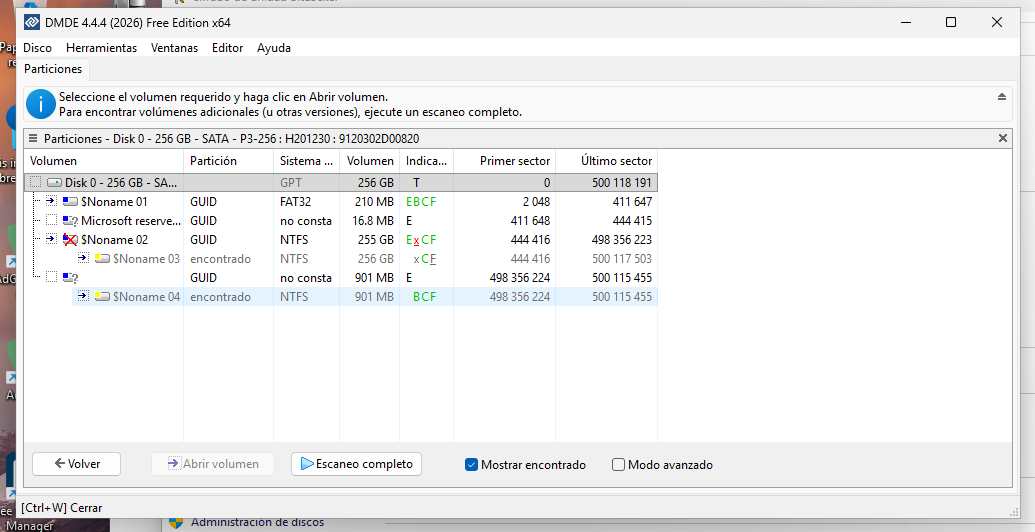

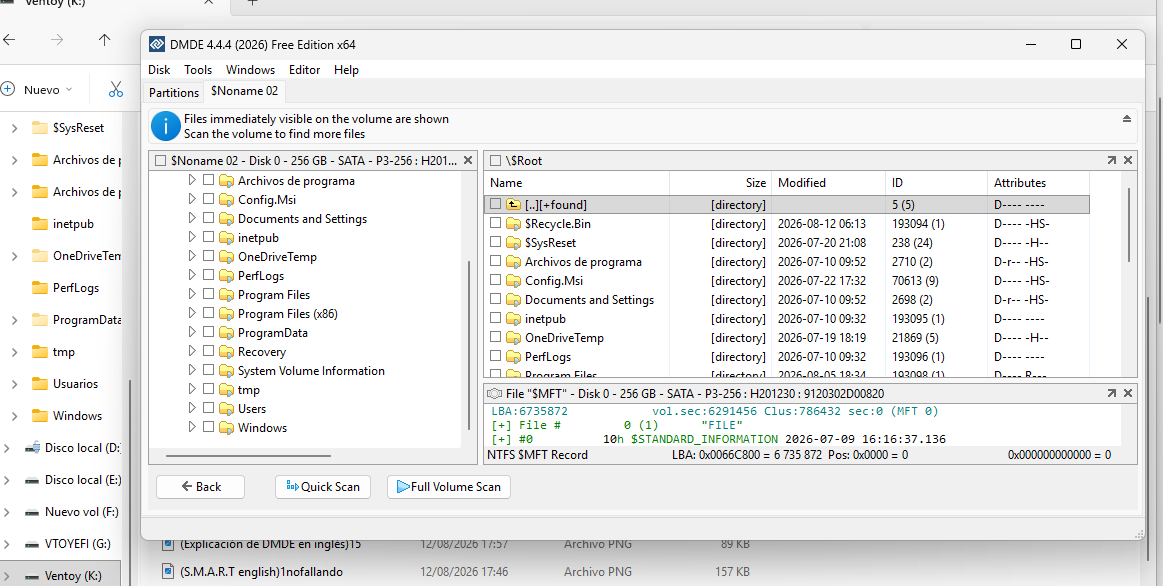

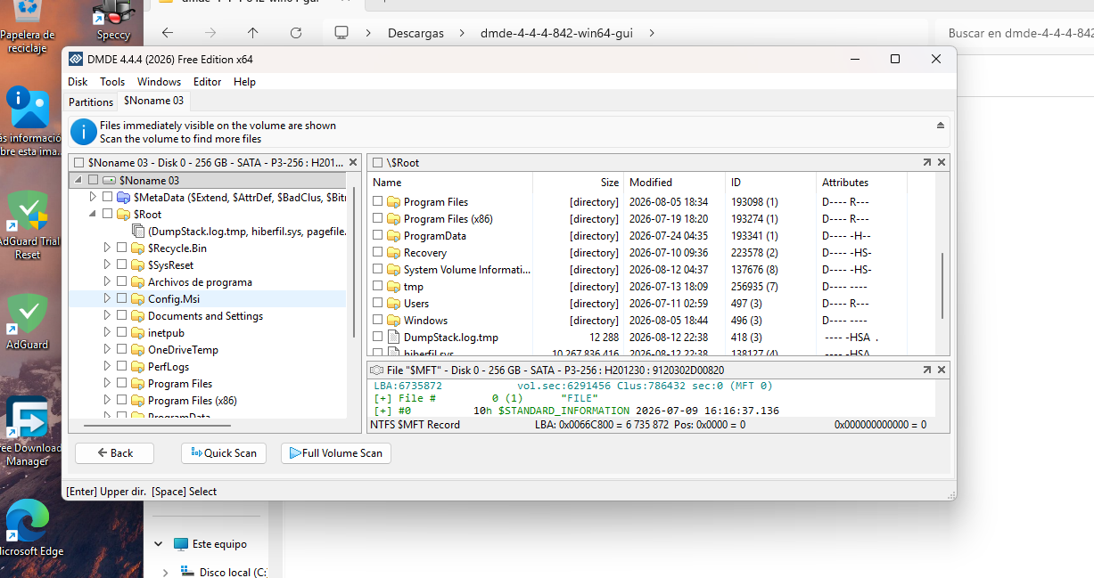

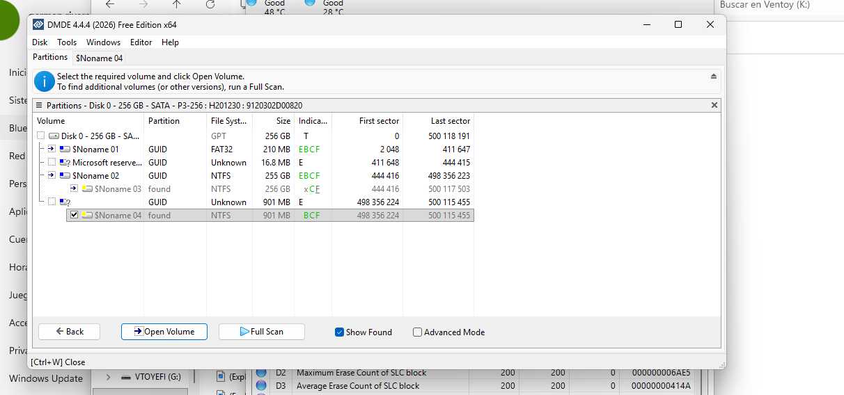

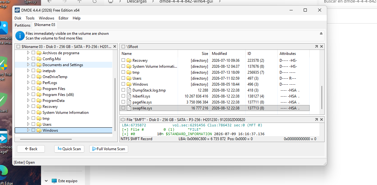

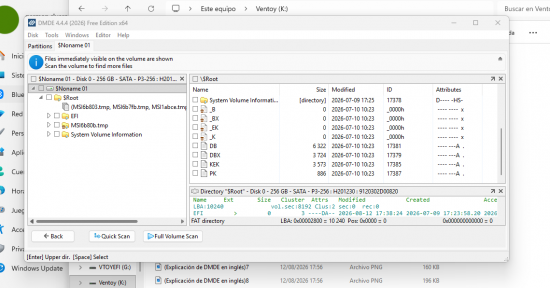

Your DMDE screenshot does not show a RAID. It is showing a 256GB drive with several partitions that span a single 256GB drive, not a 2 x 256GB RAID 0.
D-click the $Noname partitions and expand the $Root. You should see a file/folder tree under each.
 Post subject: Re: How to fix the SSD of the body of this thread using RAID
PostPosted: August 12th, 2026, 4:21
Posts: 172

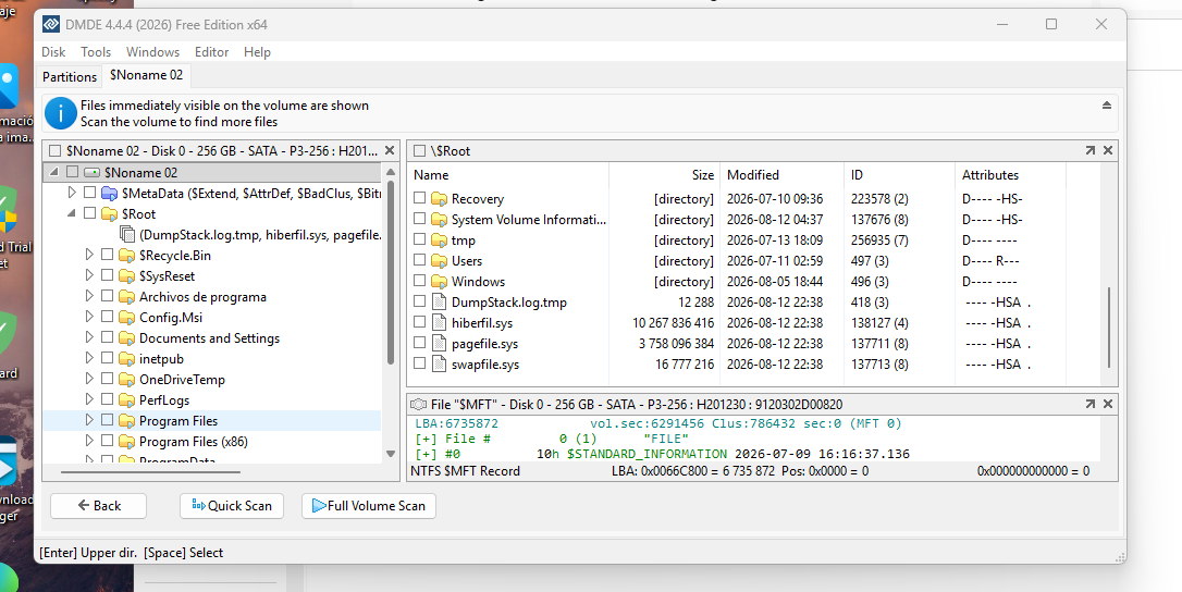

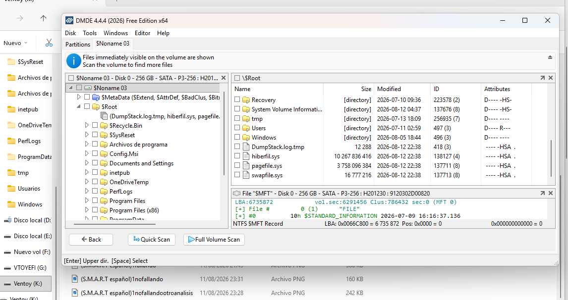

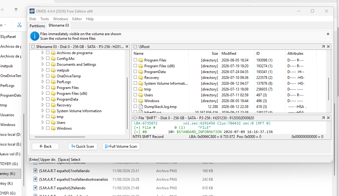

As fzabkar writes, the DMDE configuration doesn't contain information about any RAID array, the NTFS partition itself is damaged.
But before you begin data recovery, make a binary copy of this drive in case it suffers more serious damage.

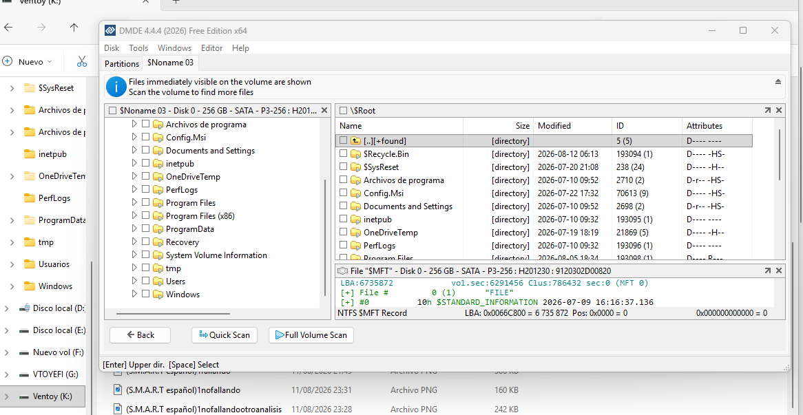

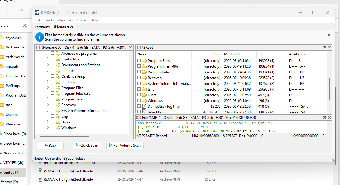

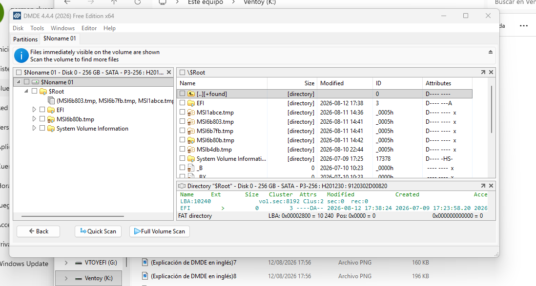

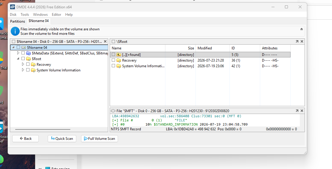

I will attach what is shown after double-clicking the $Noname partitions and expanding $Root, showing the folders\files under each one in chronological order, from the screenshot that appears higher up to the one that appears lower down, across this and the following comment, in chronological order from the first to the last of those two comments.

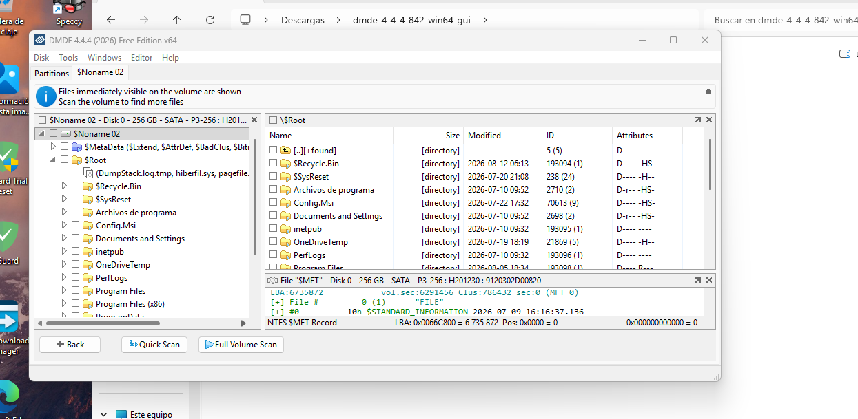

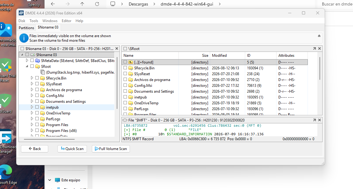

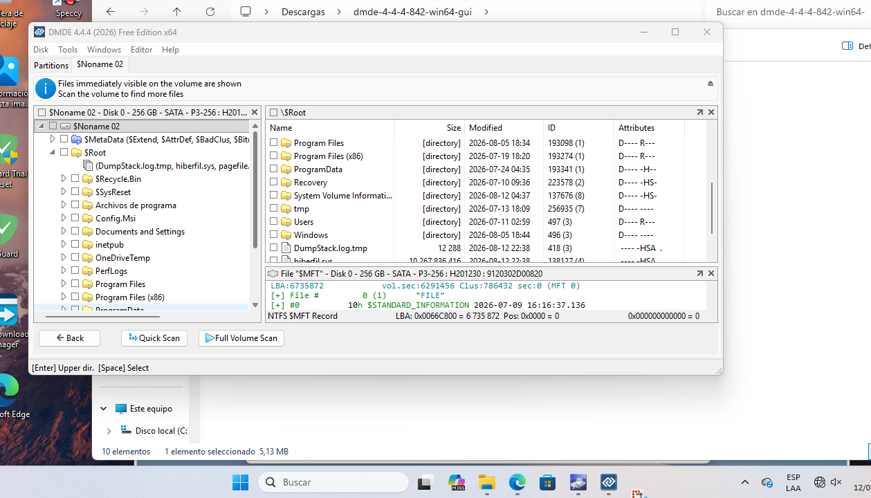

This is the second part of what is shown after double-clicking the $Noname partitions and expanding $Root, showing the folders/files under each one. After configuring the RAID mode, I removed the HDD I had installed and configured the RAID mode alongside the SSD I mentioned there (the one I want to repair and am asking you how to repair). I then connected another HDD, installed Windows on it, and afterward connected the previously mentioned SSD. In the BIOS/UEFI, under Advanced → PCH Storage Configuration → SATA Mode Selection, it was set to AHCI, after previously having been configured as Intel RST Premium With Intel Optane System Acceleration (RAID). I had only installed and configured RAID mode with the penultimate-mentioned HDD and the previously mentioned SSD.

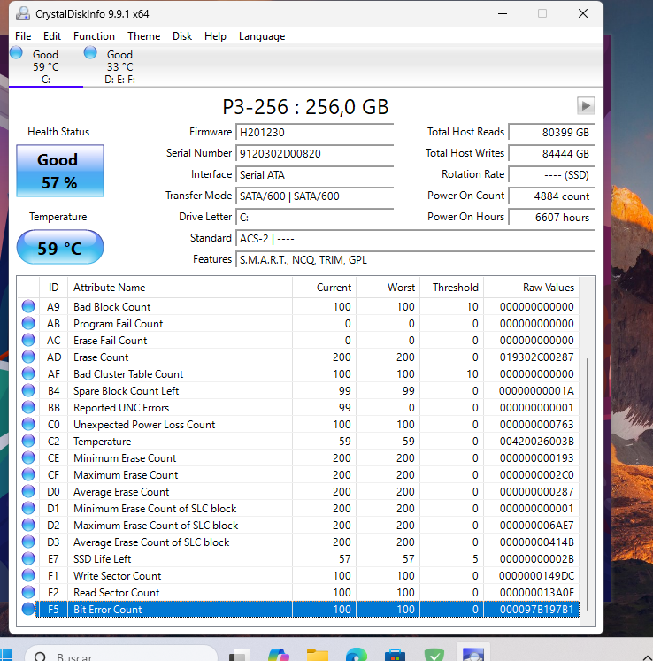

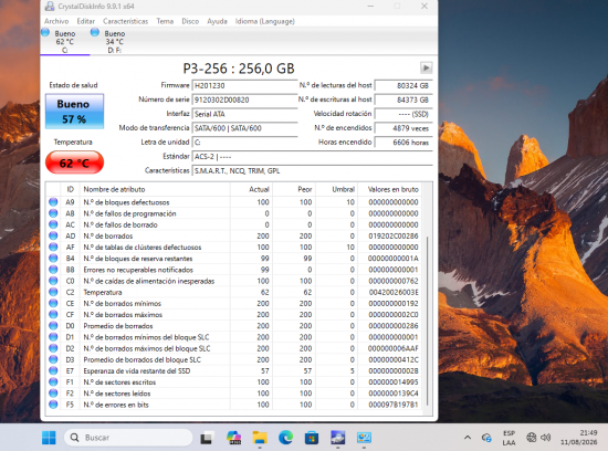

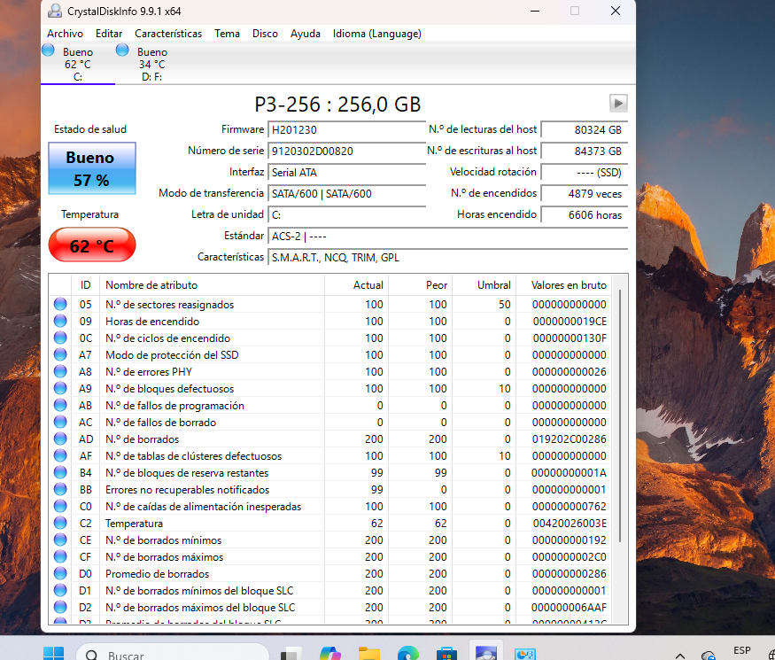

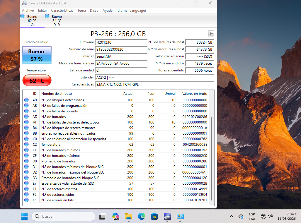

There is the S.M.A.R.T. result for the previously mentioned SSD attached in chronological order, from the screenshot that appears higher up to the one that appears lower down.
PostPosted: August 12th, 2026, 19:20
Joined: August 10th, 2026, 18:07
Posts: 31
Location: Miami
The current temperature in my last two attached pictures was taken at the last available time.

The partition screen looks like the one shown in the attached English image in DMDE.
(Así luce la pantalla de partición en DMDE inglés).png [ 78.98 KiB | Viewed 12728 times ]

If this were an Optane configuration, you wouldn't be able to see the data structure on a single drive. Is your profile and data in the User directory?
