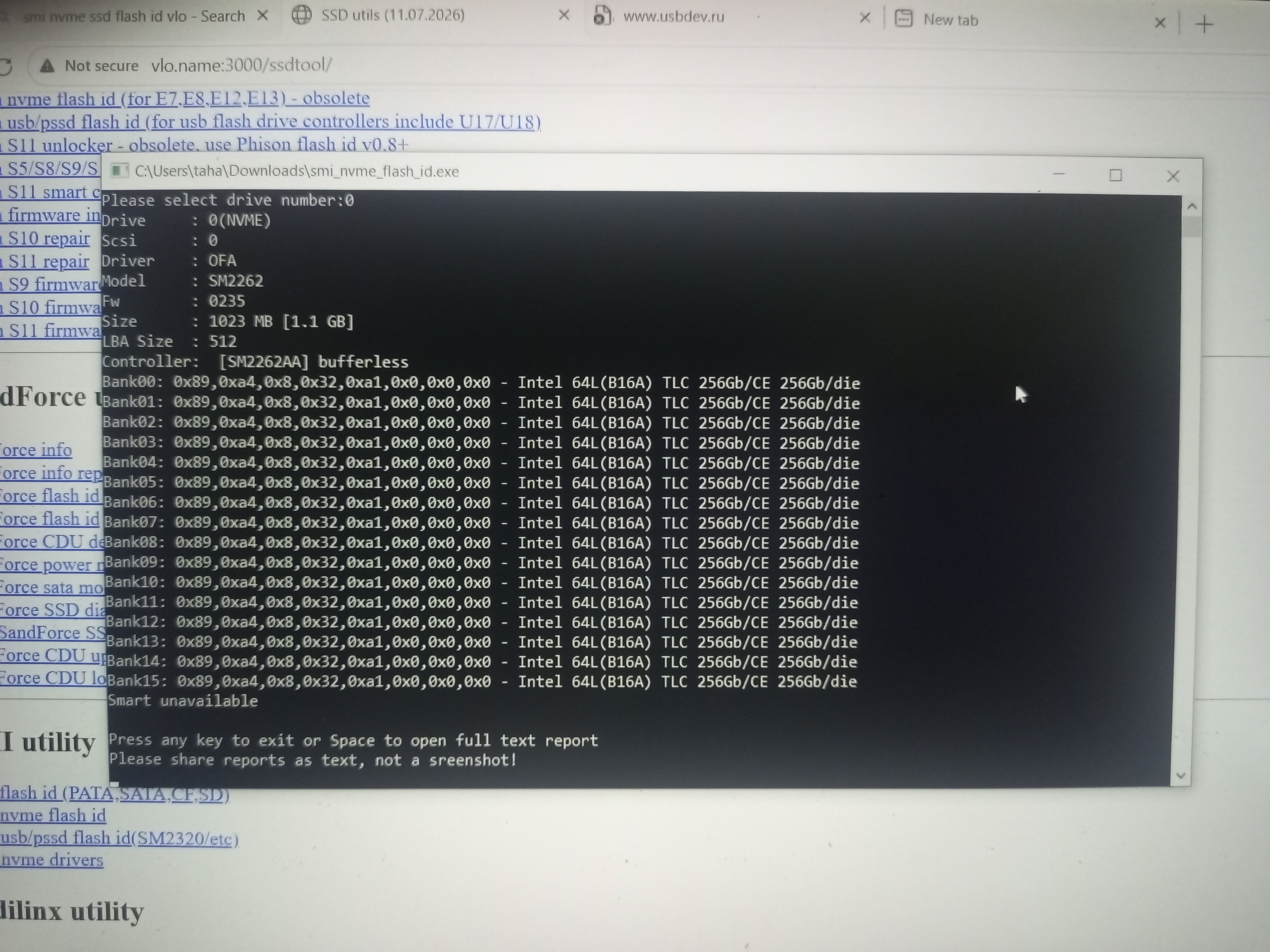

Hi all, I have an NVMe SSD that's bricked/showing 1023MB [1.1GB] capacity — needs an MPTool database that matches my exact flash ID.
Controller: SM2262 (bufferless), FW 0235
Flash: Intel 64L(B16A) TLC 256Gb/CE, 256Gb/die — 16 banks
FlashID bytes: 0x89, 0xA4, 0x08, 0x32, 0xA1, 0x00, 0x00, 0x00
Full smi_nvme_flash_id output:
Code
I've tried the SM2262 MPTool B17 build (SM2262A1_MPTool_SVN132_B17_R1208) — it detects the drive on the main screen, but Auto-detect on the Parameters tab throws a database mismatch error, and Start stays greyed out since it can't find a matching flash entry.
I noticed the SM2263XT MPTool has a B16A-specific database (R0320A_B16) that lists this exact FlashID, but that tool doesn't detect my drive at all (different controller).
Does anyone have an SM2262 or SM2262EN MPTool build with a B16A flash database, or know if it's safe to port the B16A entry from the SM2263XT database into the SM2262 tool's config? Any help finding the right package appreciated.
File comment: This is the output of nvme flash id tool
