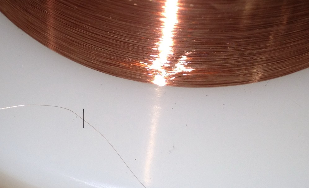

i have very thin wire for sell.
File comment: black wire is my hair
