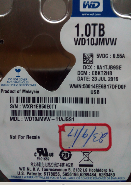

 Post subject: Re: WD10JMVW missing ROM
PostPosted: October 4th, 2017, 3:15
Posts: 285
here is the front of the drive.
thanks all ..for trying...
