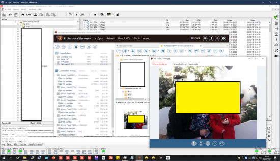

I am aware there is a subsequent update released on the 25th of May for PC3000, but please check this as I have noticed what appears to be a major bug in the handling of Bitlocker for the previous version released in April. I have not yet raised with Ace TS but will shortly.
The quick summary:
    Failed head assembly in WD HDD
    Replaced heads. Imaged HDD using SED decryption. 1 bad sector.
    Bitlocker was enabled.
    Customer provided correct password, which was entered into Data Extractor
    Extracted files normally via PC3000/Data Extractor

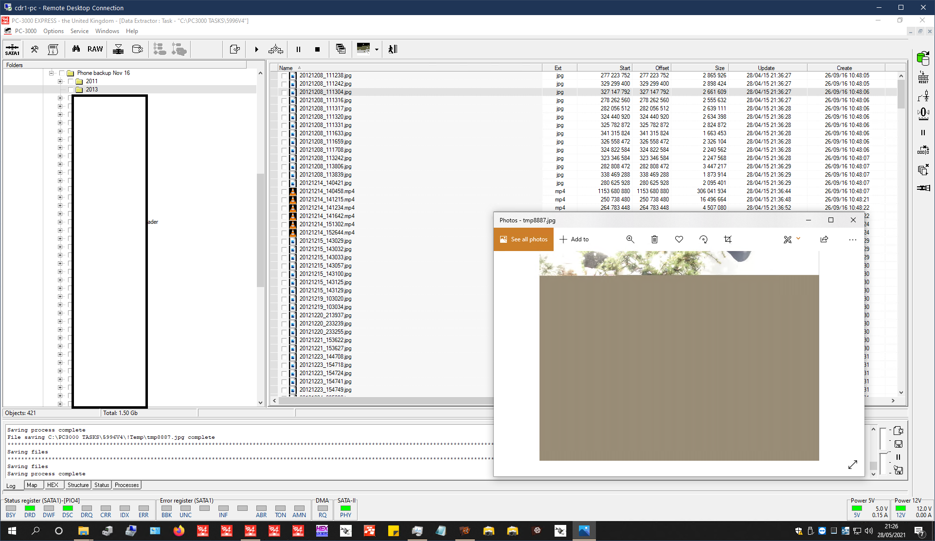

When the data was manually inspected it appeared that a large proportion of the files were corrupt. It seemed quite at random, but generally larger files. After various checks, re-imaging etc, the results could vary. It seemed very unusual. There seemed to be a repeated pattern written in parts of the extracted files which would cause partial corruption.

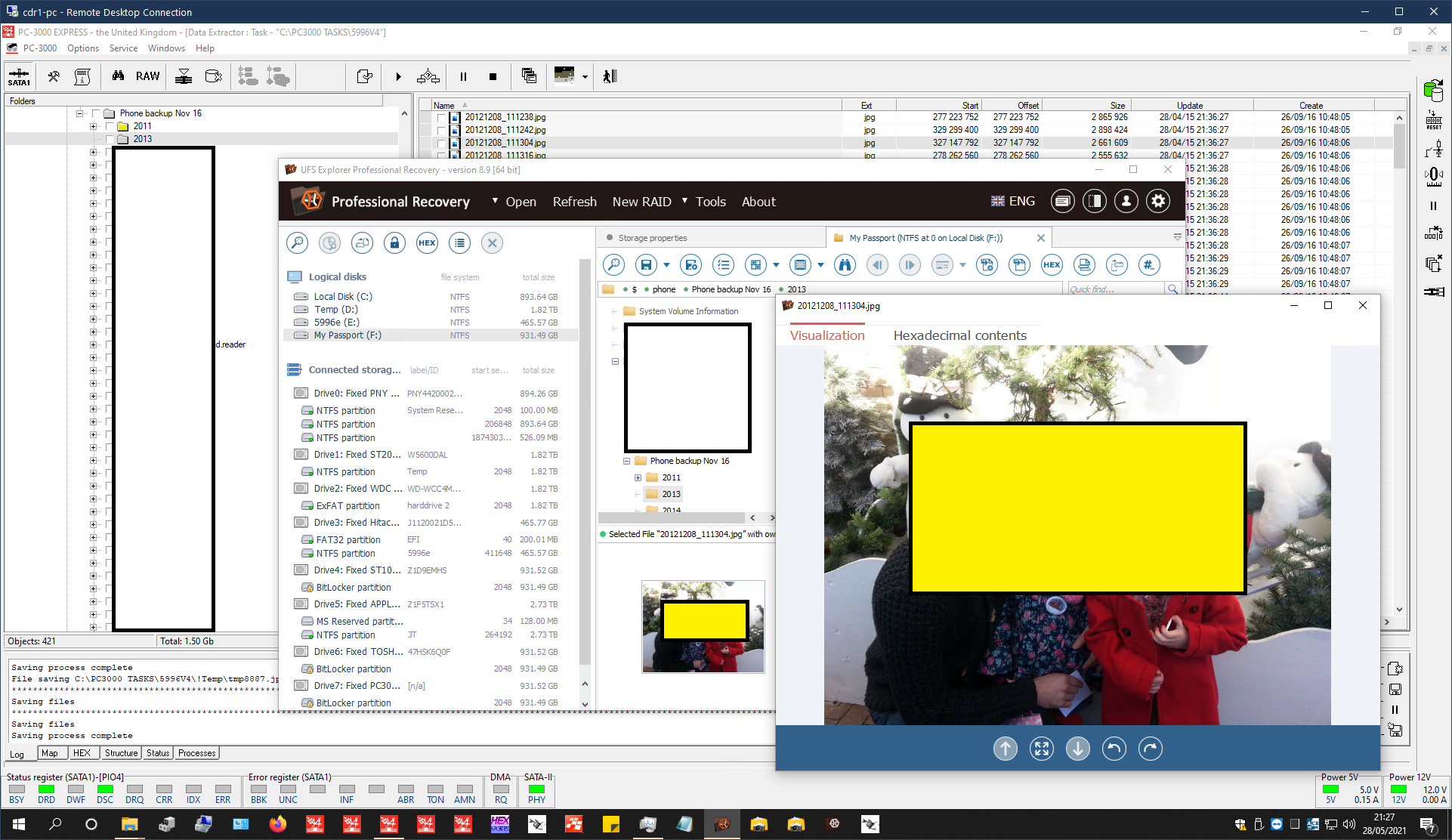

I then decided to mount the task, and then access the disk image via UFS Explorer Pro. The password was entered for Bitlocker. The files would extract normally. Please see the screen shots for opening the same image, from the same disk image in PC3000 and UFS Explorer respectively:
It appears that Data Extractor Data Extractor 5.12.3 has a fault where it is not decrypting files fully, and writing incorrect data to the files when saved from the disk image.

Work around is to mount the BL partition as read only and use R-Studio to browse...all looks well :)
