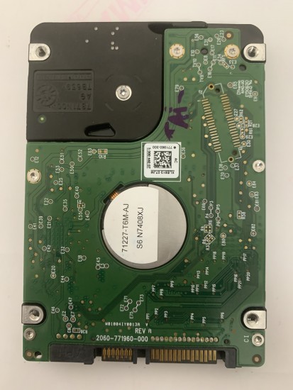

Hello to everyone
The last week in my job we received a WD10JPVX-00JC3T0 with the pcb changed. We talked with the acelab technical support and they told us the FBLite firmware is very complex and for the moment it's not possible to rebuild the rom with the firmware. Despite what acelab told me, has anyone achieved a rom regeneration in this family.
thanks very much and my best regards

Is this one of those models where ROM module 0x4F is "unique"?
https://forum.hddguru.com/viewtopic.php?f=24&t=37795
I was told (via PM) that if you disturb the adaptive parameters for head #0 on a working drive by as little as 2 points, the SA becomes inaccessible. This suggests that the adaptives are very sensitive. I haven't tried this for myself, though.
Yes, it is possible in many cases.
I could do it, pepe can do it even better than myself.

Hello Doomer thanks very much to answer me!!!
If you are interested, send a private message telling me how much you charge me to do it and your conditions.
Pepe is from Hungary?

yes, i am in Hungary, can probably recover it, depending on surface conditions that may affect success rate.

I can do it too :-)
Certainly, i have not made my attempts for a drive which was pre-opened.

Just curious ... How many attempts does it take before you gain access to the SA?
