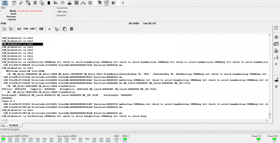

I have got a 2TB seagate Rosewood today. Someone has already worked upon ,but could not recover.
It has detection but first unlock must be done.
Drive is giving some weird message on terminal. I am curious what it means.

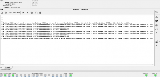

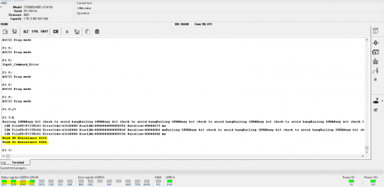

I have patched Rom and saved back on HDD.
Initially disk was use to take some time to get ready. Now it is taking more time and staying busy.
I suspect it could be head related issue. Terminal is slightly altered.
99% Heads

higgsboson wrote:
99% Heads
Yes Its heads which are getting replaced now.
