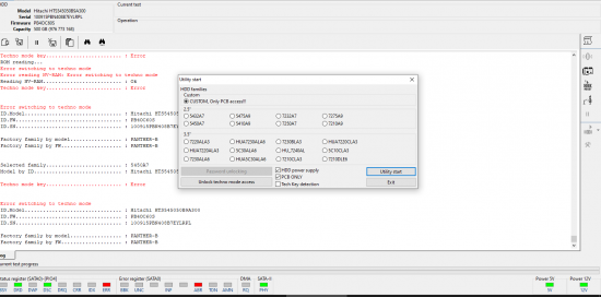

This hard disk is nowhere to be found in hitachi utility , which family I should select.

Hitachi-IBM and then custom families
Thank you melvin , at least now I can initialize drive with correct family. :good:

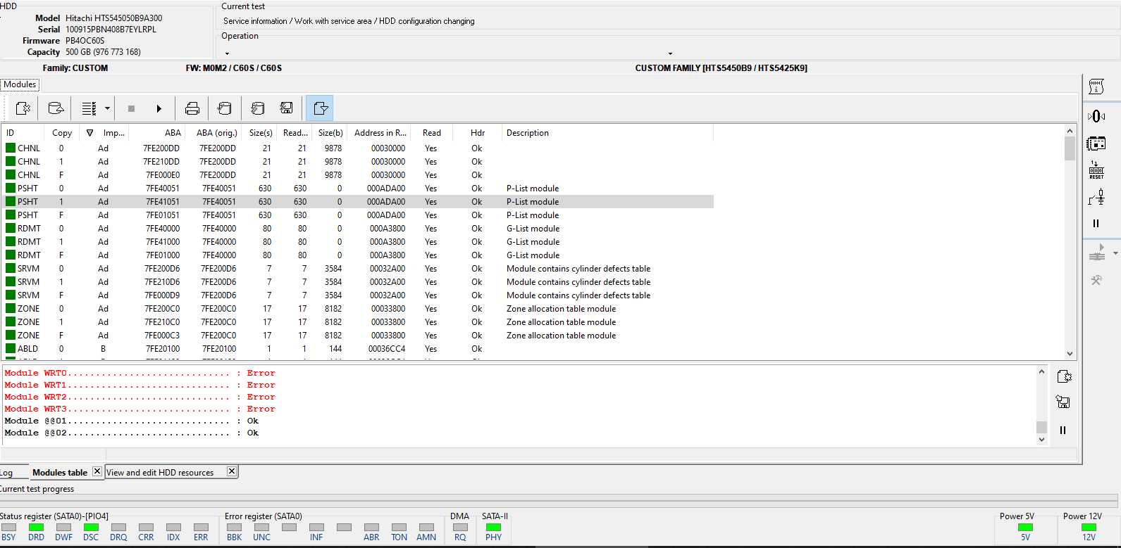

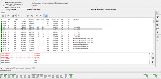

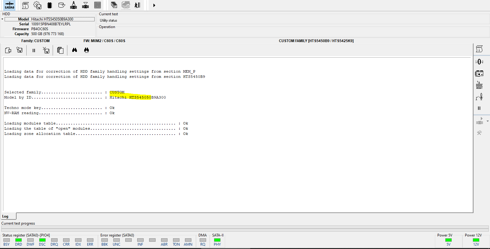

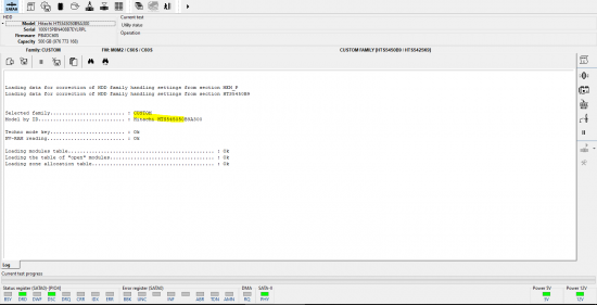

With proper family selection I have got access to modules / Zone allocation table ,and I have taken backup as well.
Most of the critical modules are ok. Disk has 4 heads & while imaging selected data disk makes screeching noise and readyness is lost.
I could not see anything in utility to work on SA .
Since modules can be read and are working can we conclude this is due to platter degradation ?
There is no way to check Heads in utility.
