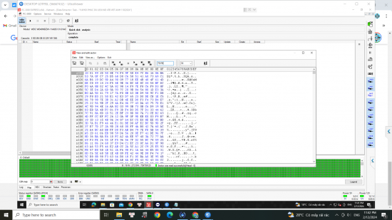

I got this 4TB WD drive in USB enclosure
Too many bad sectors made it almost impossible to read in USB mode
So i Soldered SATA cable instead
- Unlock ROM and WROTE it back to original PCB through POGO PINS
- Drive Comes Fully Ready

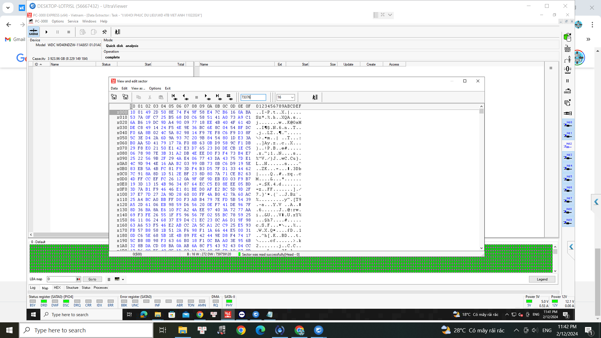

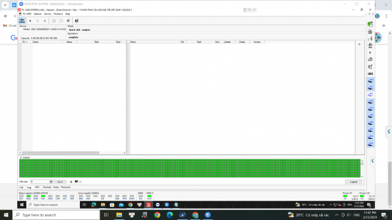

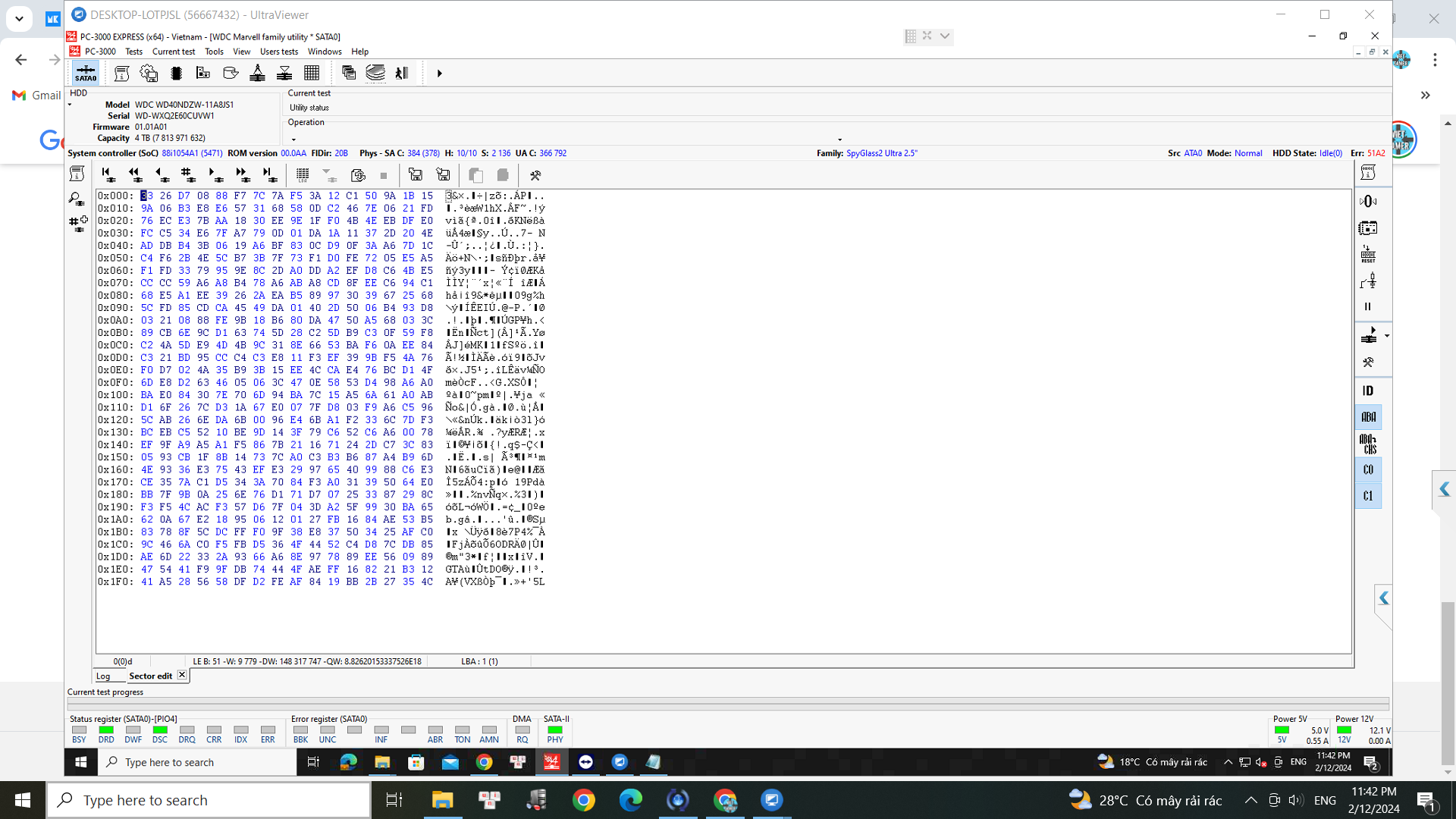

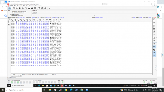

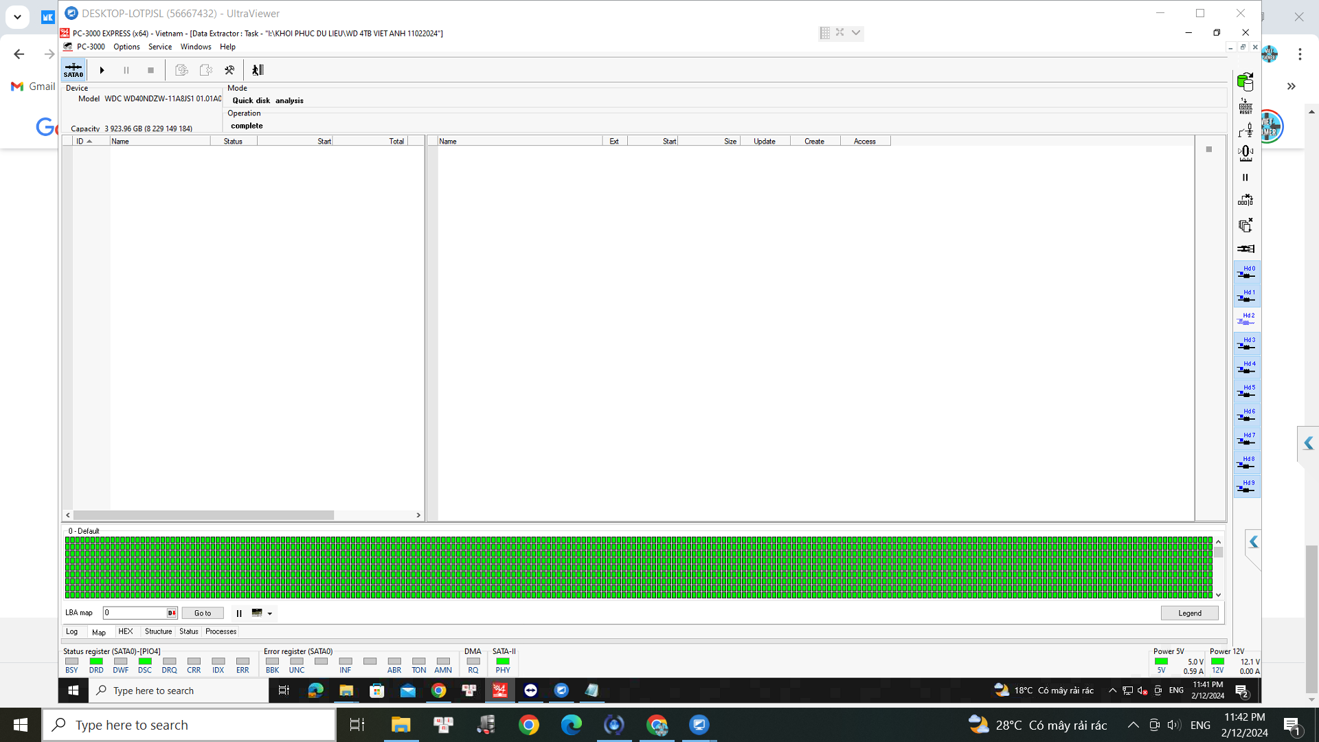

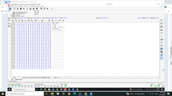

- However after Decrypting the data table wont show up in DE
- Through Sector Edit. Sectors before decryption was readable. After decryption is not readable
- Got error messages when Building Heads map
Can anyone help me with this???

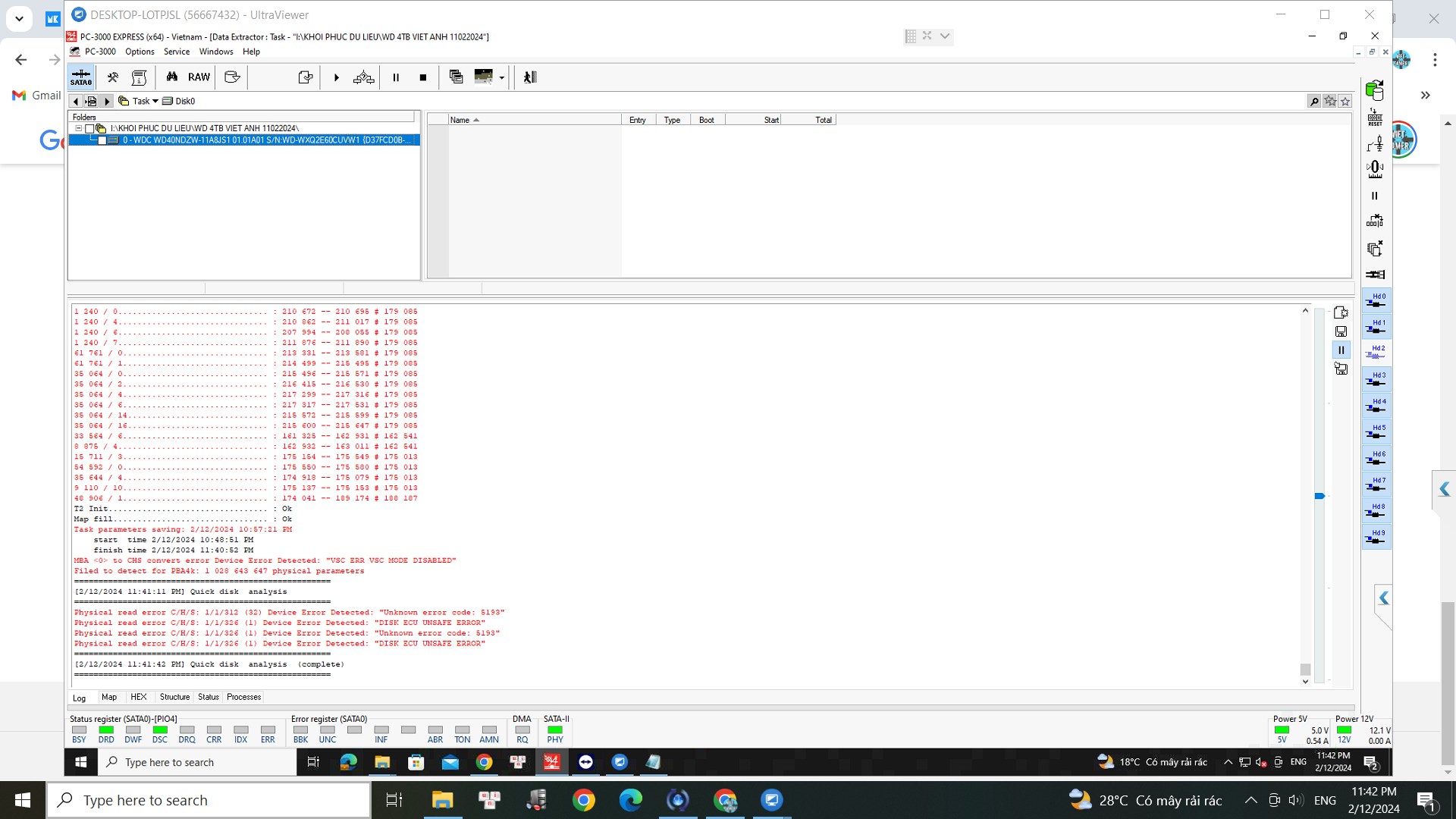

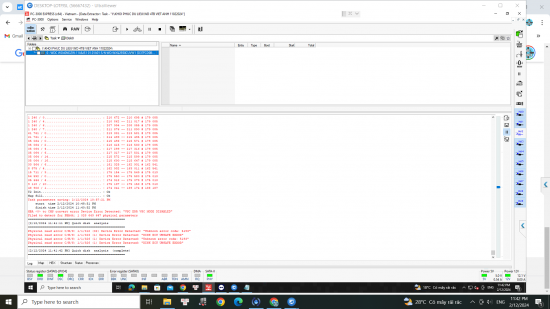

HERE IS CODE WHEN BUILDING HEADS MAP
Reading method.......................... : VSC command (T2 Data read)
T2 read................................. : Ok
Zone type............................... : Type 2
Zones................................... : 5 865
SMR zone read........................... : Ok
SMR zone indexing....................... : Ok
26 329 / 9.............................. : 193 030 -- 195 885 # 173 119
26 329 / 10............................. : 196 121 -- 196 983 # 173 119
2 296 / 4............................... : 197 227 -- 203 049 # 173 119
2 296 / 12.............................. : 203 050 -- 208 570 # 173 119
38 749 / 5.............................. : 208 571 -- 214 399 # 173 119
41 036 / 4.............................. : 206 153 -- 206 860 # 176 129
58 306 / 4.............................. : 206 861 -- 207 364 # 176 129
58 306 / 7.............................. : 207 365 -- 207 857 # 176 129
......................STILL MORE AFTER THIS................
MBA <0> to CHS convert error Device Error Detected: "VSC ERR VSC MODE DISABLED"
File comment: Quick Disk Analysis
File comment: Green Sector in DE
File comment: Head Map
File comment: Data in Sector Edit After Decryption
File comment: Data in Sector Edit before Decryption

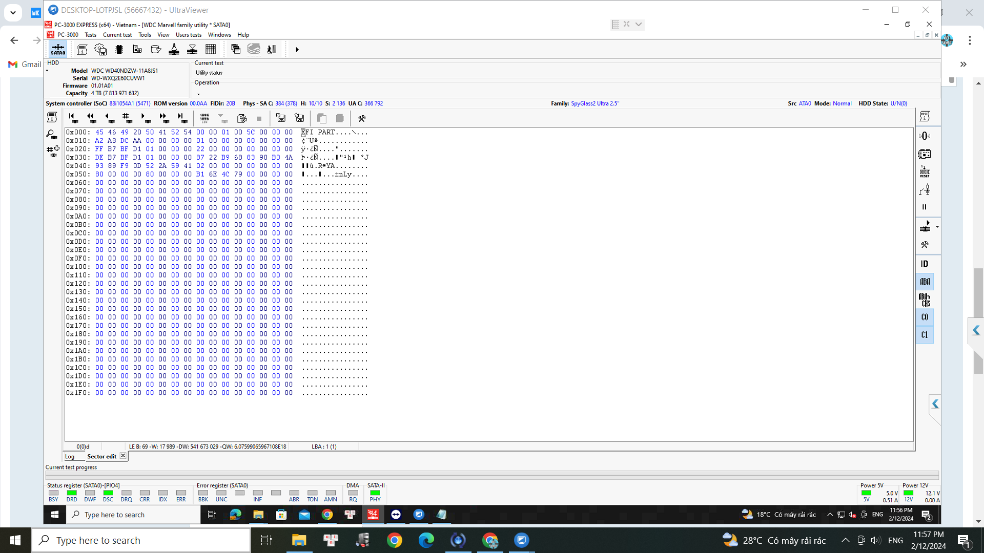

Why do you try to decrypt it when you use original PCB? Last photo shows that sector is good and decrypted.
odzyskiwanie danych
 Post subject: Re: WD WDC WD40NDZW-11A8JS1 Spyglass Ultra 2 Cannot Decrypt
PostPosted: February 13th, 2024, 10:54
Posts: 90
Location: Edinburgh, uk
Exactly, Melvin is right. You shouldn't need to choose decryption if you can see EFI sector as it's clearly decrypted.
I would backup T2 and all mods and block UA though. Looks like UA isn't locked.

But i still don't have access to the data
In DE it doesnt recognize any partitions or any data. Even though in the Data Green sectors it shows data
PostPosted: February 13th, 2024, 13:54
Posts: 357
Check RAW if there are any files. Also check if sector 0 is also readable and uncrypted. It may happen that encryption key is damaged or reset.
