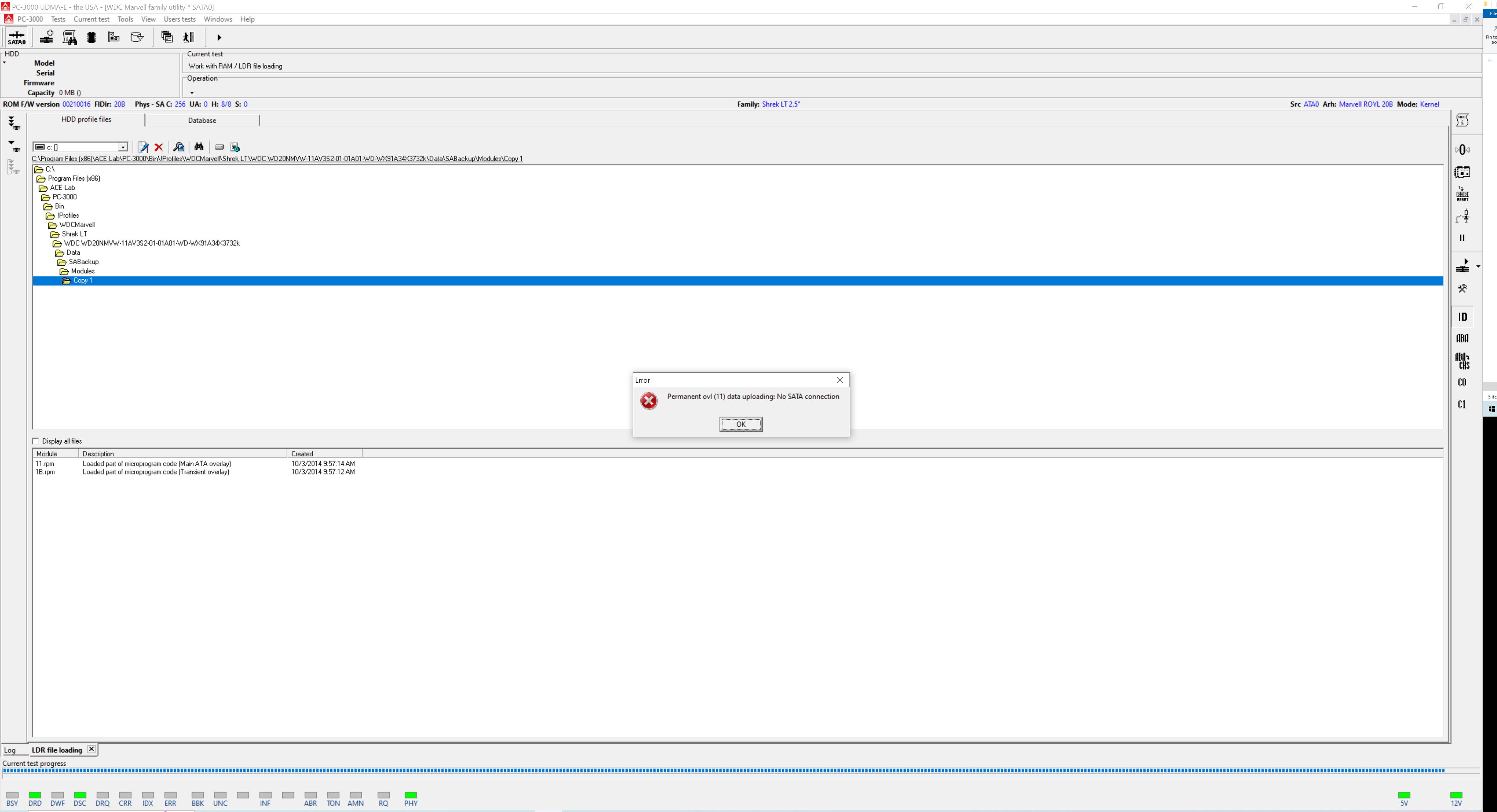

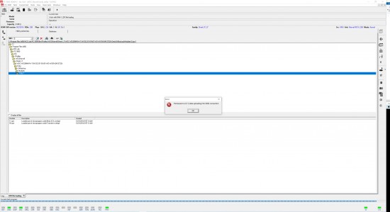

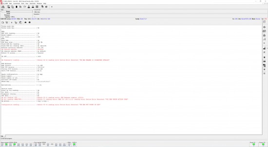

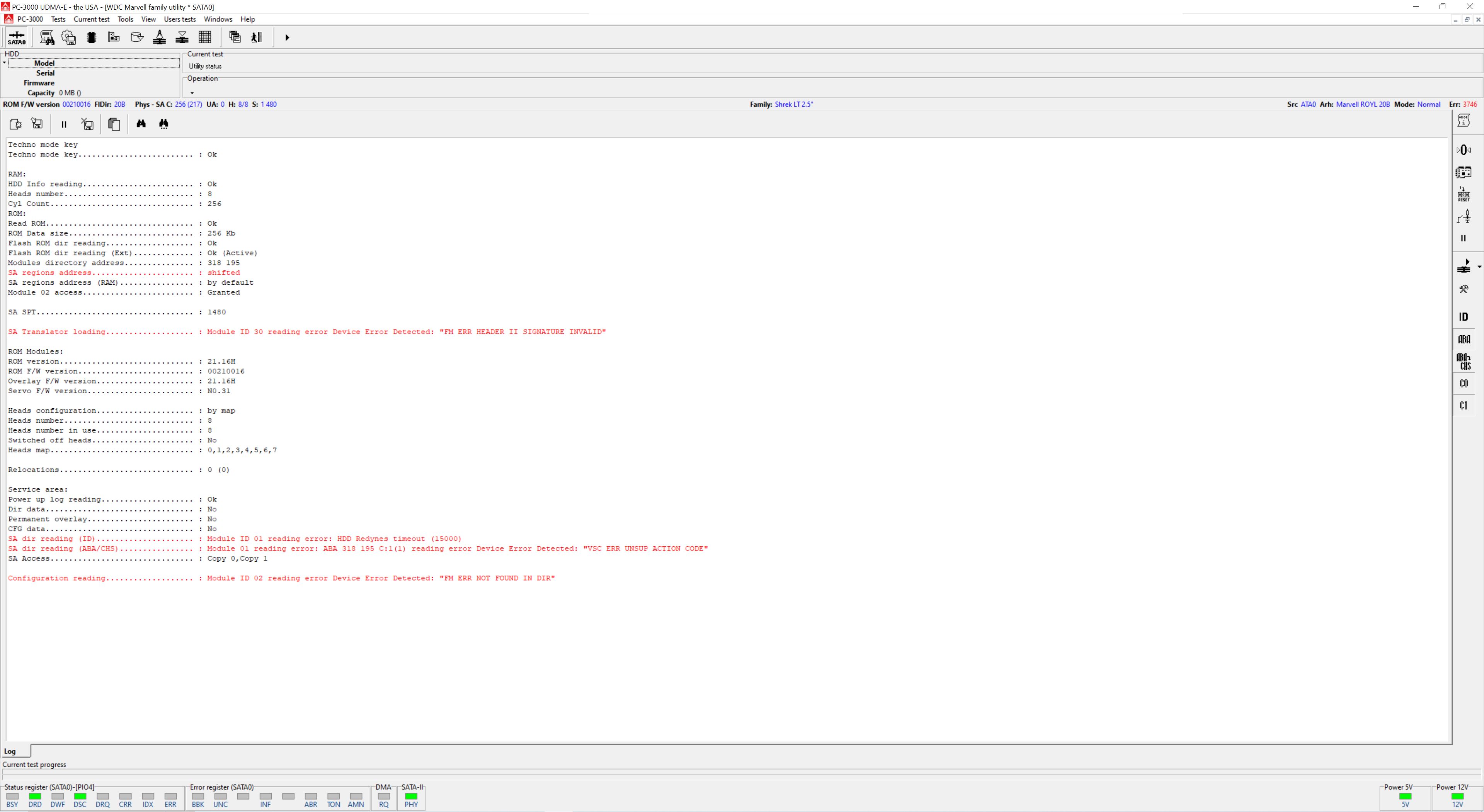

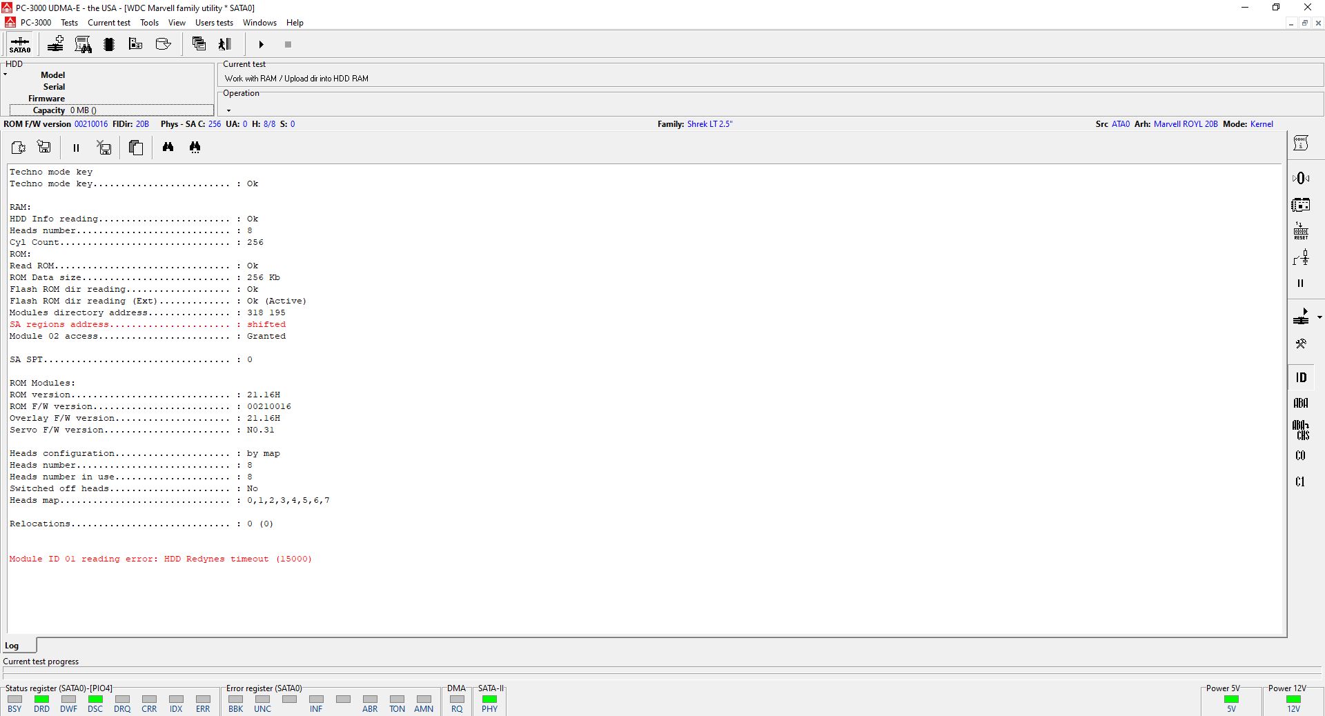

I have WD20NMVW-11AV3S2 2TB :
I converted it to SATA no passport info display. I followed the steps here :
https://blog.acelab.eu.com/pc-3000-hdd- ... oblem.html
and I stuck with :
SA dir reading (ID)..................... : Module ID 01 reading error: HDD Redynes timeout (15000)
SA dir reading (ABA/CHS)................ : Module 01 reading error: ABA 318 195 C:1(1) reading error Device Error Detected: "VSC ERR UNSUP ACTION CODE"
SA Access............................... : Copy 0,Copy 1
Configuration reading................... : Module ID 02 reading error Device Error Detected: "FM ERR NOT FOUND IN DIR"

What was the original problem of the drive before you converted to SATA ?
Any noises, drive keeps spinning or not. Gain SA access and write back what you changed from you backup.
Are heads working fine in test ?
