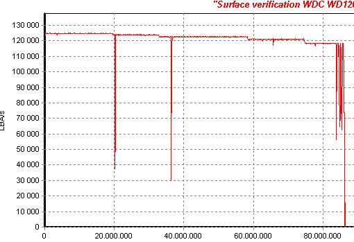

Hi to all hddgurus,
I have this disk that head 1 is with problem ( click when is enable) when i disable it , i can have ID.
I make the hotswap and it work.
Now i could copy almost all the data incluing head 1.
Make a Head test 0,1,4 and the heads looks OK, the head 1 dont give error.
i just need about 9xx xxx sectors that are in head 1, to finish this job.
I try also read sector by sector, read udma 33, read without CRC control but that sectors i can not read it.
Also i notice that from the 86 xxx xxx i start to have some errors in the Logical Test.
SA Structure test
26: 0 : : -2: 0: 525: 129:Yes : Ok : Ok : 0F :12-10-05:108W? :
26: 1 : : -2: 1: 525: 129:Yes : Ok : Ok : 0F :12-10-05:108W? :
28: 0 : : -2: 0: 658: 16:Yes : Ok : Ok : 5D :25-12-05:0300? :
28: 1 : : -2: 1: 658: 16:Yes : Ok : Ok : 5D :25-12-05:0300? :
2D: 0 : : -3: 0: 0: 283:Yes : Ok : Ok : CB :/WRONG/ :0203? :
2D: 1 : : -3: 1: 0: 283:Yes : Ok : Ok : 6D :12-10-05:108W? :
E3: 0 : Dr : -35: 0: 0: 510:Yes :Error: Ok : CE :/WRONG/ :0203? :Selfscan defects log
E3: 1 : Dr : -35: 1: 0: 510:Yes : Ok : Ok : F5 :12-10-05:6271? :Selfscan defects log
Logical SCAN
Pass.................................... : 1
Test.................................... : Surface verification
ERROR! LBA : 20 222 746 HDD Readiness timeout (200 ms)
ERROR! LBA : 20 222 747 HDD Readiness timeout (200 ms)
ERROR! LBA : 20 222 749 HDD Readiness timeout (200 ms)
ERROR! LBA : 20 222 750 HDD Readiness timeout (200 ms)
ERROR! LBA : 36 401 306 HDD Readiness timeout (200 ms)
ERROR! LBA : 36 401 307 HDD Readiness timeout (200 ms)
ERROR! LBA : 36 401 308 HDD Readiness timeout (200 ms)
ERROR! LBA : 36 401 309 HDD Readiness timeout (200 ms)
ERROR! LBA : 83 859 033 HDD Readiness timeout (200 ms)
ERROR! LBA : 83 859 034 HDD Readiness timeout (200 ms)
ERROR! LBA : 84 822 900 HDD Readiness timeout (200 ms)
ERROR! LBA : 85 322 088 HDD Readiness timeout (200 ms)
ERROR! LBA : 85 440 282 HDD Readiness timeout (200 ms)
ERROR! LBA : 86 162 393 HDD Readiness timeout (200 ms)
Any help Thanks
