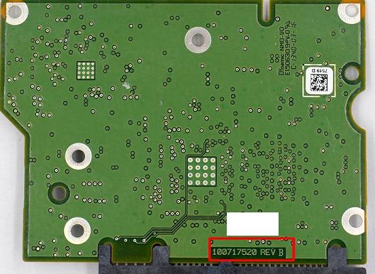

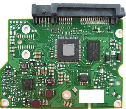

Can anyone guide me for shorting point of 100717520 Rev B.
Pic of PCB attached
Thanks in advance

Re: Shorting Point
October 16th, 2015, 3:11
15+16 or 17+18
Re: Shorting Point
October 16th, 2015, 3:12
contacts 16-18 on J4
odd the top row, the lower even
Re: Shorting Point
October 16th, 2015, 12:11
17+18 Worked but with following error
Boot 0x40M
Spin Up[LBA=0x000042F9]N02020C20o0o0o0o0o0o0o0o0[LBA=0x000042F9]NO1111[LBA=0x00066E3B]N01010C20o0o0o0o0o0o0o0o0[LBA=0x00066E3B]NO1111[LBA=0x00028F1D]N01020C10o0o0o0o0o0o0o0o0[LBA=0x00028F1D]NO1111[LBA=0x0008BA5F]N01010C10o0o0o0o0o0o0o0o0[LBA=0x0008BA5F]NO1111
SimError - Remaining in BootFW
Perform a double download without a power cycle
Terminal output at power on
Boot 0x40M
Re: Shorting Point
October 17th, 2015, 6:58
You are shorting the drive to early it's all about timing with the Seagate DM drives.
By the way what's the problem with the drive?
Re: Shorting Point
October 18th, 2015, 4:50
HDD remains in bsy state.
No buzz/no clicking/motor not spin down.
At power on remains busy & terminal output is
Boot 0x40M
Spin Up
Trans.
Spin Up
SpinOK
SnapshotEventOccurred( SNAPSHOT_INITIAL_VALUES ).
(P) SATA Reset
Tried motor isolation method but not worked.
In short circuit method give following output (HDD goes in ready state)
Boot 0x40M
Spin Up[LBA=0x000042F9]N01020C10o0o0o0o0o0o0o0o0[LBA=0x000042F9]NO1111[LBA=0x00066E3B]N01010C10o0o0o0o0o0o0o0o0[LBA=0x00066E3B]NO1111[LBA=0x00028F1D]N01020C10o0o0o0o0o0o0o0o0[LBA=0x00028F1D]NO1111[LBA=0x0008BA5F]N01010C20o0o0o0o0o0o0o0o0[LBA=0x0008BA5F]NO1111
and after that if i restart utility without re-power it detects
Model : ST2000DM001
Firmware : SC48
Capacity : 3.86 GB (8 089 950)
Re: Shorting Point
October 18th, 2015, 7:10
So now I'd go in, edit module 93 to disable all the auto reallocation and idle activities so it'll start up normally going forward. Then try to figure out why it's not showing correct capacity, maybe it will after power cycle.
