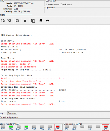

I have a 2 TB Seagate Hard Drive . I want to recover my data but an error accrued.
Error is : ABR
Please guide me what type of error and what is the solution.
Best Regards
August 23rd, 2022, 10:22
It means that the drive is trying to access a sector and aborts.
To fix it, you need to find out why it aborts.
To find out why it aborts, first provide us with terminal output.
August 24th, 2022, 0:50
Thanks your kind response
I am a new User in Pc-3000
Please Guide me how to find out why its abort.
Please find attachment

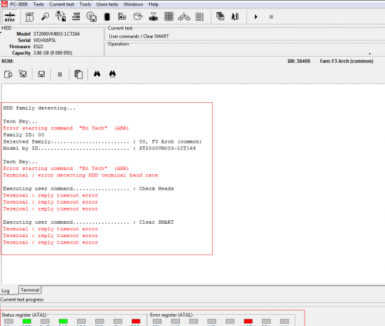

August 24th, 2022, 2:47
Does it click and spin down?
August 24th, 2022, 3:28
Yes it clicks 2 or 3 times ,then spinning stop
I am also trying to test heads
- Attachments

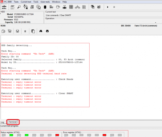

August 24th, 2022, 8:47
Check messages in terminal.
- Attachments
August 24th, 2022, 11:23
ddcywf wrote:Yes it clicks 2 or 3 times ,then spinning stop
Your drive has head failure.
1. It clicks and shuts down - head failure
2. Its not reading the SA - head failure
3. Its reporting 4GB which is just from the PCB - head failure.
August 24th, 2022, 15:51
Moreover, it is Bacall family, so need to unlock it to be able to access firmware or anything.
But in the current state unlocking does not take you anywhere, you need to treat the head failure first of all.
As the others, i would also welcome a terminal log.
BTW, if you are new to DR and pc3k, read the docs and try to understand how things work, preferably get familiar with your tool testing working drives.
Just my 2 cents...
