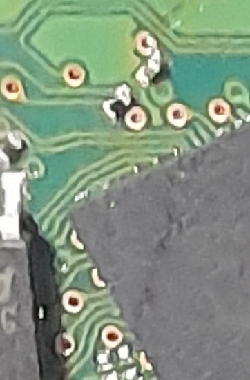

A wd charger 2 TB come from customer with fisically broken pcb and MCU :|
Rom is good.
Is data recovery still possible?
Thanks in advance for help and advices

What happened to the MCU?
smecca wrote:Is data recovery still possible?
We don't know, but the easiest way is to check...

Hi, thank for you reply
Customer tryied a diy usb port repair. Badly badly done. It ended xracking pcb along usb port side, cracking an angle of mcu.
Mcu part view

The quickest way is to replace it with a compatible PCB and check if the encryption is active.
Are you sure it's a crack?
Re: Wd charger pcb with broken pcb and mcu.
June 16th, 2026, 11:14
Pretty sure. Later i will desolder the die to inspect downside and pads conditions
Already tryied to use alternative compatible pcb (usb 800067) and hdd is ok, spins, ready state, sector edit:encrypted. If it is encrypted via usb i thing noway using full conversion procedure
