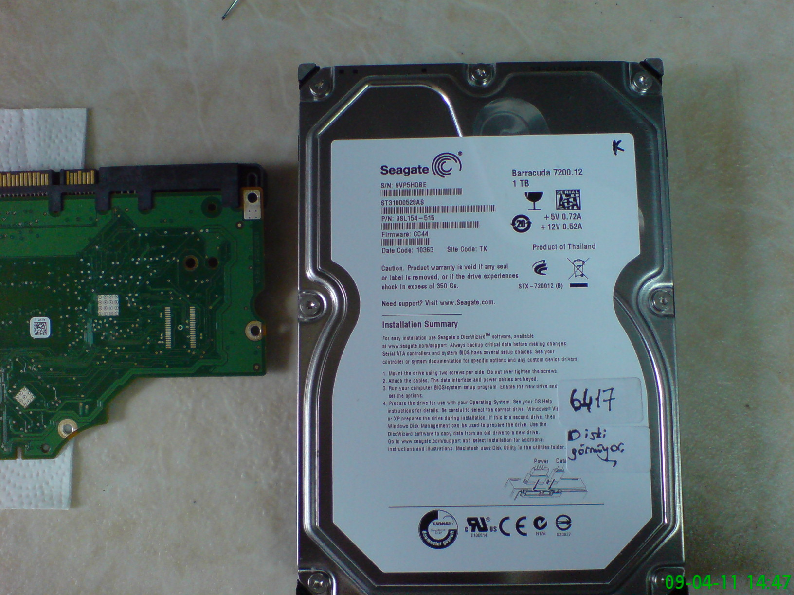

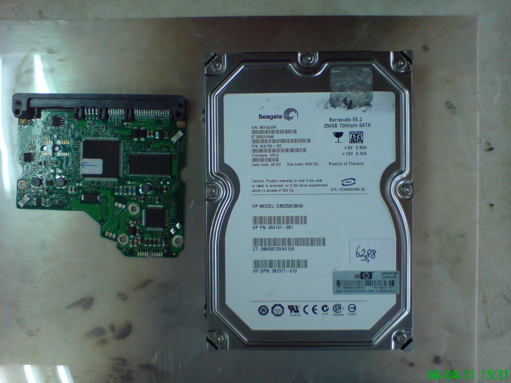

hi, i have ST3250310NS also but its firmware HPG2. Is there anyone have this hdd's firmware fıle. For exaple reads via an eprom programmer and dump the file or read via pc3000? if you needs our eprom file i have uploaded the file. this file can not turn hdd's motor.
st3250310ns_fw_hpg2_dc_09103_sc_kratsg_hpmodel_gb0250c8045.h [512 KiB]
Downloaded 723 times
