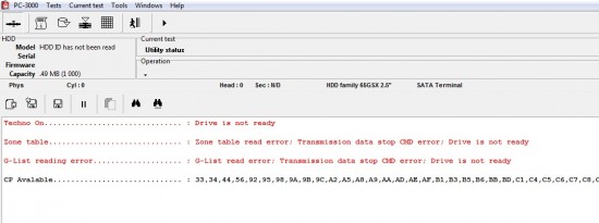

i am getting this (Attached)error in pc3000 portable ,
Unable to read HDD ID,BSY,DRD and DSC glows,
I also have donor PCB. What might be issue?
Thanks to all gurus in advance

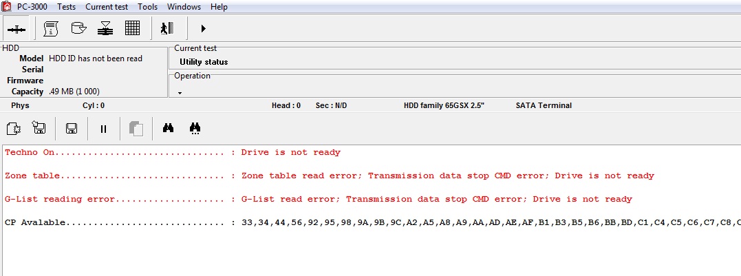

YES HDD Spins
No Noise Like head issue
terminal attached
Original PCB
