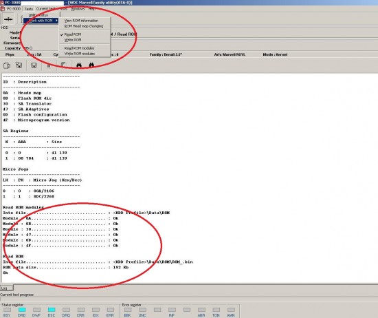

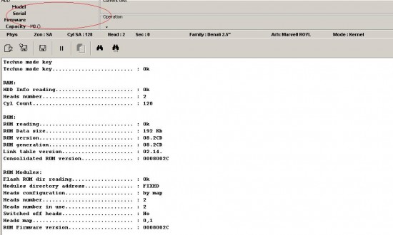

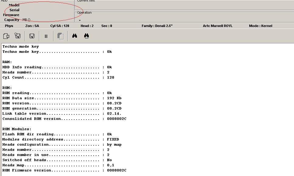

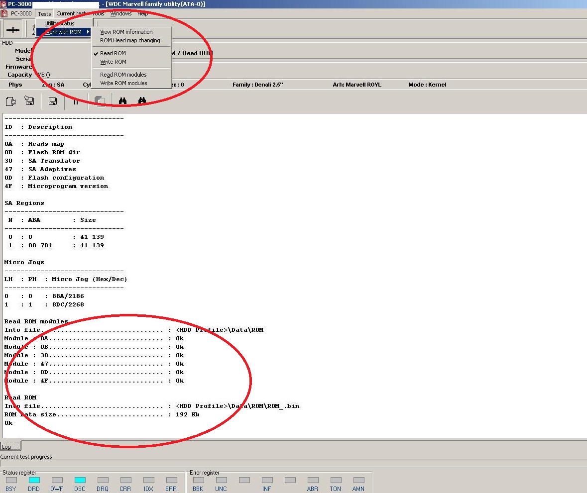

Hi to all!
After an exchange of the HDD heads respond well ...
Denali
Techno mode key
Techno mode key......................... : Ok
RAM:
HDD Info reading........................ : Ok
Heads number............................ : 2
Cyl Count............................... : 128
ROM:
ROM reading............................. : Ok
ROM Data size........................... : 192 Kb
ROM version............................. : 08.2CD
ROM generation.......................... : 08.2CD
Link table version...................... : 02.14.
Consolidated ROM version................ : 0008002C
ROM Modules:
Flash ROM dir reading................... : Ok
Modules directory address............... : FIXED
Heads number in use..................... : 2
Switched off heads...................... : No
Heads map............................... : 0,1
ROM Firmware version.................... : 0008002C

 Post subject: Re: WD DENALI
PostPosted: November 17th, 2011, 16:48
It's in kernel mode, so no SA access.
Drive remains spinning after coming DRDY?

Does HD remain powered? IF so select 'View Module 90 information' and it should give to you the SA version.
If ROM is native then version is 0008002C. Is PCB/ROM native?
