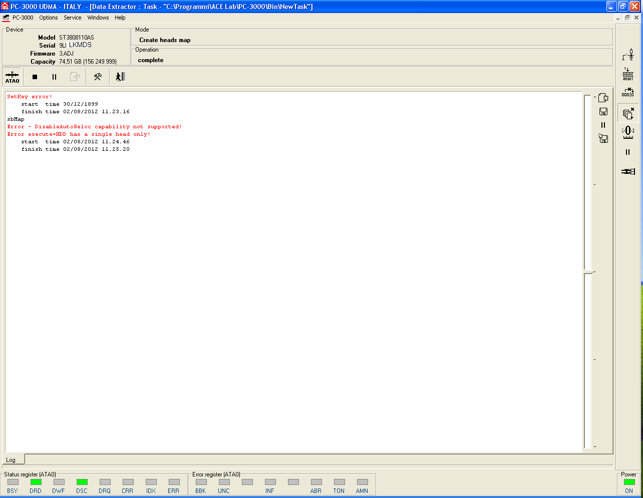

Got a tonka 2 always busy,
creating loader bring the disk to ready state and to ID's,
but all sectors are blacks..

terminal?

northwind wrote:
terminal?
i attached here
reading_blocks.log [3.71 KiB]
Downloaded 622 times
1start.txt [698 Bytes]
Downloaded 608 times
 Post subject: Re: Tonka2 always busy
PostPosted: August 6th, 2012, 3:25
Posts: 3551
Failed sys sect. write!
Add To Pending 5557555
A lot of errors. Did you try pending bug solution? I doubt it will work (i think more serious problem is there) but it doesn't hurt to try...

yep i tryed. head swap worked, looks like this old drive flake the platter and lead to head contamination..
data all recovered, happy customer.
i love when hard drives have got only 1 head :D
