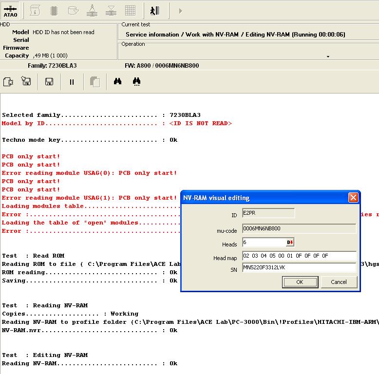

I have HDS723020BLA642 and cannot handle with PC3000 UDMA. Anyone utility dont wont work.
Perhaps someone are faced with this monster and can help me.
thx and sorry for bad english :)

Describe history and drive behavior!

You should explain all that happened.

I use wrong utility (Hitachi), need use Hitachi-IBM-ARM.
Anyway i think bad heads, because i hear clicking sound and state always BUSY. If unscrew PCB i can connect to PCB read ROM.

So, first of all, does not seem any PC3000 problem, but a drive problem.
You should test your PCB and also heads to be sure what's the real issue with it.
