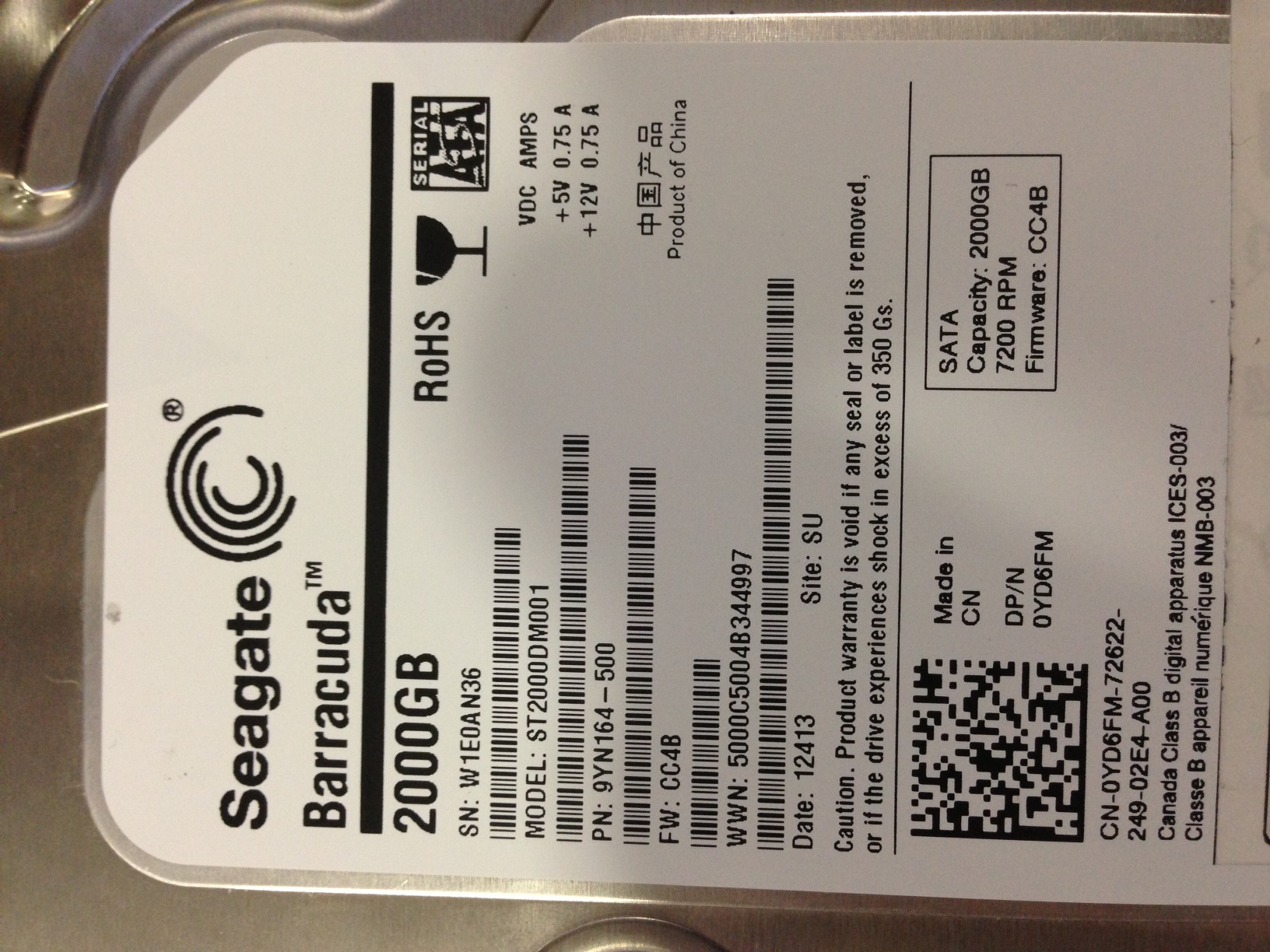

Hello to everybody . Im new around here but i have been reading this forum for a long time.
I am trying to solve a firmware issue, or at least its what i think its the problem, but with no success.
After getting reed of the LED error by short circuiting the Main Board i am getting this on the terminal.
The drive as soon as you try to read any sector it gets an UNC error and i have no access until a soft or hard reset
This is the terminal log:

File comment: Here are the drives specification

Sorry , the picture is flipped
