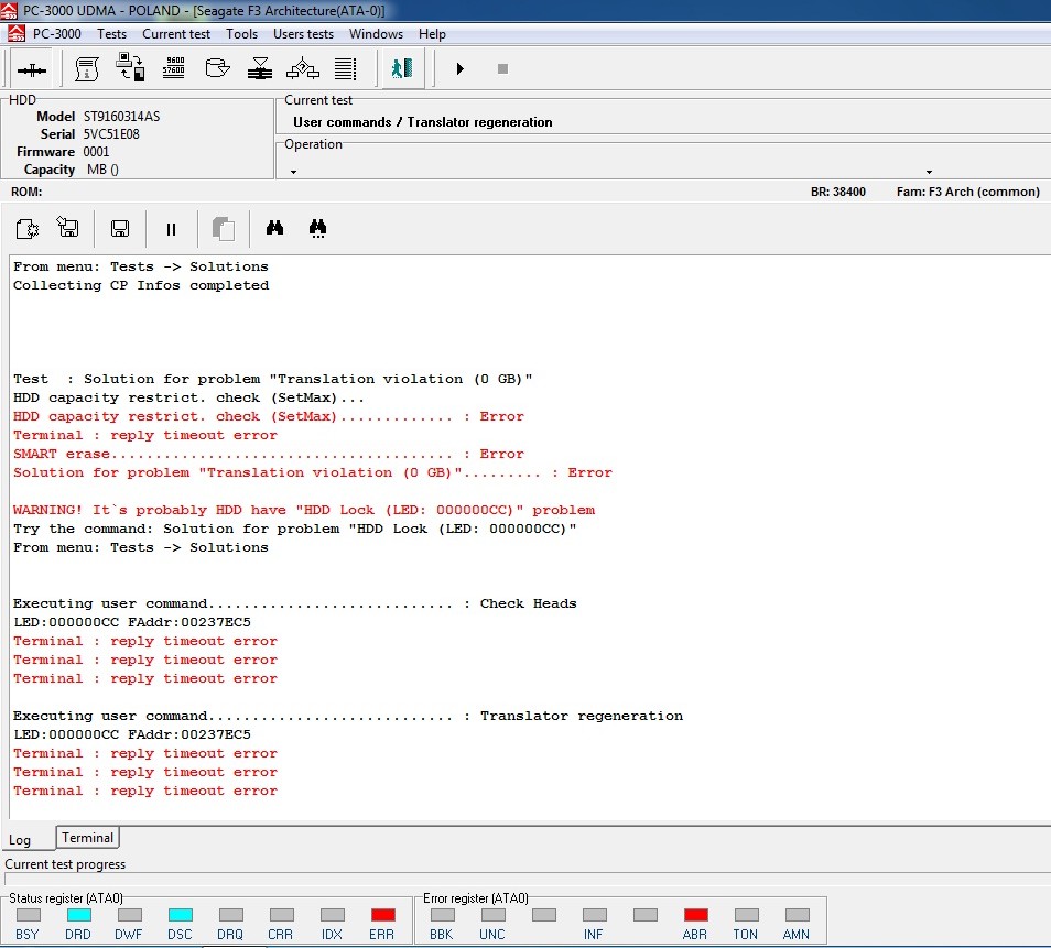

 Post subject: Momentus 5400.6 - 0MB problem - solution don't work
PostPosted: March 12th, 2011, 7:07
Joined: May 11th, 2010, 9:03
Posts: 54

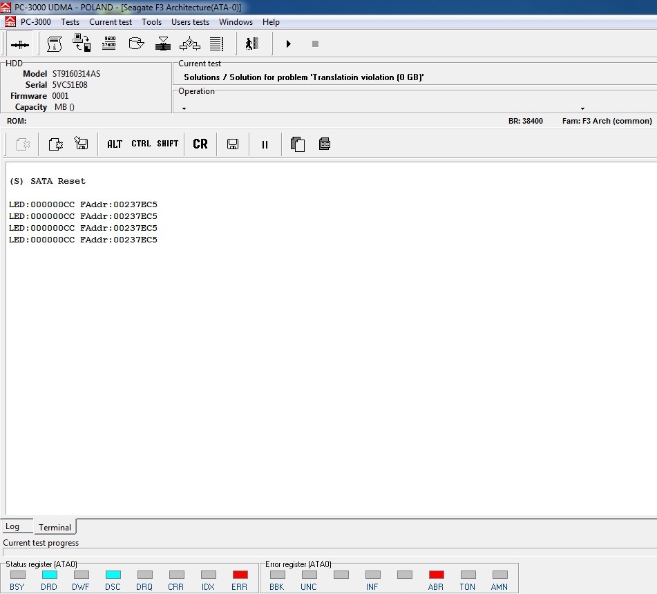

Today I've encountered following problem with Seagate Momentus 5400.6, after powering on it was recognized and DRD, DSC leds appeared.
After opening utility, the capacity was ( )MB, so I tried to use the solution, but without good result, You can see the attachment.
Tried also to read response from terminal, it showed only:
Rst 0x08M
After trying to regenerate translator, it failed, but terminal showed a few responses:
LED:000000CC FAddr:00237EC5
Would You please provide advices, how to solve this problem and what do You think the problem is related to?
Swapping the heads could solve the problem ?
By the way, I have successfully done HDD resources backup.
Thanks for answers folks!
 Post subject: Re: Momentus 5400.6 - 0MB problem - solution don't work
PostPosted: March 12th, 2011, 7:18
Posts: 215
Location: Dubai U.A.E
if your Heads also Bad it shows same error.....
PostPosted: March 12th, 2011, 7:26
Posts: 2848
this is a 0 LBA & might be also 000000CC as well
no heads issue related to it.

Ace provided a ready to use solution with instructions which might fix the problem.
I used the solution (You can see it on 2nd picture above) but it was terminated by an error.
In the past, I've successfully repaired a few 7200.11 where it was similar problem, but according to Momentus 5400.6 it's my first case with this family and want to be sure, what next steps shall I perform to repair the drive.
Thanks in advance for advices and hints.

According to clayron's instructions from:
seagate-st9500325as-5400-t15155.html#p99337
I'm sending the log to forum, so maybe somebody will give me a hint how to solve the problem.
Rst 0x08M
RW cmd 002F req = 18 F0 9F E5 18 F0 9F E5 18 F0 9F E5 18 F0 9F E5 18 F0 9F E5 00 00 A0 E1
            opts = 00000000
RW Err = 84150180
ASCII Diag mode
F3 T>/2
F3 2>Z
Spin Down Complete
Elapsed Time 0.140 msecs
F3 2>
It is not heads then
Probably some read errors in SA
Read all SA tracks in check what's bad
PostPosted: March 14th, 2011, 17:03
Posts: 54
After performing steps in terminal described above, what I did next is reading CP's and SA modules (all of them were read without errors) then I performed translator regeneration and it solved the problem.
The weird thing is that during first attempt of regenerating translator it finished with an error.
Whatever, the disk works fine and the case is closed.
