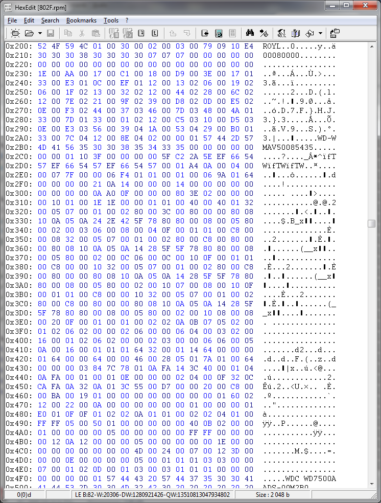

I presume you have managed to retrieve the other SA modules. If so, then look for a copy of MOD 02 at offset 0x200 in MOD 802F.
00000000  52 4F 59 4C 03 00 30 00 2F 80 04 00 3B E8 39 73  ROYL............
00000010  36 32 30 38 00 00 00 00 0B 16 08 00 00 00 00 00  6208............
00000020  00 00 00 00 00 00 00 08 00 00 00 00 00 00 00 00  ................
000001F0  00 00 00 00 00 00 00 00 00 00 00 00 00 00 00 00
00000200  52 4F 59 4C 01 00 30 00 02 00 03 00 09 5A D8 B0  ROYL............
00000210  30 30 30 38 30 30 30 30 07 07 07 00 00 00 00 00  00080000........
00000220  00 00 00 00 00 00 00 00 00 00 00 00 00 00 00 00
00000230  1E 00 AA 00 17 00 C1 00 18 00 D9 00 33 00 0C 01

fortunately, that module has read fine. There are only the following modules damaged
02, 6F, 2D and 2E
Here it is the 802F content at offset 0x200
see attachment
File comment: offset 0x200 in 802F module

I suppose I need to know some length to be copied and pasted ... or similar :wink:
Or the copy of module 02 is the content from 0x200 up to the EOF?
Thank you for your teach
 Post subject: Re: WD7500AADS-00M2B0 86.0CG 0086000C module 02 request
PostPosted: September 25th, 2014, 6:29
Joined: June 25th, 2006, 13:51
Posts: 143
Location: Italy
Thank BUD!
It worked with the copy from 802F
Really thank you so much! :wink:

Offset 0x020A-0x020B is the size of the MOD in sectors.
The size of MOD 802F is 0x0004 sectors while MOD 02 has a size of 0x0003 sectors.
