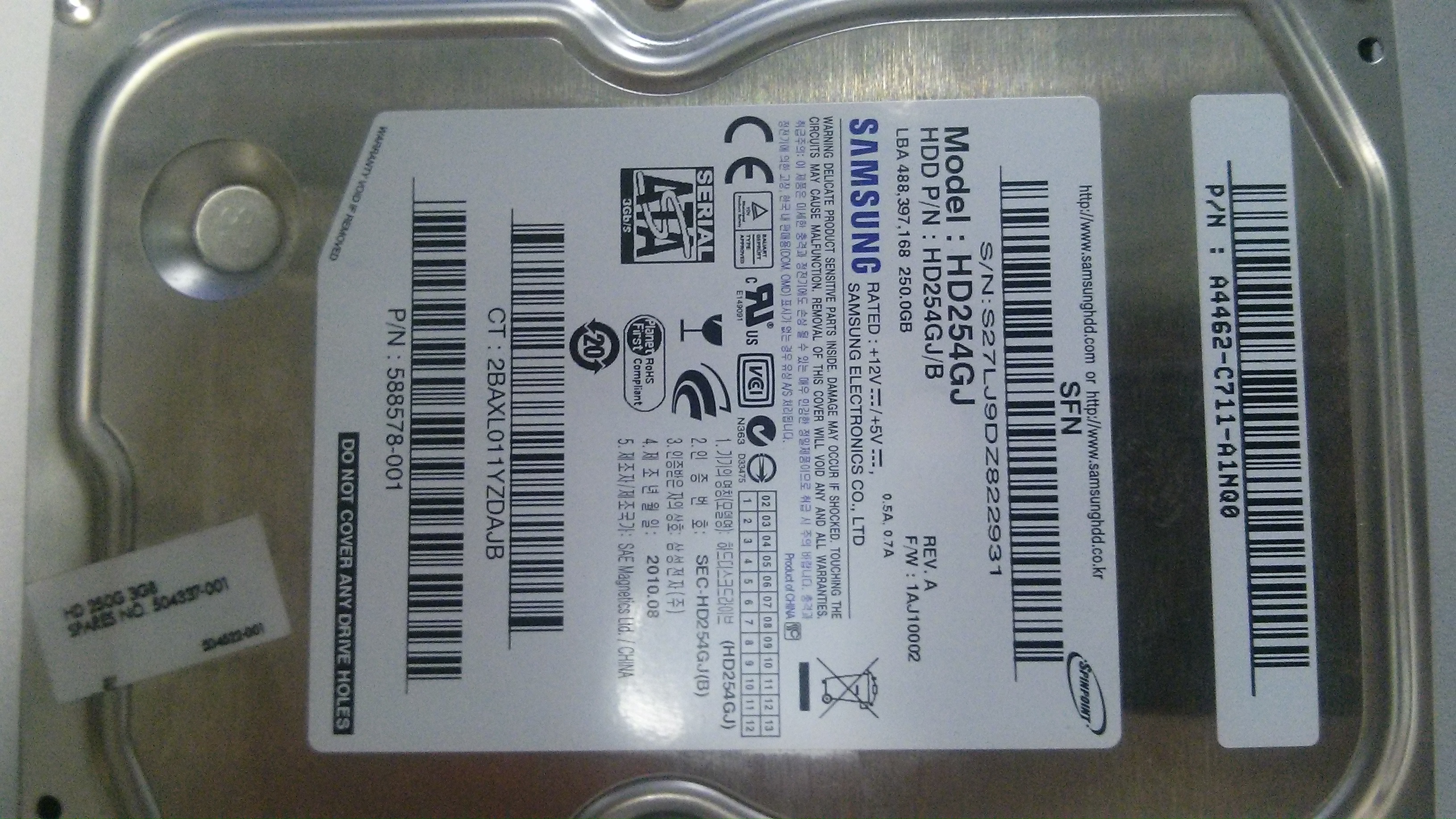

 Post subject: Re: Need ROM Samsung HD254GJ FW 1AJ10002
PostPosted: May 20th, 2015, 9:59
Posts: 1754
Location: Verona, Italy
I don't know which is the rom version, this is the drive label
My firmware database:

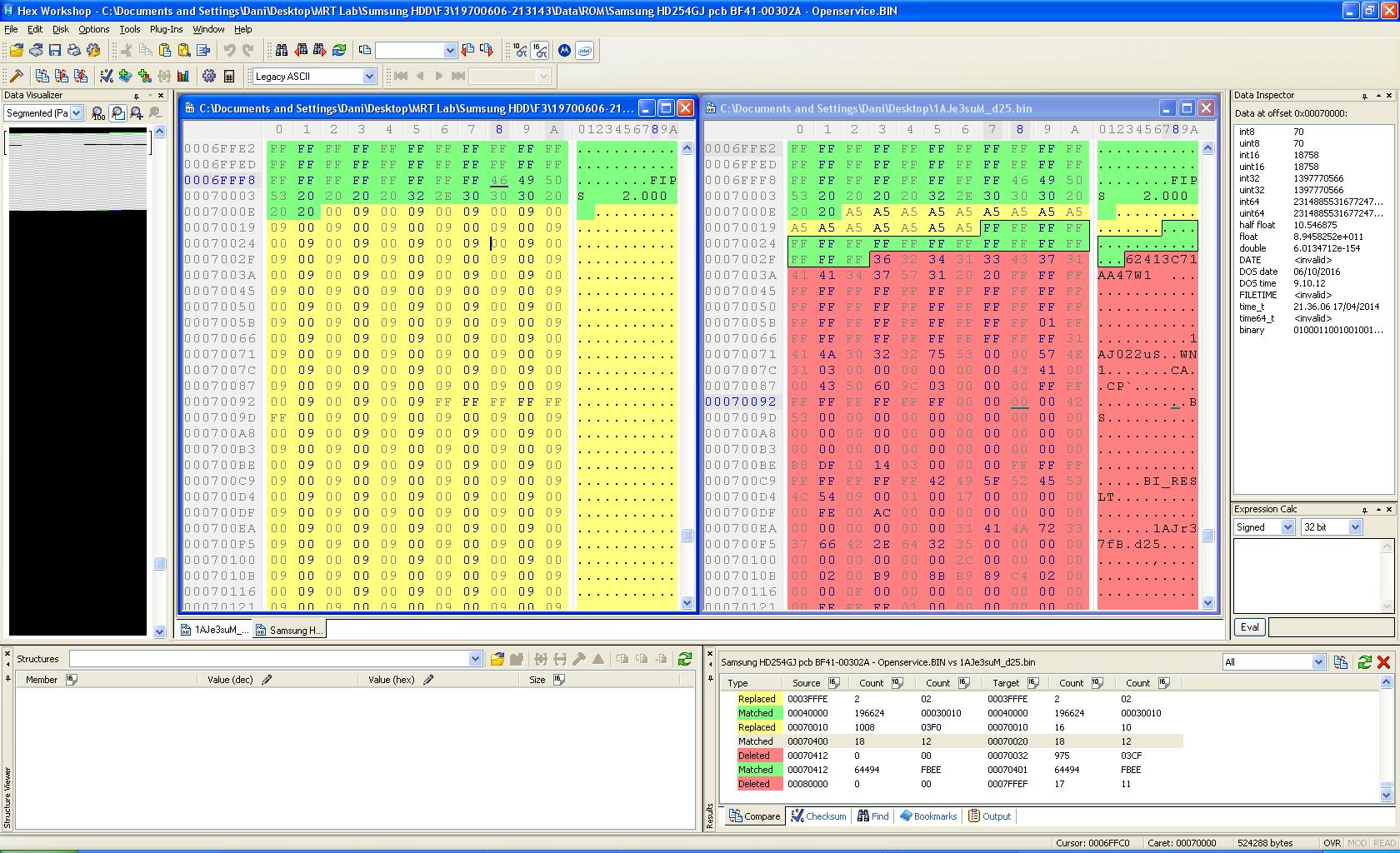

PostPosted: May 20th, 2015, 12:17
Posts: 1754
I compared your rom with mine that i have dumped with eprom programmer.
My ROM:
http://www.mediafire.com/download/01zal ... ba/ROM.rar
As you can see on bottom picture, your rom (on the right) after FIPS 2.000 shows serial number "62413C71AA47W1" and firmware version "1AJ022uS", my rom (on the left) doesn't show those informations after FIPS 2.000
Is this normal?
Does it depends from firmware version or what?
PostPosted: May 20th, 2015, 16:43
Posts: 17228
What is wrong with the original ROM? The checksum for the first 256KB is 0x0000 and the FIPS checksum is also 0x0000.
FWIW, I found the following version strings in your ROM dump:
000263A0  9A 16 00 04 84 FB 07 14 00 00 00 04 31 41 4A 66  š...„û......1AJf
000263B0  33 73 75 5F 38 24 00 04 50 52 00 00 53 41 4D 53  3su_8$..PR..SAMS
000263C0  55 4E 47 20 48 44 35 30 32 48 4A 20 20 20 20 20  UNG HD502HJ
0003E800  46 4C 41 53 48 44 41 54 08 80 FF FF FF FF FF FF  FLASHDAT.€ÿÿÿÿÿÿ
0003E810  31 41 4A 66 33 73 75 5F 01 2E 31 32 35 00 00 00  1AJf3su_..125...
PostPosted: May 20th, 2015, 21:27
Posts: 1754
Ok i guess it's ok, Mikippp said me in PM the same thing. :D
