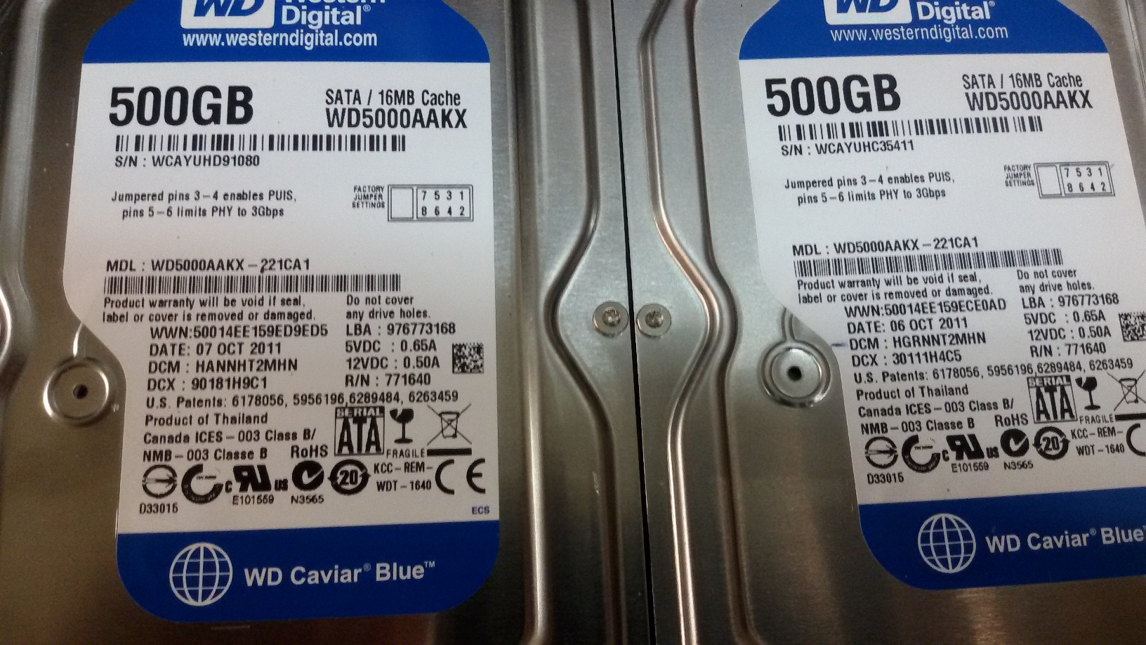

Hello
someone tell me if the HDA of these disks are compatible
DCM is not the same, but date is almost the same
Thanks in advance
 Post subject: Re: WD5000AAKX-221CA1
PostPosted: July 23rd, 2015, 13:02
Even if the DCMs were compatible, there are chances that they may still be incompatible. There is more to the recipe.

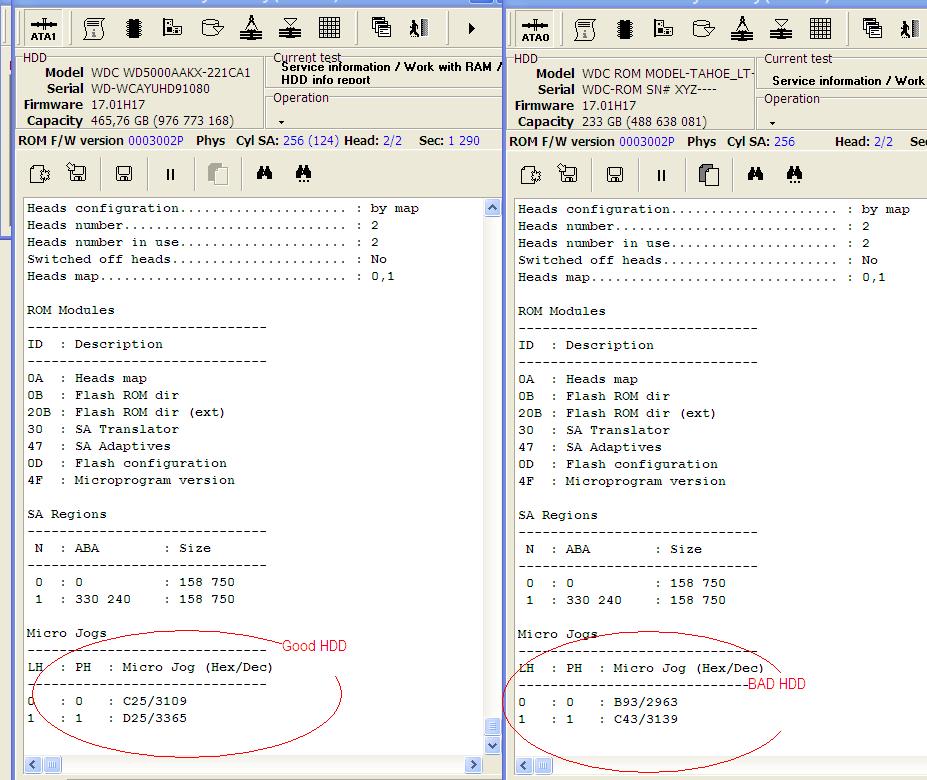

The infos of the HDDs are attached , what about?
PostPosted: July 24th, 2015, 5:57
Posts: 1061
Location: Bangladesh
They should be compatible. You can see
