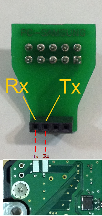

first, Rx goes to Tx, and Tx to Rx
second, PC3K doesn't use GND on the Samsung
third, don't change the the initial settings, (leave it as is, example BPS supposed to be 57600 and not 38400)

It's totally not an obvious question for me, yes the drive was not powered on during this.
After powering on the drive, i was not able to get utility initialization to finish, but i was able to get this terminal readout (which i assume indicates head damage):
..OK : 66
Mind = Blown. Thank you.
Very well i shall loose the alligator clips.
Okay, terminal output from above was made using the default 57600.
I shall try again with the terminal lines swapped around, and post the results here.
 Post subject: Re: How do you connect the terminal to a ST1000LM025?
PostPosted: September 17th, 2015, 1:01
Posts: 4020
getting the readout means you don't need to swap them
PostPosted: September 17th, 2015, 1:21
Joined: August 21st, 2014, 3:29
Posts: 43
Yes i just figured that out. :) COM port failed to recognize the speed or read anything when the lines were swapped.
Can anyone confirm what the terminal readout means?
PostPosted: September 17th, 2015, 1:25
Posts: 1388
Location: isreal
probably heads, try to edit the head map
PostPosted: September 17th, 2015, 1:49
Posts: 43
I wasn't able to get utility to initialize fast enough, and the knocking/rattling sounds are too concerning to leave the drive on for too long.
I am gonna treat this as a heads case and refer to a larger DR centre.
Thanks everyone. :3
PostPosted: September 17th, 2015, 8:43
Posts: 43
Okay acelabs walked me though head map editing, but it turns out this drive does not initialise.
Family selected: M8E 2.5''(SATA)
Data transfer rate detecting
Current COM port data transfer rate..... : 57600 bps
Data transfer rate setup
Reading passport data................... : Short passport reading error; unexpected error: Terminal command error; Terminal is busy
! Modules table used by default
Zone allocated table loading error; Read sector error (Cyl:  0, Head: 3, Sec:  143, Count:   1); Terminal is busy
Zone allocated table not loaded!
Heads number
Value from FIPS module.................. : Error reading FIPS module; Terminal is busy
Value from BRSLT module................. : Read sector error (Cyl:  0, Head: 3, Sec:  112, Count:   1); Terminal is busy
Value from PARAM_DM module.............. : Read sector error (Cyl:  0, Head: 3, Sec:  261, Count:   1); Terminal is busy
Selected value.......................... : 4
Service Area
SA SPT.................................. : 1536
Part number............................. : Read sector error (Cyl:  0, Head: 3, Sec:   92, Count:   1); Terminal is busy
Password info is not loaded............. : Read sector error (Cyl:  0, Head: 3, Sec:  283, Count:   1); Terminal is busy
Burn-In test............................ : Read sector error (Cyl:  0, Head: 3, Sec:  112, Count:   1); Terminal is busy
Error pulse set error; Terminal is busy
Heads 2 and 3 are busted, acelabs then suggested i solder on a SATA port according to the following picture:
https://i.imgur.com/SiDDyop.jpg
Here is the edited image showing how the final COM connection worked.
Another piece of advice acelabs gave me was to invest in some "dupont" connectors so i can avoid soldering next time:
http://www.ebay.com/itm/120pcs-Dupont-Wire-Male-to-Male-Female-to-Female-Male-to-Female-Jumper-Cable-/252003735445
And that is all! Thanks for reading!
PostPosted: September 17th, 2015, 9:25
Posts: 1388
Location: isreal
or you can use a compatible SATA PCB
Be careful not to short anything on the PCB when you do it
