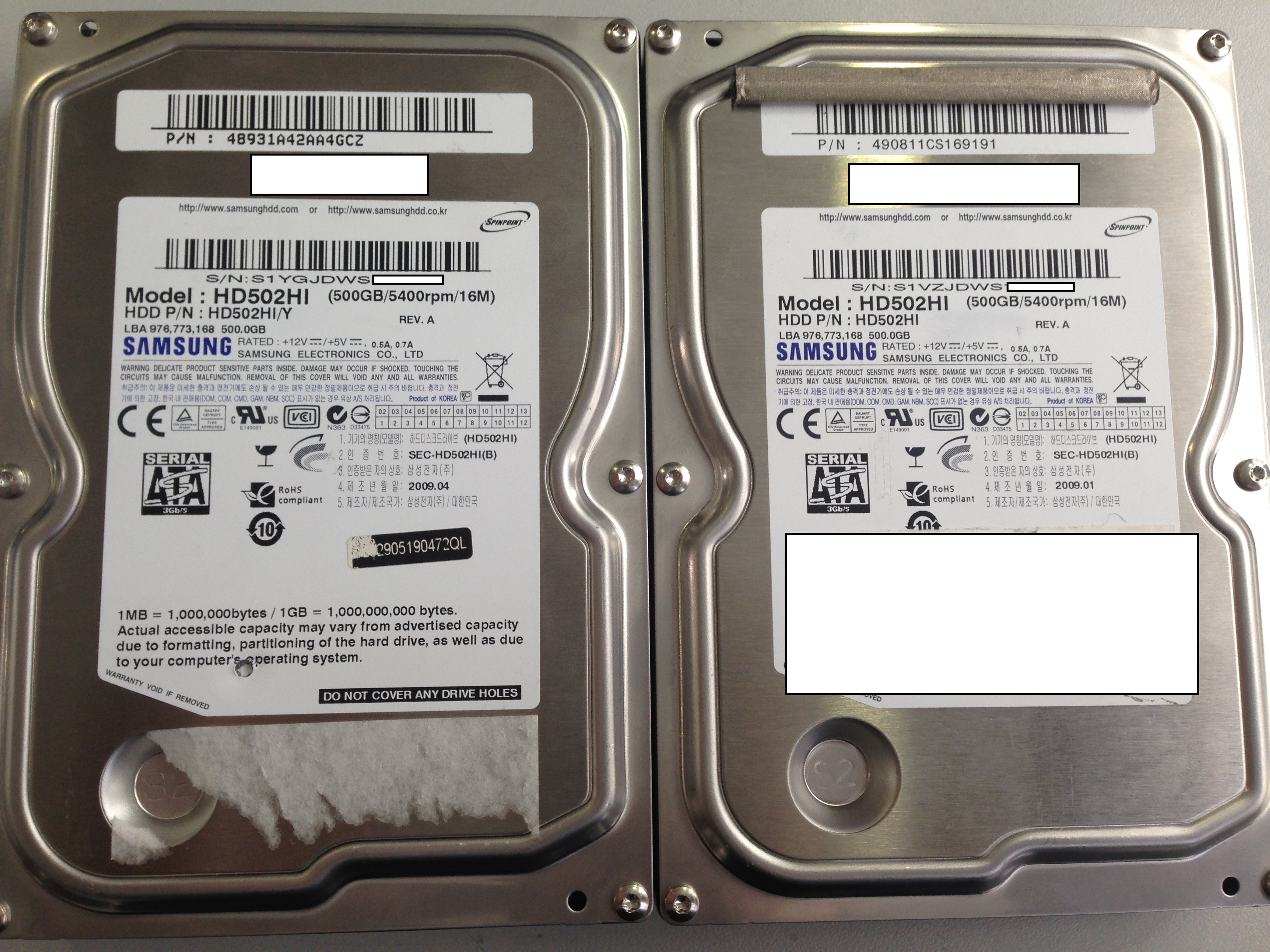

My question and doubts are related to Samsung 3.5 HDDs and the head replacement, not the procedure but the compatibility of donor drives.
I don't have much experience with this drives but ive changed some heads with no succes and i would like to hear or read your experience and we share our experience we might help each other.
In conclusion , we can use this post and gather information about compatibility and head replacement of this kind of drives.
For example i have this drive (picture) and the drive spins up with knocking sounds. Also i cant initialize the drive by changing head map so i believe i need a donor drive because its more likely to be a head stack problem.

Here is my first Example :
In this case the head stack replacement worked.
