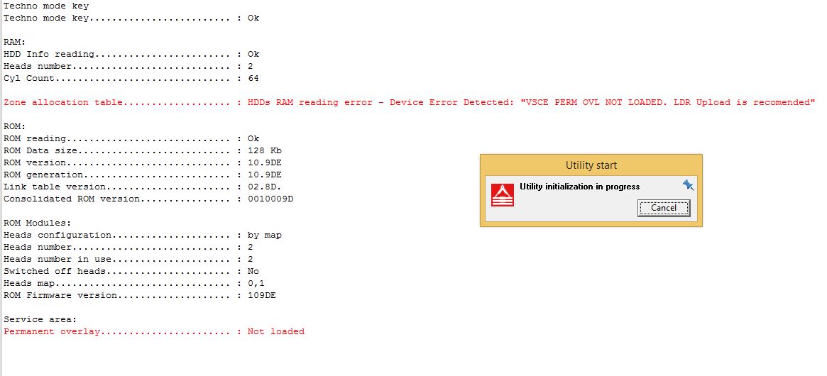

ROM version 10.9DE[

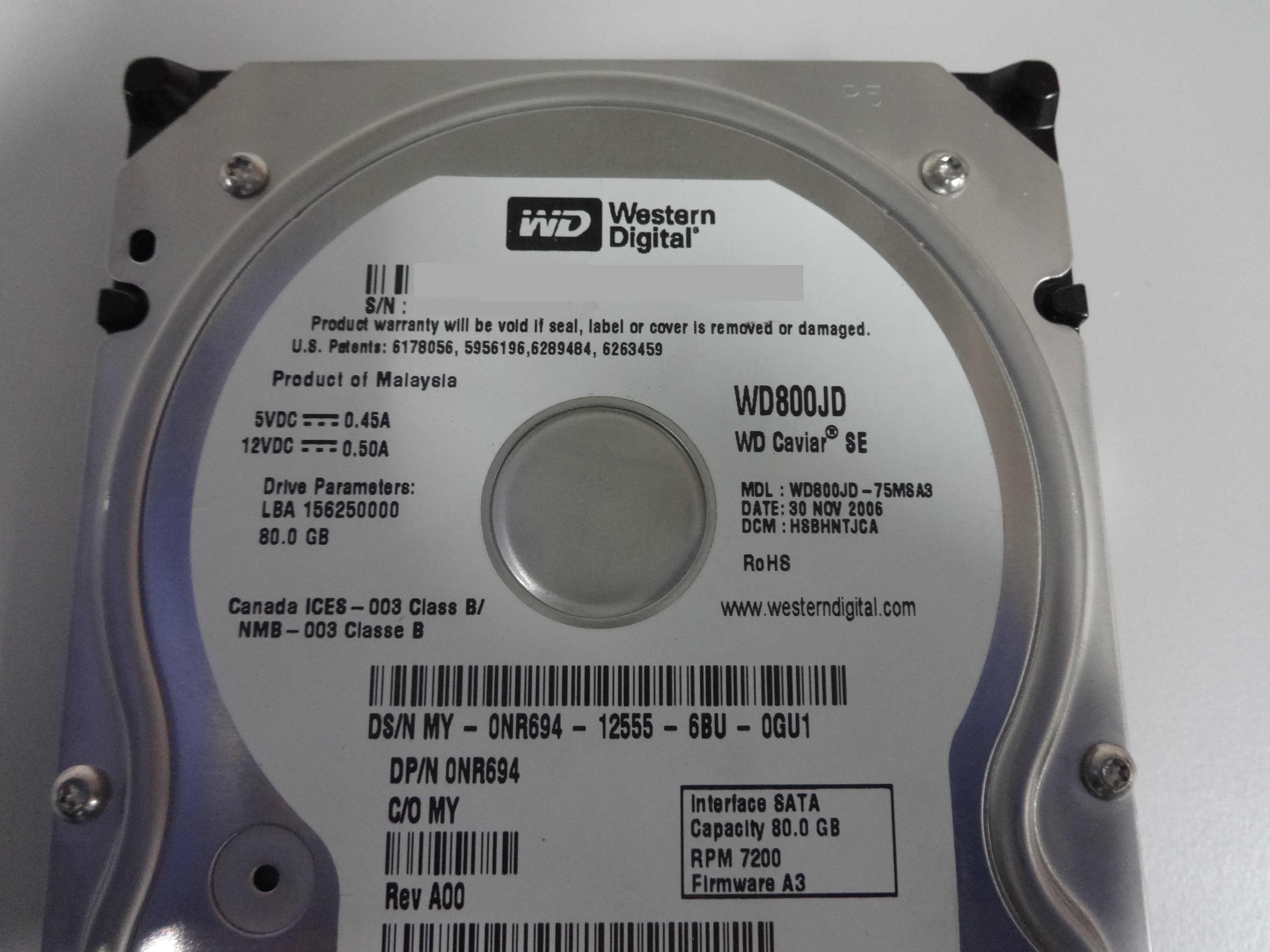

 Post subject: Re: wd800jd-75m8a3 help
PostPosted: November 26th, 2015, 14:19
Seems like typo. Should be "MU", not "M8".

This is the HDD

And another pic...
PostPosted: November 27th, 2015, 6:25
Posts: 2984
Its MSA and its Sabre58 and SPT is 533 - but I suspect you have some mechanical errors you need to resolve first.
