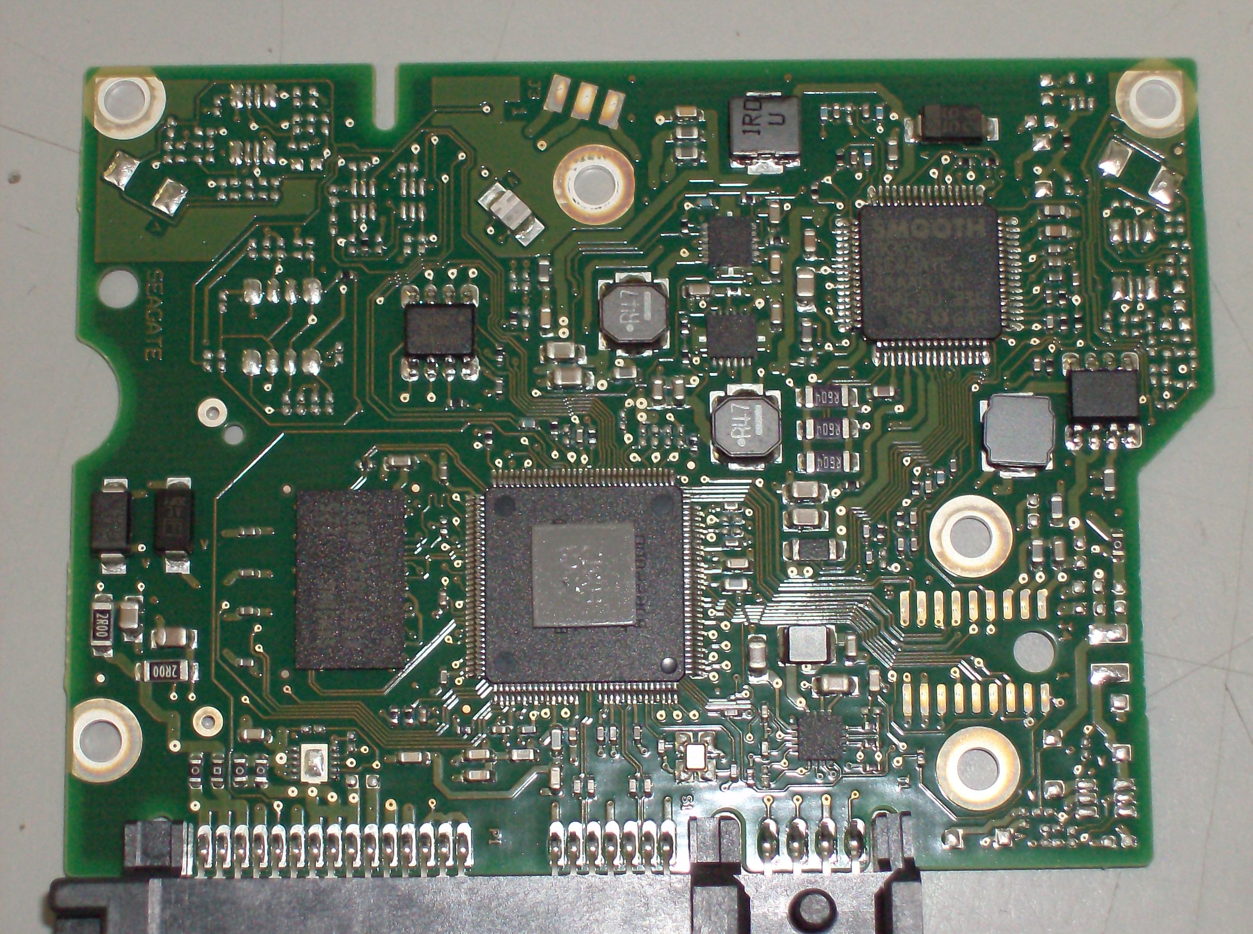

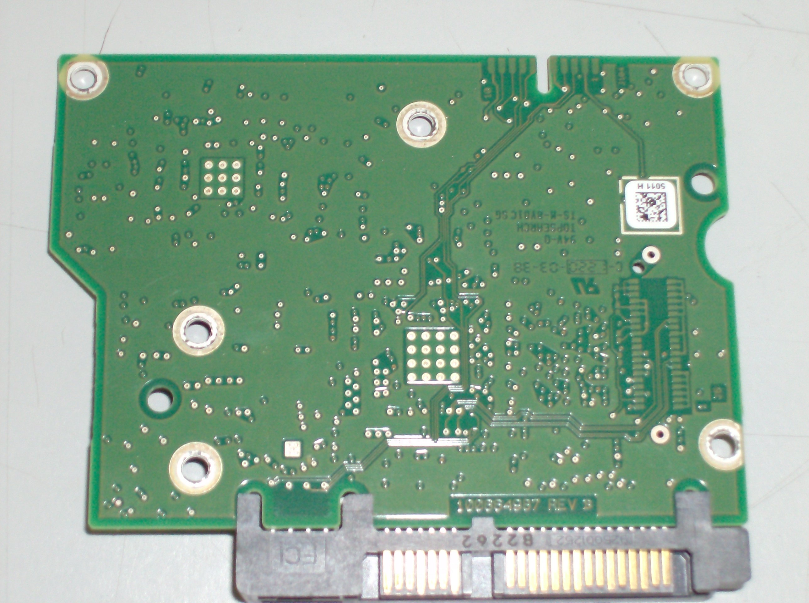

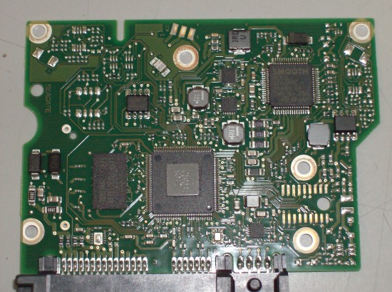

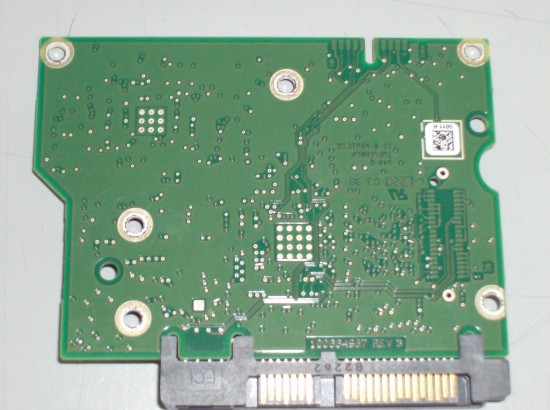

First of all thank you for your help.
Follow PCB image.
Hdd is Seagate ST2000DM001 P/N 9YN164-500 Fw. CC4B
This is Terminal report on Hdd start-up :
Boot 0x40M
Spin Up
TCC-0015[0x00026F7C][0x000273E8][0x00027854]
Trans.
Rst 0x40M
MC Internal LPC Process
Spin Up
TCC-0015
(P) SATA Reset
MCMTFileHandler: EXCEPTION: Failed MCMT read request
MCMainPOR: EXCEPTION: SIM aborted prior to MCMT read
MCMainPOR: EXCEPTION: POR Failed General
MCMainPOR: Feature Disabled...
Thank you again :)

Based on your Log:
some options/features MUST be disabled in SA
cannot do that w/o proper tools with MANUAL editing flags
Symptoms:
hdd BZ then RDY registers with NO SECTORS access, becomes BZ when trying to access sectors
thats all
good luck
