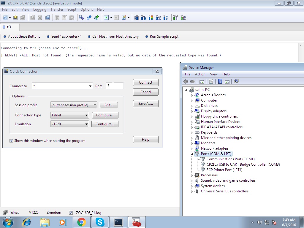

 Post subject: ZOC TERMINAL F3 T>
PostPosted: June 7th, 2016, 5:59
Posts: 184
Location: pakistan
please
need few word
how to get the terminal
please

What are you trying to do?
 Post subject: Re: ZOC TERMINAL F3 T>
PostPosted: June 7th, 2016, 14:09
Posts: 184
Location: pakistan
cant say
but need F3 T>
PostPosted: June 7th, 2016, 14:28
Posts: 17328
Type "localhost" or "serial" in "Connect to" box
Select Serial/Direct as your Connection Type
Configure Connection Type
Override session profile defaults
Select baud rate, etc
Com-Port Scan
Select CP2102 port
OK
Connect
