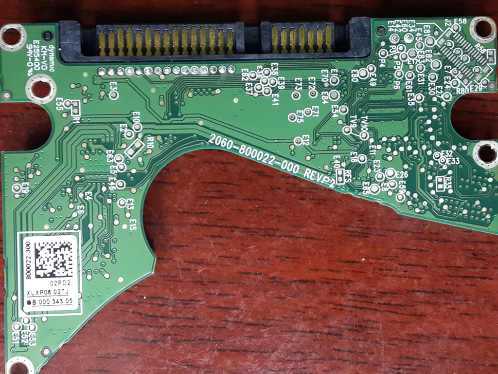

I had WD20NMVW-11C3NS2 with USB Interface PCB 2060-800041. Changed to compatible 2060-800022. After connecting It comes to Ready State but gets to BSY on HDD ID. I Have tried Isolating head contacts from PCB but it remains BSY only.
Please provide Read Channel points which to short to get to SA access.
thank you all

you can try to connect only pcb and block SA access in ROM.

Thanks for quick reply,
Connecting only PCB also remains in BSY state forever.
Attached is PCB image.

You read the ROM in boot ROM mode and block SA manually

Murtazah wrote:
Please provide Read Channel points...
TV9 and TV10 ?
