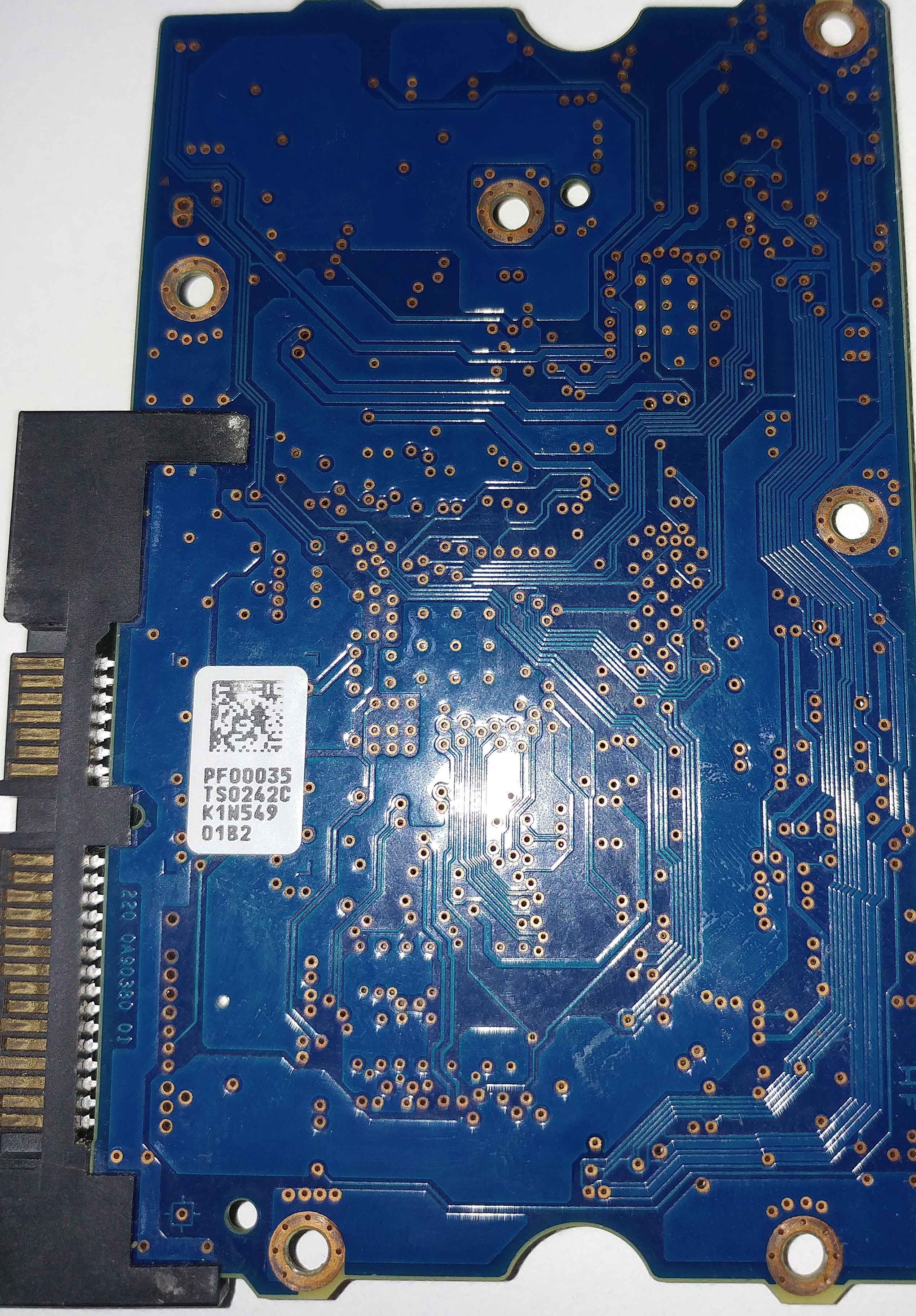

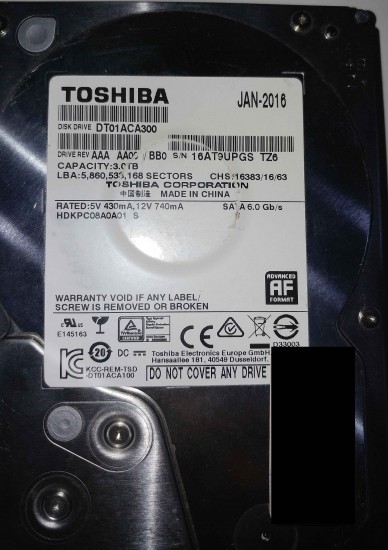

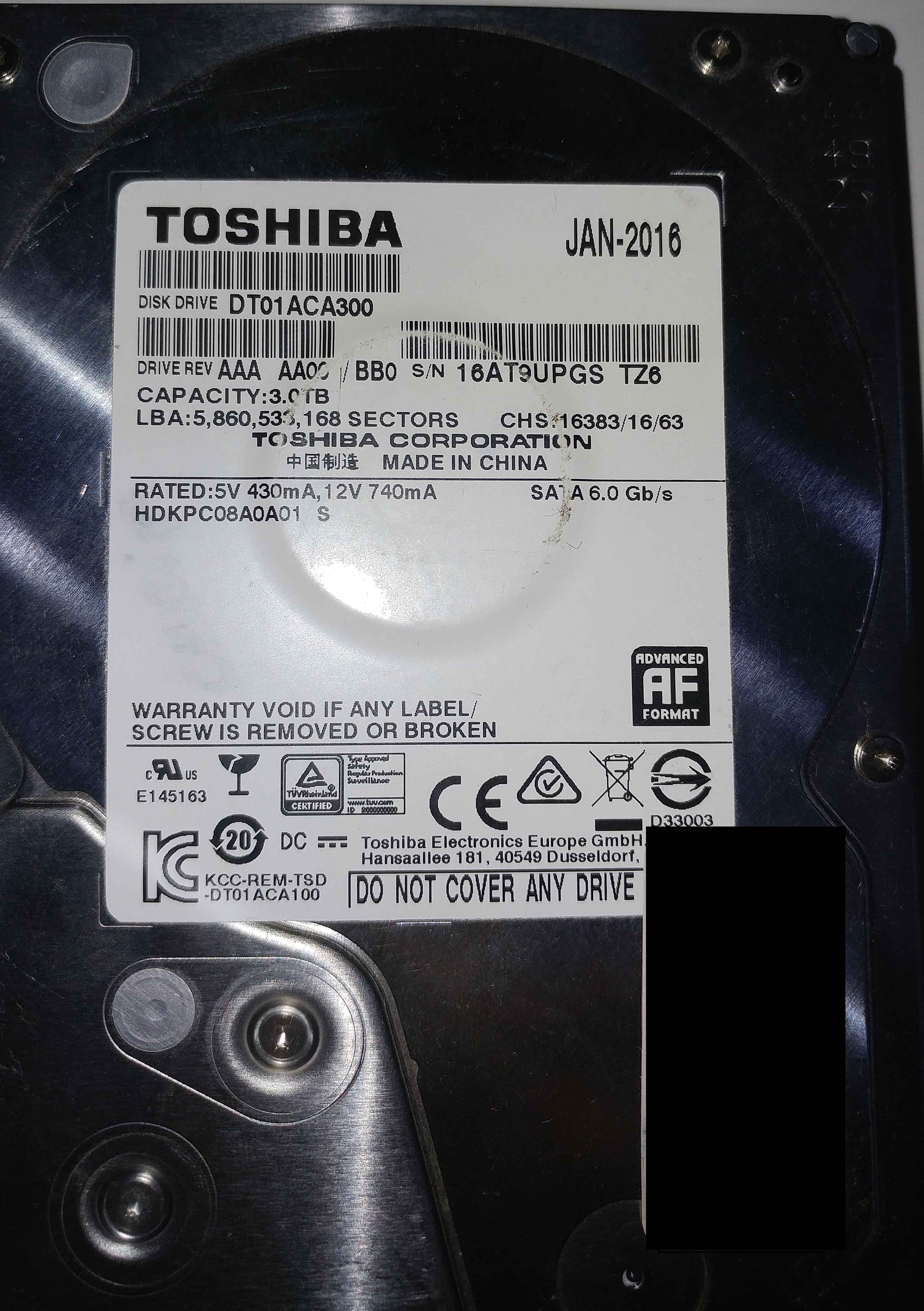

I have a Toshiba DT01ACA3000 (JAN-2016)
PCB Sticker:
PF00035
TS0242C
K1N549
01B2
PCB REF: 220 0A90380 01
I bought a new PCB with REF 220 0A90380 01 (but I don't know the HDD model).
I transferred the ROM but unfortunately, the PCB didn't work.
Could anyone please, tell which parameter have to match between the patient and the donor PCB for that drive.
Thanks in advance.

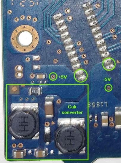

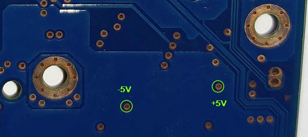

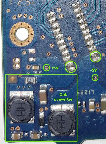

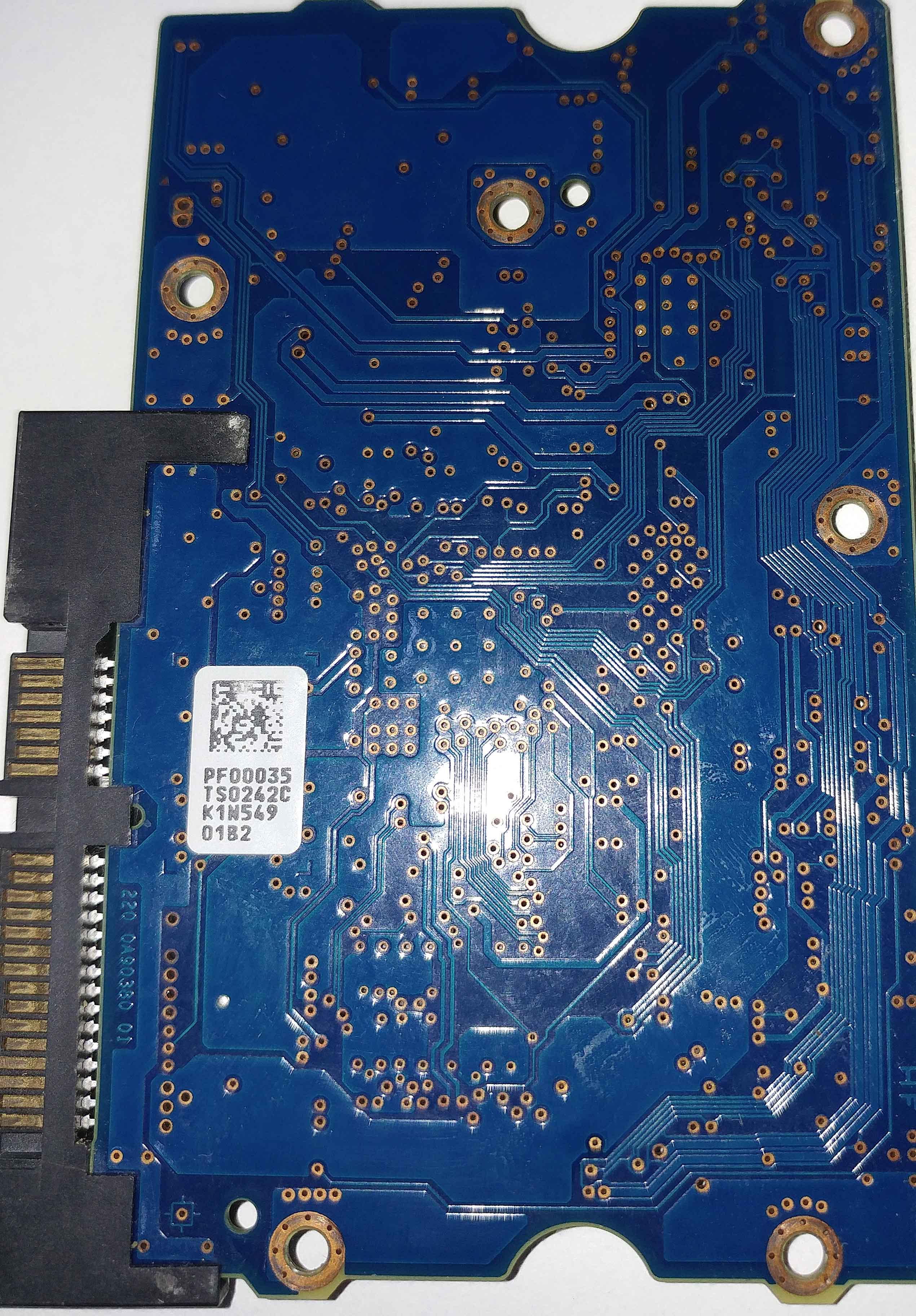

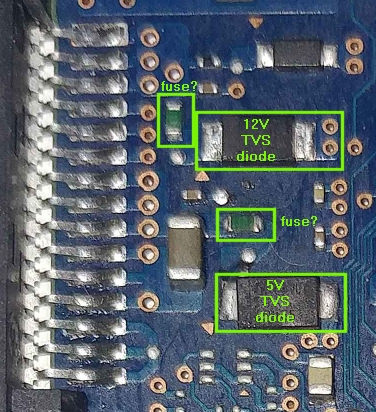

If you upload hires photos of both sides of the PCB, I could show you where to test the preamp.

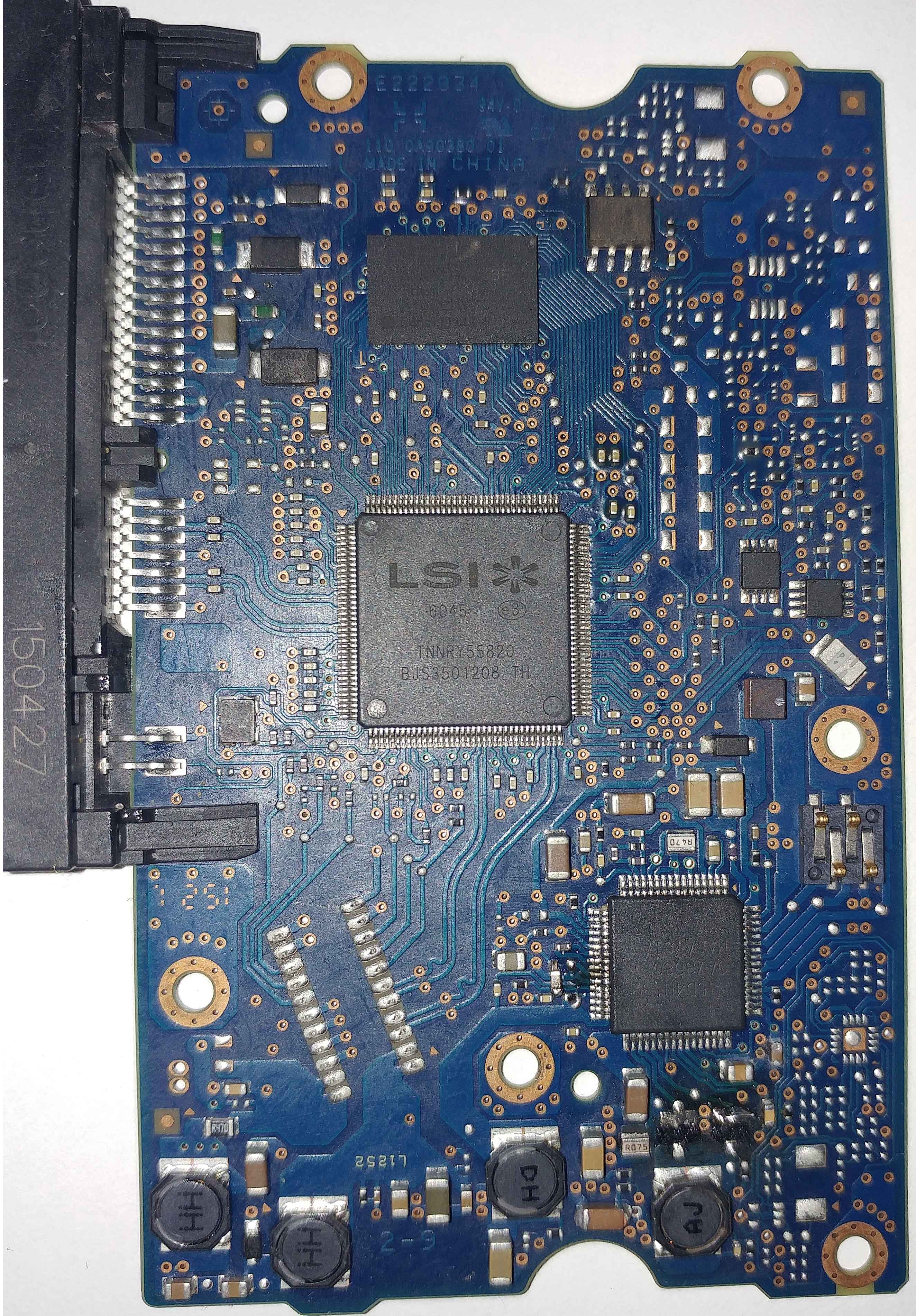

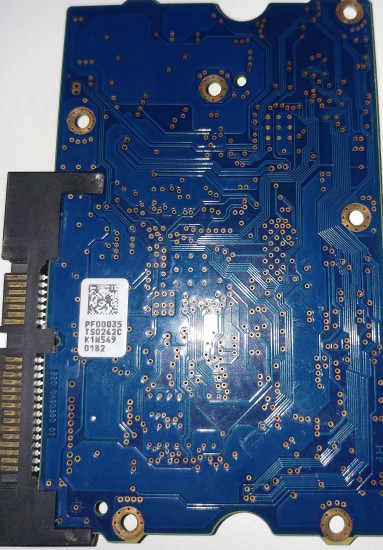

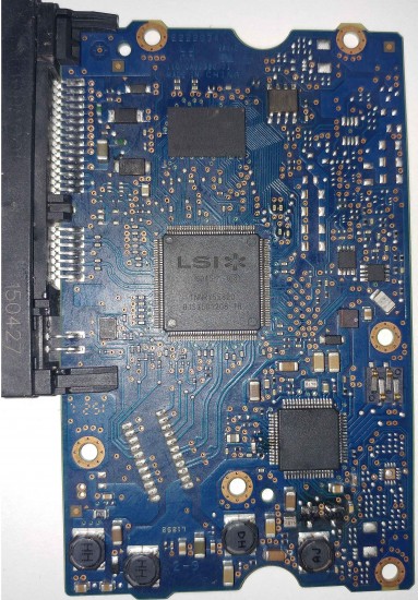

Re: PCB compatibility for TOSHIBA drive
January 30th, 2018, 3:15
see PCB from both sides.

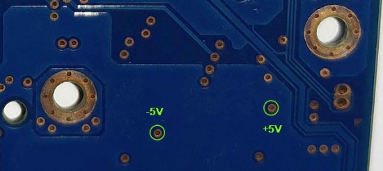

January 30th, 2018, 5:00
I think these are the +/-5V supplies.
You should measure the resistance between ground and each of the +5V and -5V test points. Compare your two drives and PCBs.
AFAICT, there is some damage to the Vcore supply in the photo. Have you tested the TVS diodes and fuses? That should tell you if an overvoltage was to blame.
