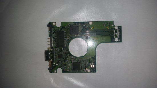

Hi.
I tried to connect this drive in to sata by soldering in to capacitors place but it doesn't worked.
I odered new PCB form aliexpres, i have hotswap chip U14 and U12 to new PCB and now disk is working propetly... i mean the voice of it but OS doesnt see it.
When disk is pluged in to USB diode on PCB is blinking.
Can any one tell my what else i can do with this drive to restore data from it ?

A)1 TB usb 3 2060 771961 001 RevA WD10JMVW 11AJGS1
B)1 TB Sata 2060 771960 000 RevA WD10JPVX 22JC3T0
I replaced B Rom to A usb PCB .
MRT read all modules and ROM over only USB connection to computer. Also read and write module working. And I tried to convert it to sata 771959 pcb. I cannot get modules and rom. But I get them from 771961 usb pcb.
I tried with A original ROM . MRT Not read modules and rom over usb connection
It's very very strange. :shock: :shock: :shock: :shock:
So there must be a way to read WD USB drives modules over usb

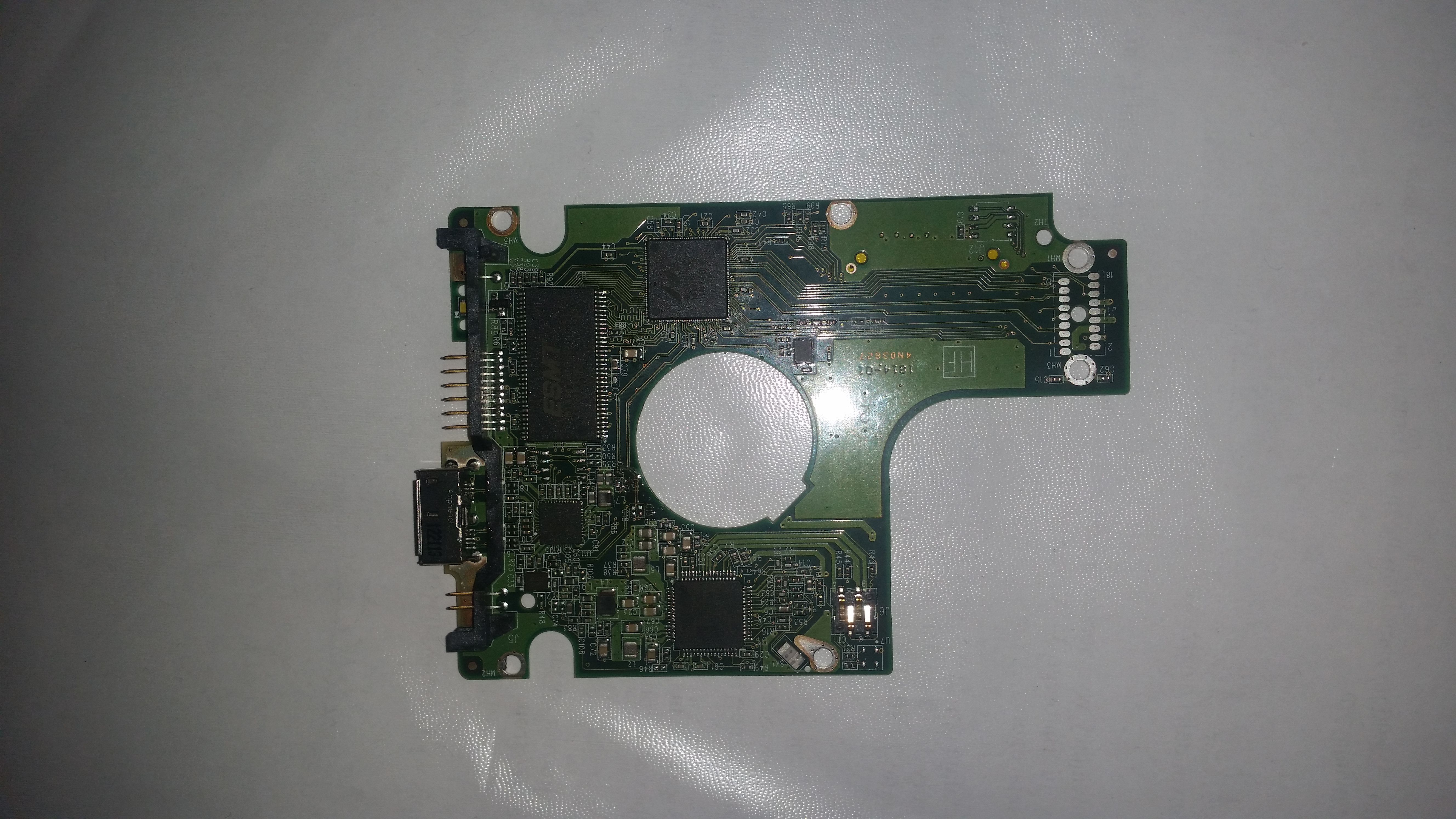

Another case
I replaced A rom to 771959 pcb . In Windows drive seeing raw. But with original USB pcb it look NFTS and normal.
I have backed up rom file. I don't know why there are 2 different rom file in my back up folder. Maybe I get other rom file after some trying . 2 rom files different. I checked it. I use different ROM files in this case. I ll try with same ROM file .
But I don't understand why windows see RAW .

And another case.
Sometimes hdd gone .
1) I used MRT WD section to write A ROM to 771959 pcb. Rom died.
Zone table error . Mod 2 or mod 3 error .I can read Modules with usb . But cannot read with sata . And Again I Delsoldered chip. Rewrite rom with MRT eprom card. And hdd again turned normal.
2)- I tried to change settings "Enable Cache" in logic scan screen.
Rom died.
In both case
Delsoldered U12 . Used MRT eprom card. Cheked Rom full FFFFFF . I deleted rom. Writed backup rom file to U12 chip. And soldered again. It works again.
