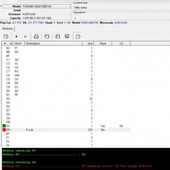

Hi to all!
Is Data Recovery...
is backup all modules only CP DD is bad!
Is CP DD is bad!
how to fix? (without losing the data)
PC EXPRESS

Are you not reading anything in DE ? Try reading using the utility. I don't think the MQ01 are SMR but I'm sure someone will correct me if it is and if that is the case you're really going to need the p-list.
Thanks reply!
It sees data but is very slow and stops reading all the time.

What's the g-list like? Sometimes slow data is better than no data. If it's tripping into errors reading but picks up after a reset try reading without udma. Slower again but may be more stable.

MQ01 is not SMR.
you can probably read by util without plist, albeit with shifts. Wondering if it reads anything useful when it reads slowly...

@sempre, can you read the tracks in this model? Can you do a partial read of CP DDh?
If you can at least read the important sectors in this CP, I believe I could write a dd script to remove the shifts in the clone.

Thanks All helps!
Solved!
Closed!
