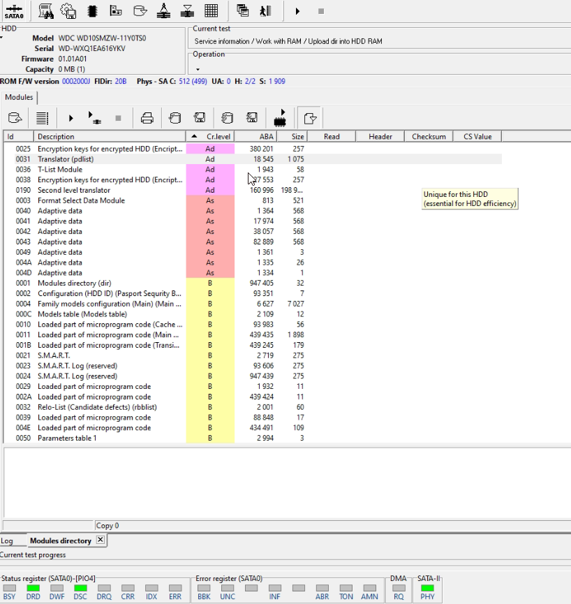

Hi
Going back to this case:
I can already have access to SA, but LBA is 0, I can't reach UA.
All modules are read OK. Any hints?

When all sectors are zero, than there seems to be an issue with smr translator.
What was the problem with this drive / what did you exactly do?!
 Post subject: Re: Palmer resources 0002000J
PostPosted: October 30th, 2021, 21:37
He didn't say the sectors were zero, he's saying that the max LBA was returned as 0 (which you can see from that picture).
What happens when you read modules by ID rather than by ABA? I've seen cases where they could read by ABA but not by ID.

Does this mean that the drive is reporting a capacity of 1 LBA?
Capacity: 0 MB (1)
If so, is this normal for these types of firmware faults, or do faulty drives normally report 0 MB (0)?

What happens if you try to edit 02 ?

Hii Everyone .
I am Also Facing Same Issue , at Start The Drive doesn't IDs itself.
1 Disable 411 Module .
2 Load LDR
After loading LDR, It IDs Perfectly and SA is also accessible (read/Write Working), But it Shows capacity 0 .
No User Data Access.
What is the issue here ?
