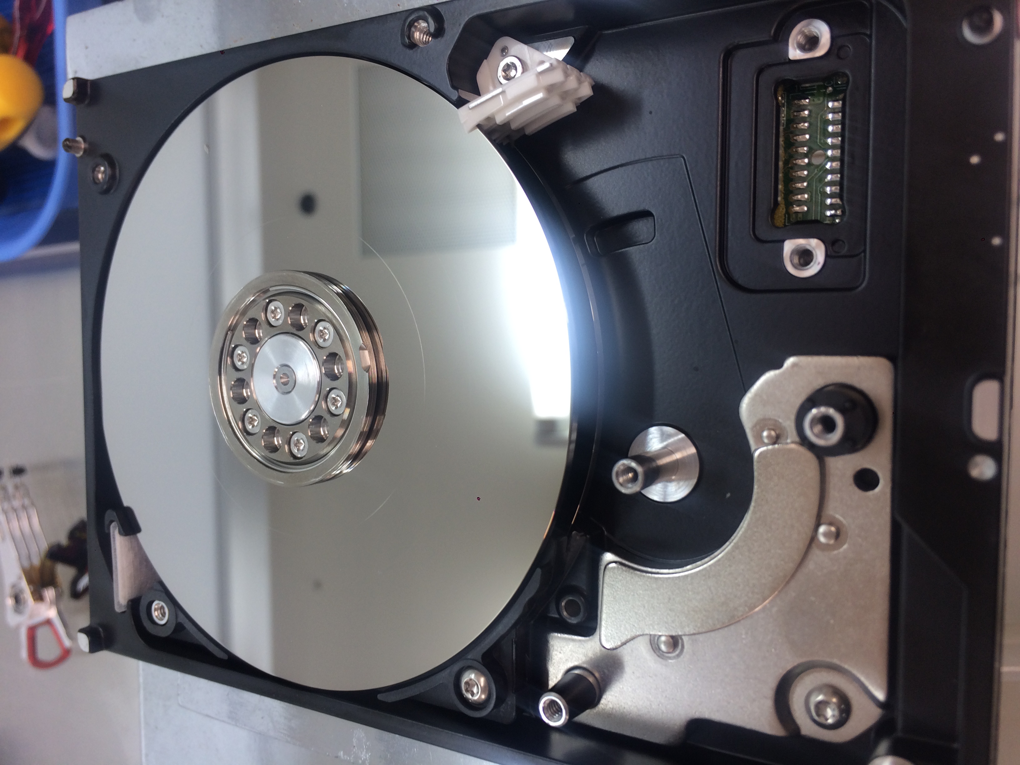

 Post subject: WD20EZRZ-22Z5HB0 LDR file needed
PostPosted: November 28th, 2021, 22:49
Joined: November 28th, 2021, 22:35
Posts: 162

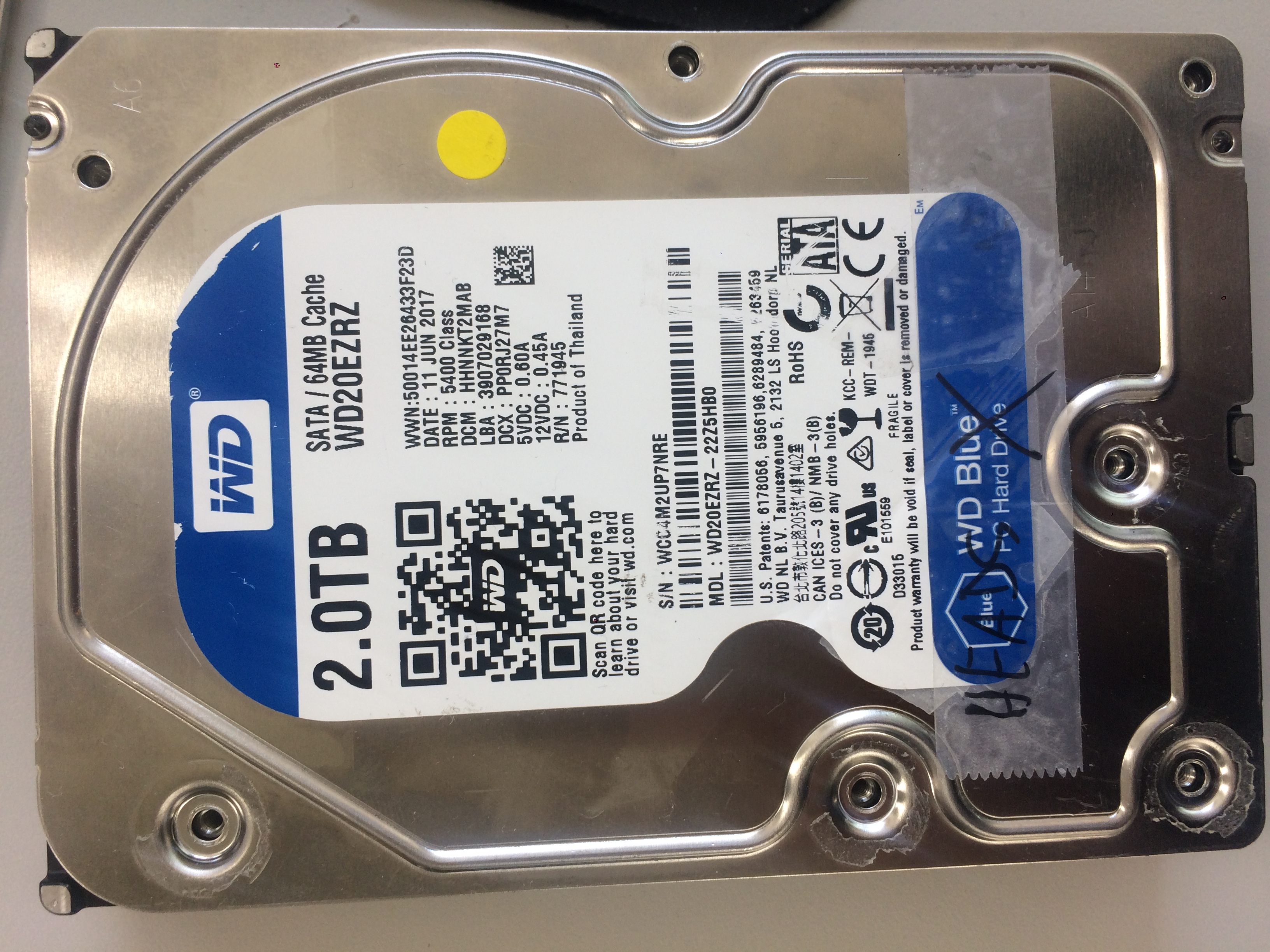

Location: japan
hello can somebody provide the LDR file and modules for this hdd?
MDL : WD20EZRZ-22Z5HB0
DMC : HHNNKT2CAB
i can give a small donation for your help^^

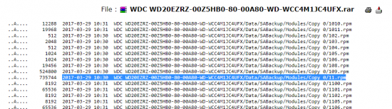

 Post subject: Re: WD20EZRZ-22Z5HB0 LDR file needed
PostPosted: December 1st, 2021, 4:06
Joined: March 6th, 2010, 3:46
Posts: 627
Location: Kolding | Denmark
There are 001500B in the Diablo 3S section here http://files.hddguru.com/download/PC-30 ... ablo%203S/
Digitalsupport Data Recovery
https://digitalsupport.dk
PostPosted: December 1st, 2021, 4:53
Posts: 162
Location: japan
digisupport thank you for your answer. i got the rom from HDDGURU but unfortunatelly no LDR file :( :( :( :(
PostPosted: December 1st, 2021, 5:03
Posts: 3551
Here you go:
15000B Diablo 3S WD20EZRZ-00Z5HB0.zip [19.96 MiB]
Downloaded 662 times

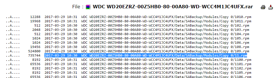

PostPosted: December 1st, 2021, 8:24
Posts: 627
Use the one from Northwind ^^^^ or the one I uploaded this morning :)
PostPosted: December 2nd, 2021, 4:32
Posts: 3551
From your picture, it looks like the drive has been opened.
Did you open it?
Did you maintain clean room conditions?
What did you see inside?
What was the drive behavior before you opened it?
Do tell. Don't be shy.

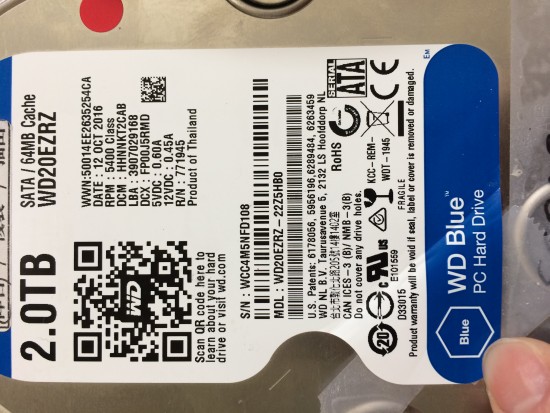

Adding to northwind's questions.
What's the history on the drive.
What was it doing originally.
Can you post a picture of the donor label.

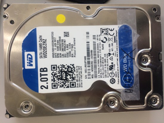

PostPosted: December 2nd, 2021, 21:28
Posts: 162
Location: japan
Guys your answer are really really kind. as you know many people doesnt want to share their experience .so i feel lucky when you give me an answer thank you very much for your patience :D .
according to customer the HDD tarted to make weird sound. i thought bad heads so i prefer to do not power on in order to avoid more damage,
and ta daaaaan platter sratches.
the rotation of the motor made the top ring scratch with the cover surface of the HDD.. part of the surface turned like a orange peel.
and then while rotating went on the heads and then scratches.....
sorry for my bad english. im not native speaker
the donor heads seems compatible. iw as confident.... but after i tested on the patient. heads stop to work .
maybe broken due of the scratches on the platters....... i guess
PostPosted: December 2nd, 2021, 21:44
Posts: 162
Location: japan

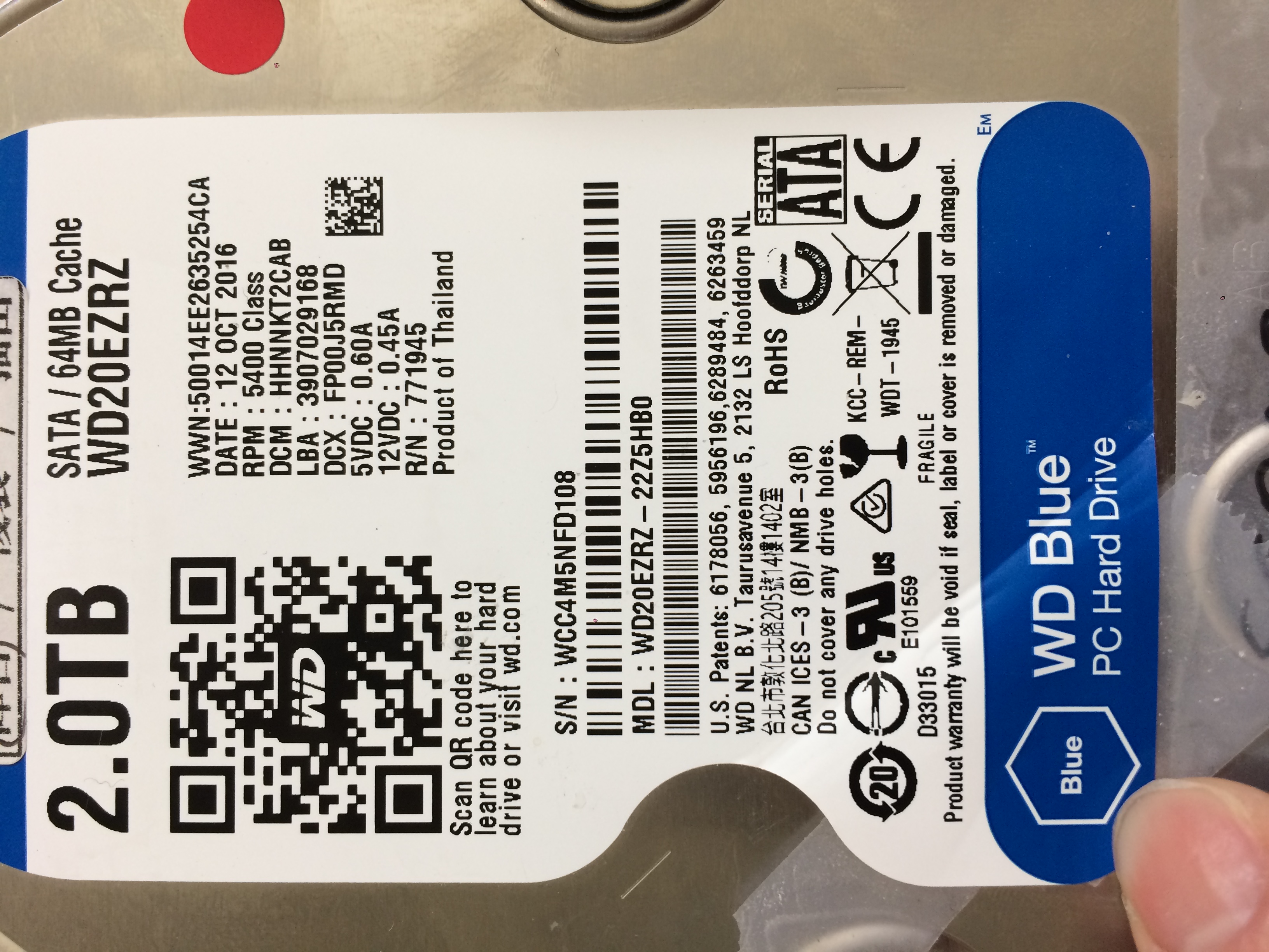

this is the DONOR drive

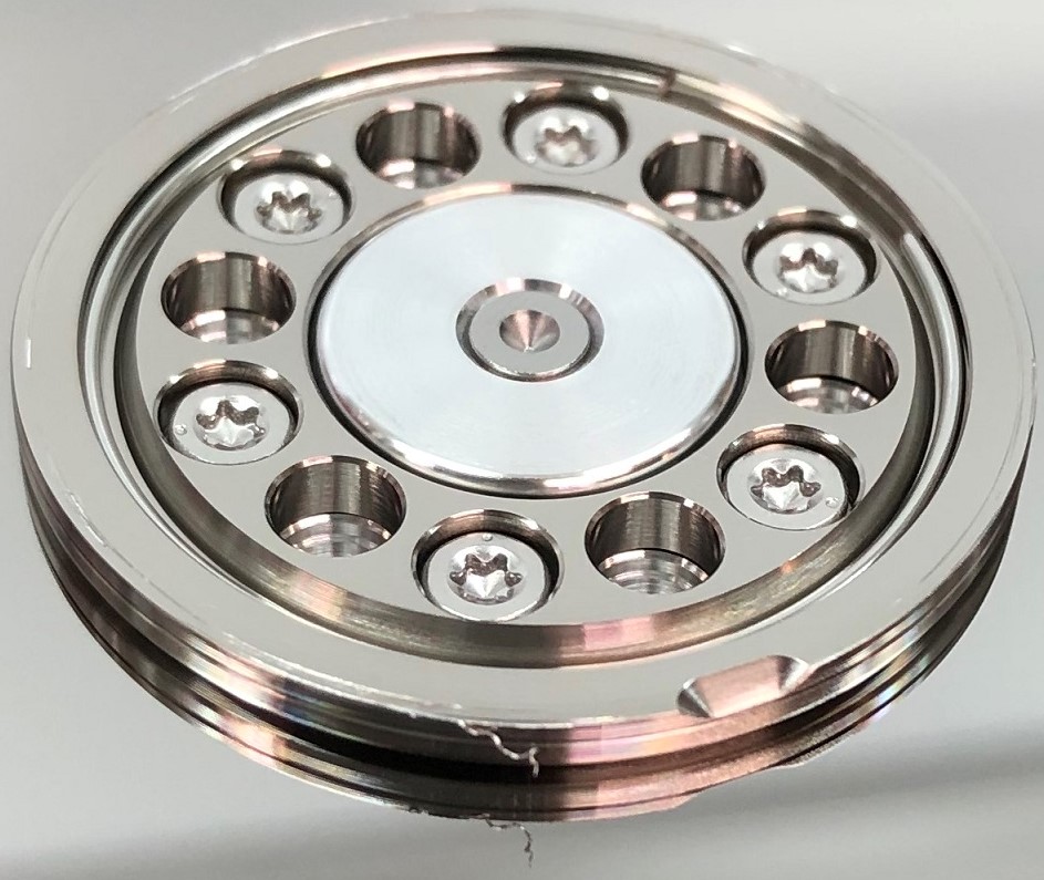

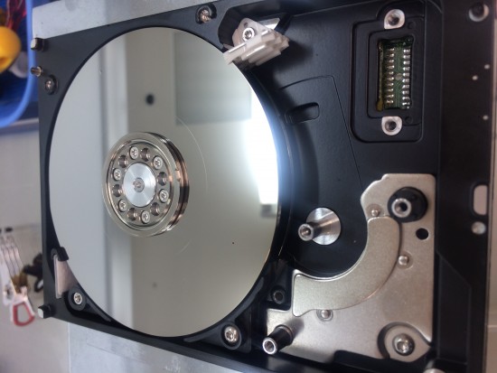

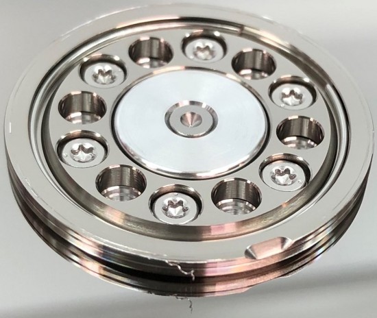

PostPosted: December 2nd, 2021, 22:19
Posts: 162
Location: japan
here the photo of the ring peel and scratches :( :( :( :( :( :(
PostPosted: December 3rd, 2021, 4:37
Posts: 1321
I'd call those are scores rather than scratches. If you have a green light and tilt the drive I think you'll find the top surface will look like someone has been ice skating on it.
Assuming there's no physical damage to the top cover.
The centre ring damage was probably caused by the head arm contacting it.
Heads won't be able to track past the scores or defect.
The defect looks like a head was stuck and then ripped off.
As I understand your response, you have tried putting the heads back in the donor and they now don't work, they have probably been damaged on the patient. Did the original HSA have any physical damage or heads missing?
Options now are limited, you will need to check the other platter surfaces for damage and contamination before anything else. Unless the client is very serious and accepts the risks/probabilities about their recovery I hate to say it but it may be best to stop at this point.
PostPosted: December 3rd, 2021, 4:46
Posts: 3551
Yeah, it doesn't look good at all.
I think this drive needs to be disassembled to have other surfaces inspected; based on that, it will be either unrecoverable or if other surfaces look good, then a partial recovery might be possible. I wouldn't hold my breath, though.
By the way, I've never seen the washer getting peeled off like this.
