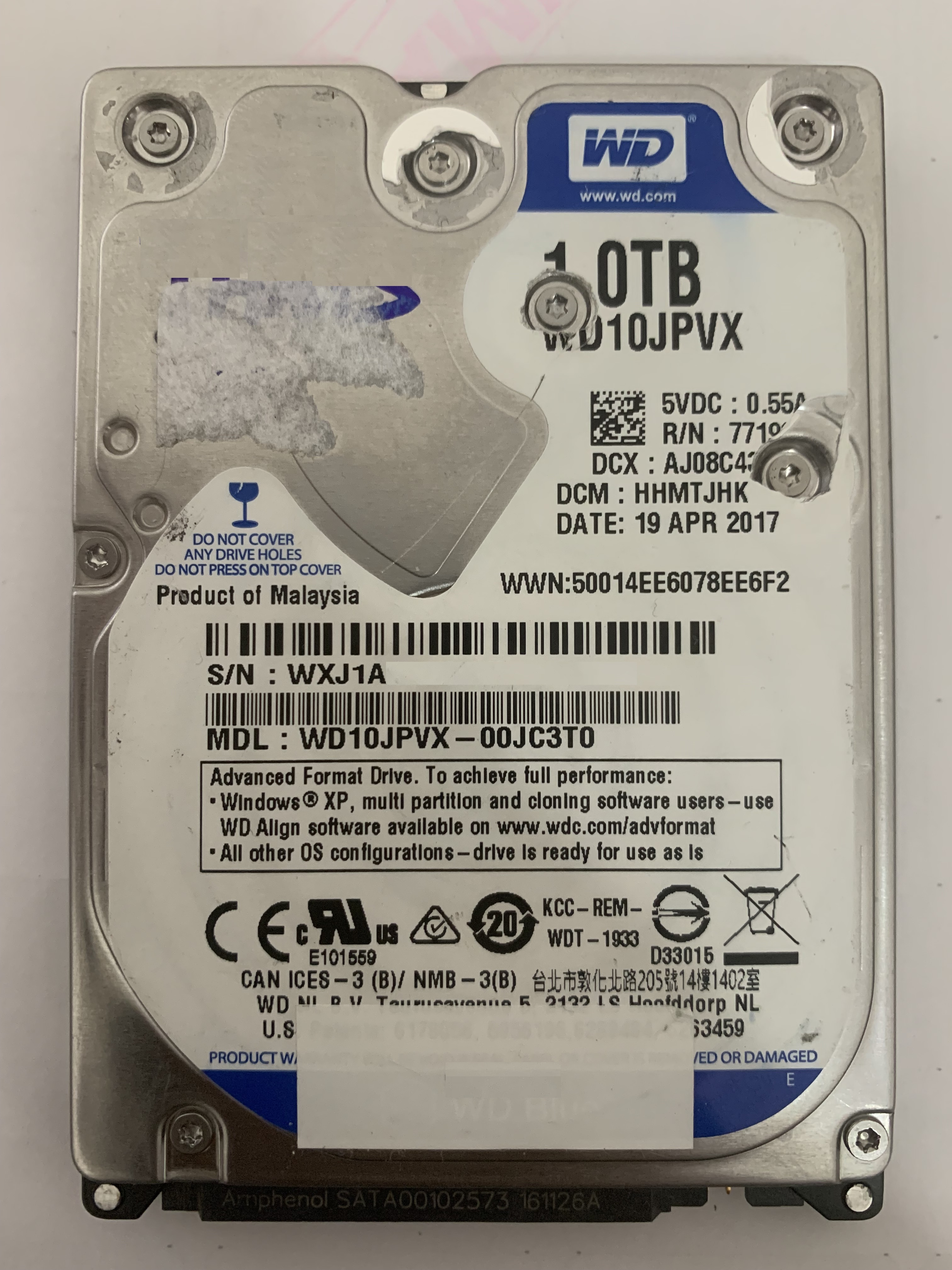

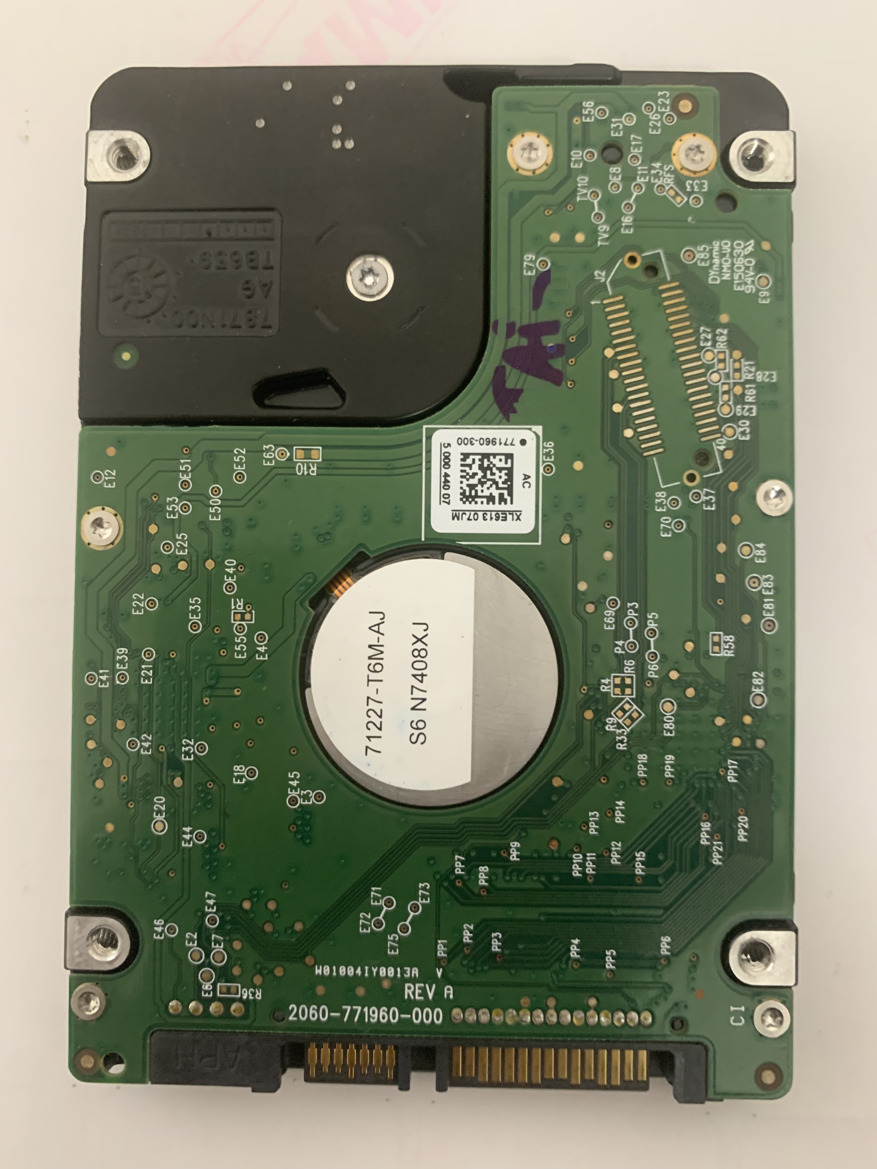

Hello to everyone
The last week in my job we received a WD10JPVX-00JC3T0 with the pcb changed. We talked with the acelab technical support and they told us the FBLite firmware is very complex and for the moment it's not possible to rebuild the rom with the firmware. Despite what acelab told me, has anyone achieved a rom regeneration in this family.
thanks very much and my best regards

Is this one of those models where ROM module 0x4F is "unique"?
https://forum.hddguru.com/viewtopic.php?f=24&t=37795
I was told (via PM) that if you disturb the adaptive parameters for head #0 on a working drive by as little as 2 points, the SA becomes inaccessible. This suggests that the adaptives are very sensitive. I haven't tried this for myself, though.
Yes, it is possible in many cases.
I could do it, pepe can do it even better than myself.
