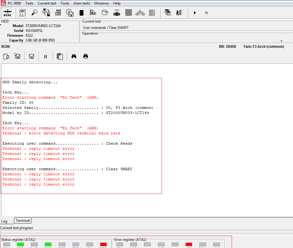

I have a 2 TB Seagate Hard Drive . I want to recover my data but an error accrued.
Error is : ABR
Please guide me what type of error and what is the solution.

I am a new User in Pc-3000
Please Guide me how to find out why its abort.
Please find attachment

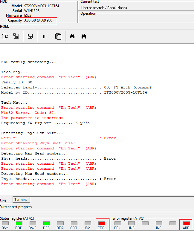

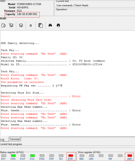

Yes it clicks 2 or 3 times ,then spinning stop
I am also trying to test heads

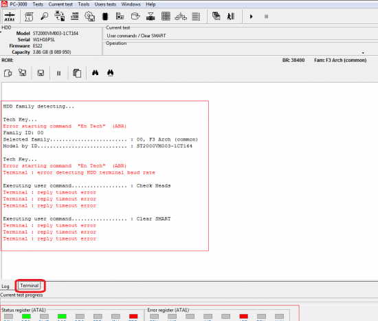

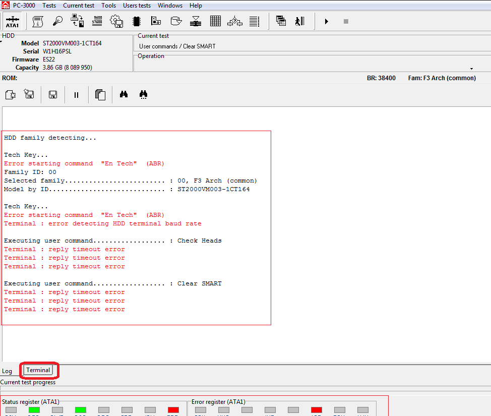

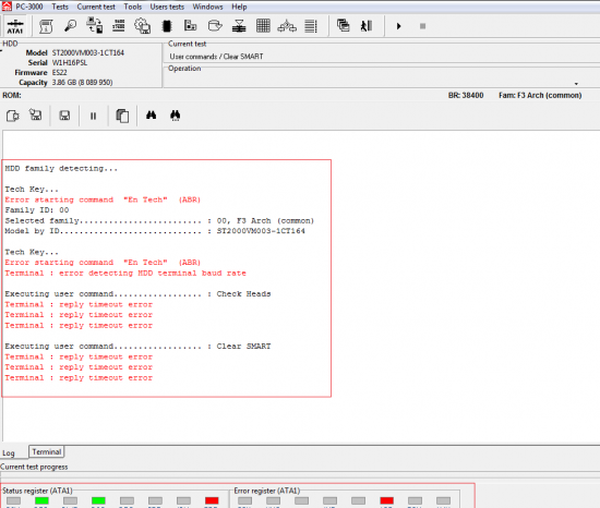

Check messages in terminal.
Your drive has head failure.
1. It clicks and shuts down - head failure
2. Its not reading the SA - head failure
3. Its reporting 4GB which is just from the PCB - head failure.

Moreover, it is Bacall family, so need to unlock it to be able to access firmware or anything.
But in the current state unlocking does not take you anywhere, you need to treat the head failure first of all.
As the others, i would also welcome a terminal log.

Plus, I would first check if PCB is native.
DO NOT power up the drive anymore.
And, the drive needs to be opened in a Clean Room and inspected for MD.
If I remember right, Bacalls are prone to taking platters with them when heads die.
