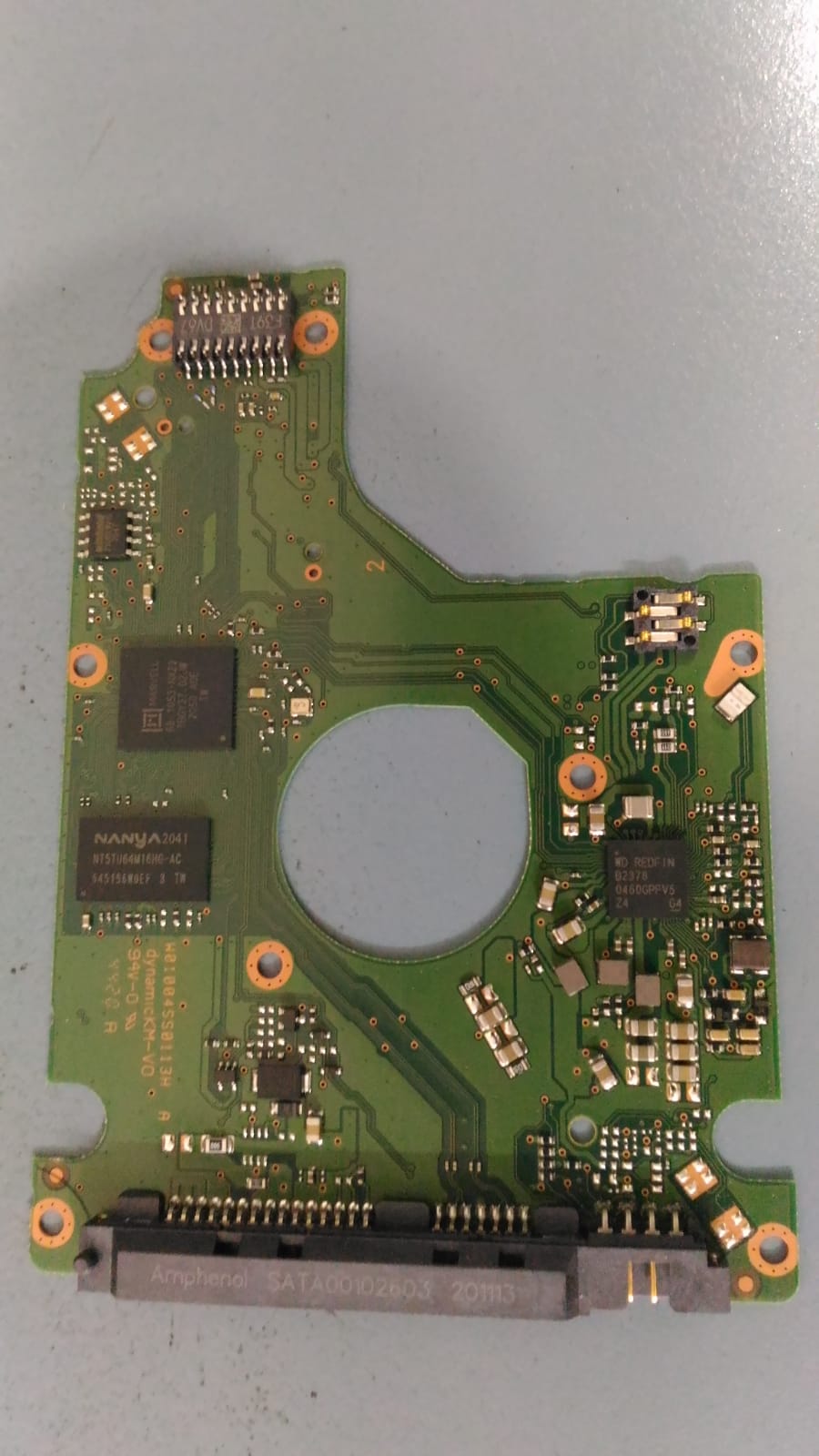

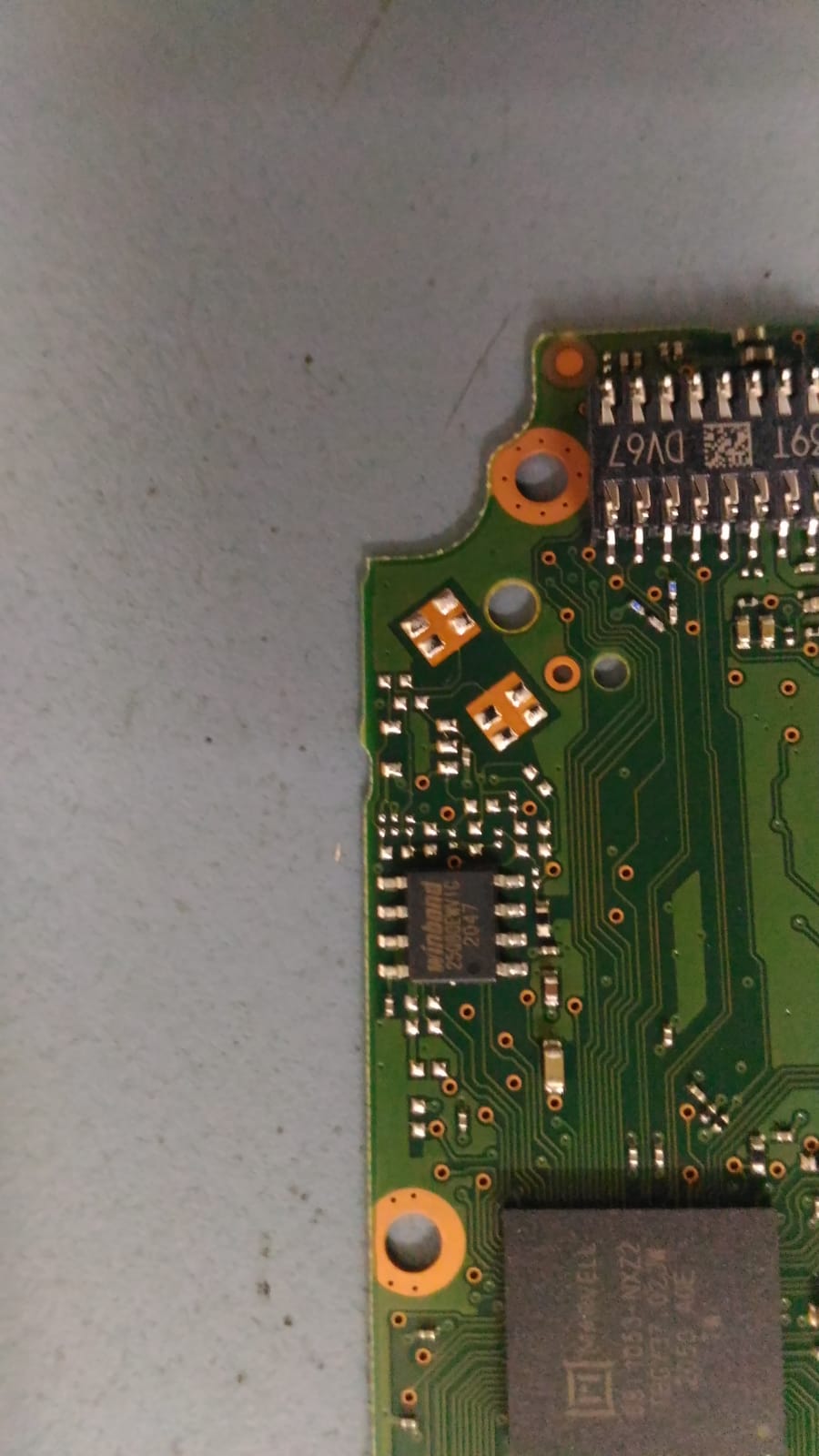

I have got this WD10SPZX-60Z10T0 SED drive.
Its showing SED drive locked everywhere.
I have updated UDMA having support for decryption without unlocked pcb. However this is my first decryption case.
How can I go ahead.
 Post subject: Re: WD10SPZX-60Z10T0 FW 04.01AD4 DOM 22 JAN 2021 SED reco
PostPosted: July 6th, 2022, 1:18
Posts: 411
Location: Romania
Read Rom with programmer, unlock, write Rom back and you will have SA access.

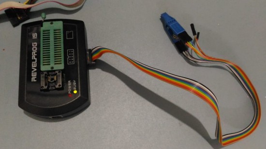

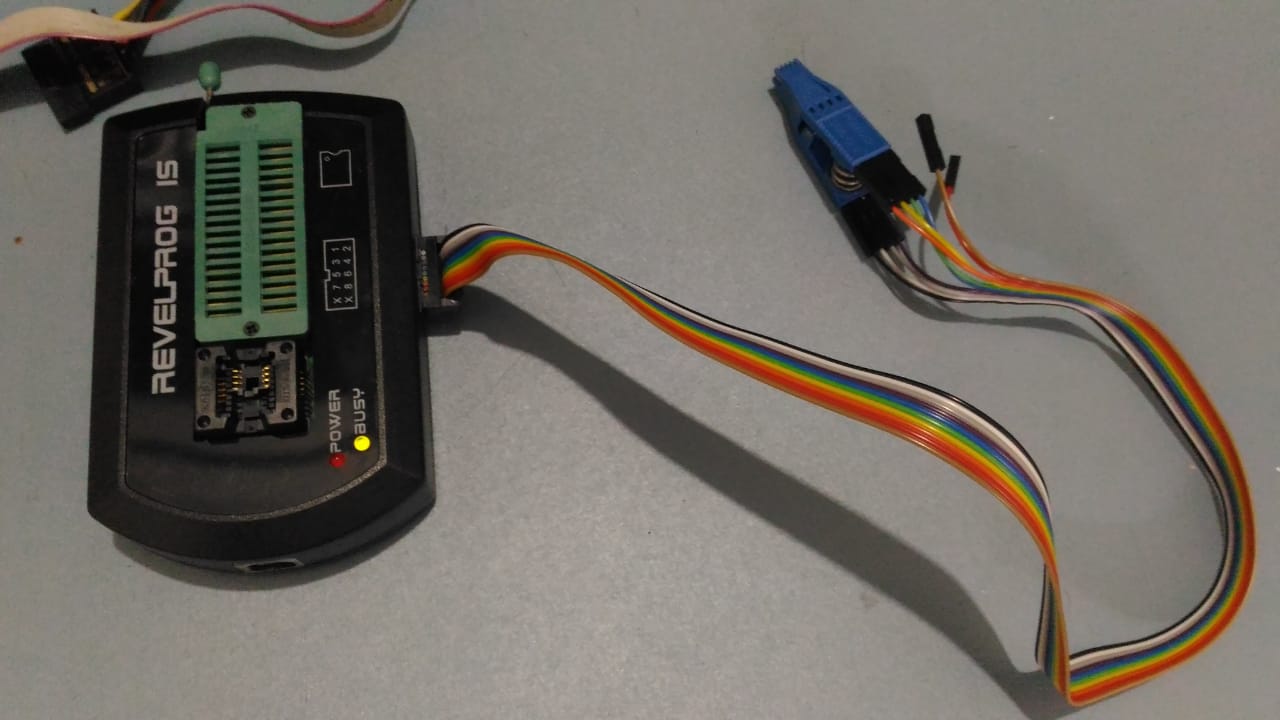

northwind wrote:
https://youtu.be/znNgJkqJYrw?t=550
Thanks a lot northwind , Lardman & CCC for all the help.
I am sure with all this information and your help , I will succeed in this recovery.

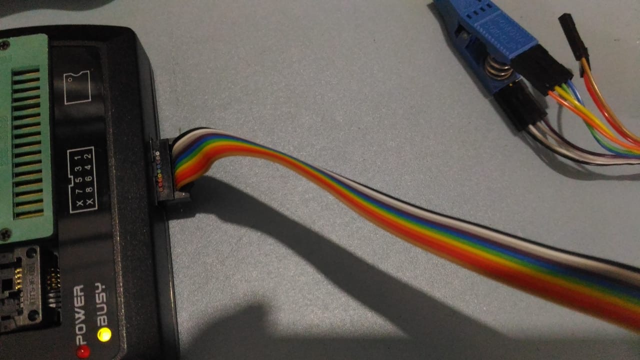

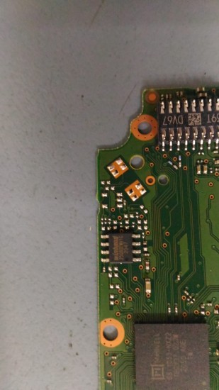

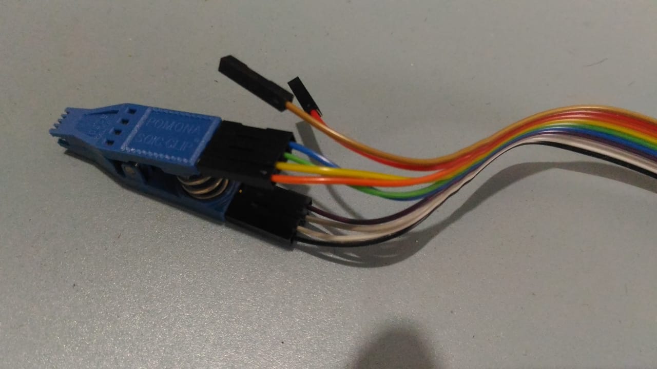

Main challenge for me now is to read Rom carefully from this 2.5" SATA hard disk.
I have brought Revelprog IS with POMONA clips couple of years back but not been able to read a single rom :(

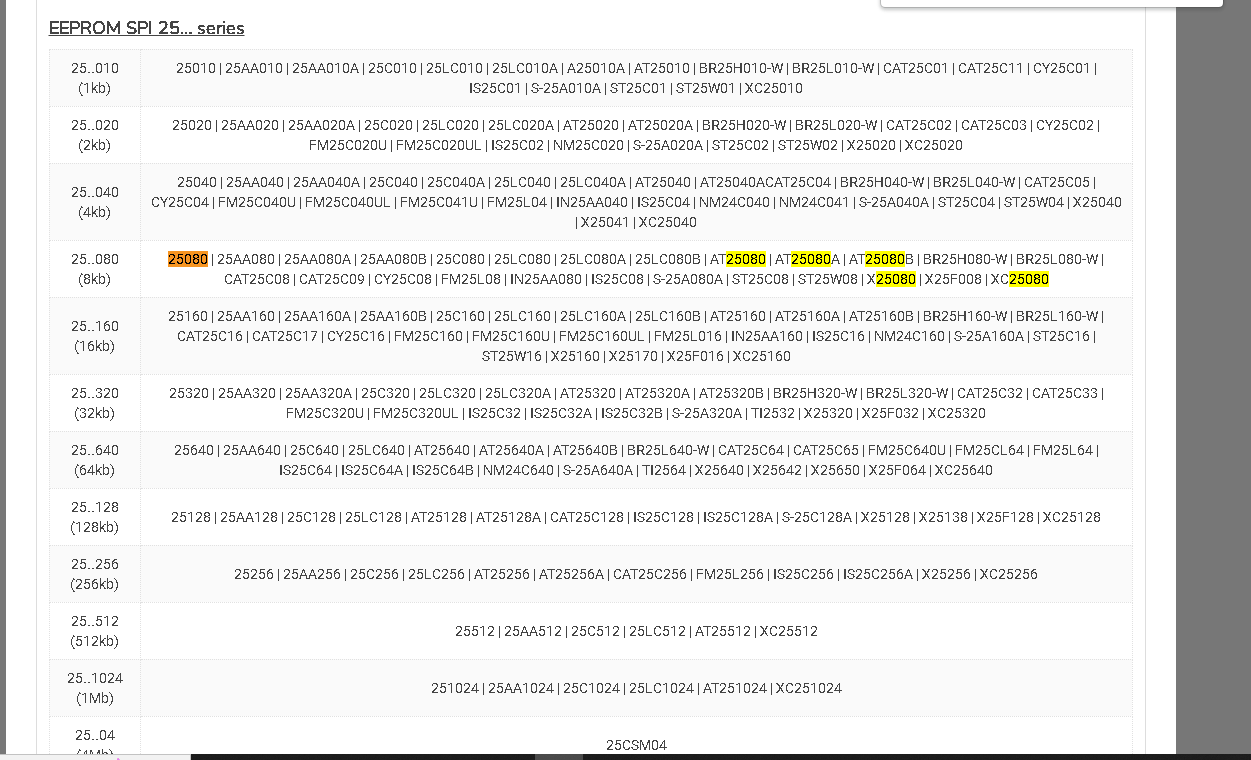

I am not sure about connection to clips. Though this is advanced programmer sound knowledge of chips ,there voltage is must which I am lacking.
I have tried to read rom from desktop pcb's but each time programmer give overvoltage alert. File which was read was different than rom read using pc3000.
I have also found chip no. and family selection is revelprog is not matching, So I have given up chip reading altogether.
Somehow I will manage to read rom from one of my expert friend , hope further process will not be so hard.
Thanks again.

Have been using Revelprog IS for reading ROMs on all types of drives, read / write directly from ROM on pcb.
Select the correct chip, read or write, never failed. I use the ZIF connector, never tried ICSP connector.

25Q80EW on 1,8V
there are those who can read crookedly at low speeds, and some at no

Forget the clip - just take the chip off and put in the socket.
I wasn't overly impressed with the revelprog software or the way to select chips (it expects you to know what you're doing :lol: ) I suspect a great deal of my frustration was because I was used to just pressing ID and then read in Colibri.

If you're reading devices in-circuit, then you need some manual control over the voltage. You're 2.5V device may be able to handle 3.3V, but other chips on the same supply rail may not like it.

Cool.
The Ponoma clips don't work well.
The Pogo adapter is a little better.

labtech wrote:
Cool.
I have same experience. Each time I get different reading. I have heard about POGO , Is it worth to try ?
Actually I want to read rom in circuit in order to avoid chip damage in desoldering and for some on site cases.
Somehow it did not work.

If you could squint looking at how the pins grabs the chip, you will see that the Ponoma does not really grab the pins well, or at all.
Pogo works better, but still has issues sometimes.
