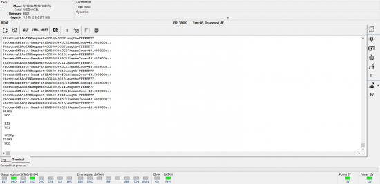

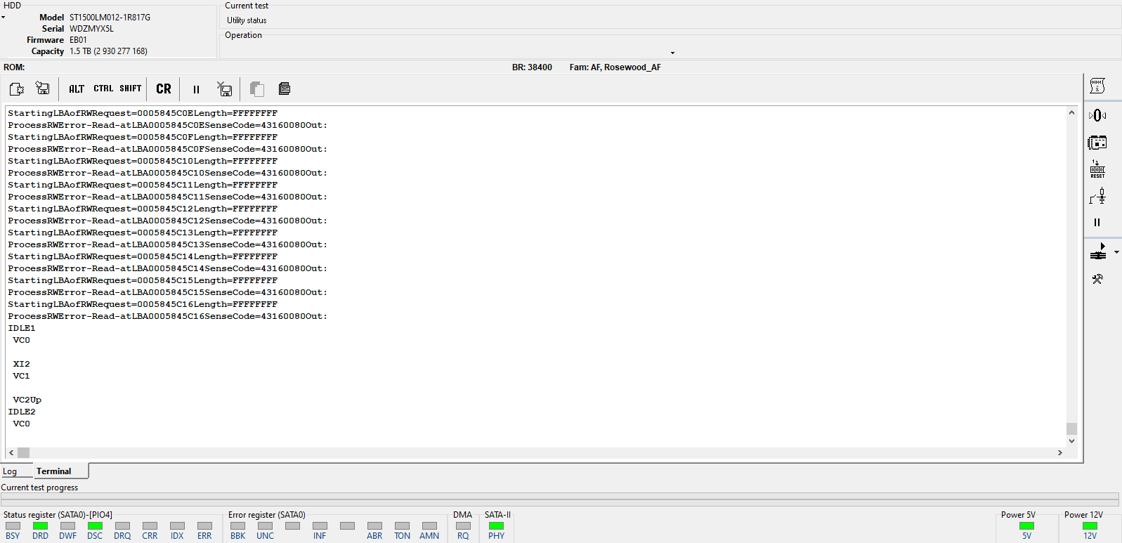

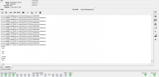

I have stopped background scanning of this Rosewood disk & I could Image using 3 heads at 25Mb/Sec.However Head 3 is very slow in reading ( 30KB/sec)
Besides Weak head is there any FW related issue that needs to be addressed for Head3
Can someone pls suggest.
Terminal shows following -
QB
Rst0x80M
TCC:0025:002E EMCDataErr:00000013
PrgF
PrgF
(P)SATAReset
RAWOFF
PASS
Primaryislatest!-00000001Out:Out:
DSC PASSOut:Out:
6GbMaxSpeedloweredto3GbforIntelbug
SendStatus:COMRESETseen
CSpd=3Gbps
FIS34
IDLE1
VC0
XI2
VC1
VC2Up
IDLE2
VC0
VC1
VC2Up
XI2
TCC:0025:0028 EMCDataErr:00000000
FAFH_TRIGGER_POWER_UP
IDLE2
VC0
SetTransferModeselected
UltraDMAselected
VC1
VC2Up
XI2
TCC:0022:0025 EMCDataErr:00000000
StartingLBAofRWRequest=0005845A01Length=FFFFFFFF
ProcessRWError-Read-atLBA0005845A01SenseCode=43160080
TCC:0022:0029 EMCDataErr:00000000
(S)SATAReset
CSpd=3Gbps
FIS34
(S)SATAReset
CSpd=3Gbps
FIS34
UltraDMAselected
ProcessRWError-Read-atLBA0005845A01SenseCode=43160080ProcessRC:00000000,00000000[Host]ReadContinuous:058459DD,00000176UnrecovSectorCount:0176,0175,0176NumUDEs:00000176,00000000,00000175Passed(Host):00000080,0000012BOut:AdjusttoDiscEndLba:
PrgFSkipLBA:05845A01,05845A01
StartingLBAofRWRequest=0005845A02Length=FFFFFFFF
ProcessRWError-Read-atLBA0005845A02SenseCode=43160080Out:
StartingLBAofRWRequest=0005845A80Length=FFFFFFFF
ProcessRWError-Read-atLBA0005845A84SenseCode=43160080Out:
ProcessRWError-Read-atLBA0005845A85SenseCode=43160080Out:
ProcessRWError-Read-atLBA0005845A86SenseCode=43160080Out:
ProcessRWError-Read-atLBA0005845A87SenseCode=43160080Out:
(S)SATAReset
CSpd=3Gbps
FIS34
(S)SATAReset
CSpd=3Gbps
FIS34
UltraDMAselected
ProcessRWError-Read-atLBA0005845A80SenseCode=43160080ProcessRC:00000001,00000000[Host]ReadContinuous:058459DD,00000176UnrecovSectorCount:0176,0175,0176NumUDEs:00000176,00000000,00000175Passed(Host):00000080,0000012BOut:AdjusttoDiscEndLba:
PrgFSkipLBA:05845A80,05845A80
StartingLBAofRWRequest=0005845A81Length=FFFFFFFF
ProcessRWError-Read-atLBA0005845A81SenseCode=43160080Out:
StartingLBAofRWRequest=0005845A82Length=FFFFFFFF
ProcessRWError-Read-atLBA0005845A82SenseCode=43160080Out:
StartingLBAofRWRequest=0005845A83Length=FFFFFFFF
ProcessRWError-Read-atLBA0005845A83SenseCode=43160080Out:
StartingLBAofRWRequest=0005845A84Length=FFFFFFFF
StartingLBAofRWRequest=0005845A85Length=FFFFFFFF
StartingLBAofRWRequest=0005845A86Length=FFFFFFFF
StartingLBAofRWRequest=0005845A87Length=FFFFFFFF
StartingLBAofRWRequest=0005845A88Length=FFFFFFFF
ProcessRWError-Read-atLBA0005845A88SenseCode=43160080Out:
StartingLBAofRWRequest=0005845A8ELength=FFFFFFFF
ProcessRWError-Read-atLBA0005845A91SenseCode=43160080Out:
StartingLBAofRWRequest=0005845A9ELength=FFFFFFFF
ProcessRWError-Read-atLBA0005845A9ESenseCode=43160080Out:
StartingLBAofRWRequest=0005845A9FLength=FFFFFFFF
ProcessRWError-Read-atLBA0005845A9FSenseCode=43160080Out:
ProcessRWError-Read-atLBA0005845AA0SenseCode=43160080
(S)SATAReset
CSpd=3Gbps
FIS34
(S)SATAReset
CSpd=3Gbps
FIS34
UltraDMAselected
StartingLBAofRWRequest=0005845AA0Length=FFFFFFFF
ProcessRWError-Read-atLBA0005845AA0SenseCode=43160080Out:
StartingLBAofRWRequest=0005845AA1Length=FFFFFFFF
ProcessRWError-Read-atLBA0005845AA1SenseCode=43160080ProcessRC:00000001,00000000[Host]ReadContinuous:058459DD,00000176UnrecovSectorCount:0176,0175,0176NumUDEs:00000176,00000000,00000175Passed(Host):00000080,0000012BOut:AdjusttoDiscEndLba:
PrgFSkipLBA:05845AA1,05845AA1
StartingLBAofRWRequest=0005845AA2Length=FFFFFFFF
ProcessRWError-Read-atLBA0005845AA2SenseCode=43160080ProcessRC:00000001,00000000[Host]ReadContinuous:058459DD,00000176UnrecovSectorCount:0176,0175,0176NumUDEs:00000176,00000000,00000175Passed(Host):00000080,0000012BOut:AdjusttoDiscEndLba:
PrgFSkipLBA:05845AA2,05845AA2
StartingLBAofRWRequest=0005845AA3Length=FFFFFFFF
ProcessRWError-Read-atLBA0005845AA3SenseCode=43160080Out:
