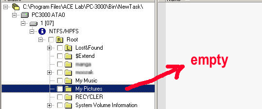

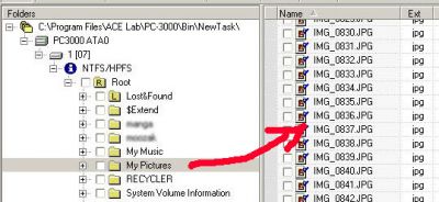

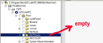

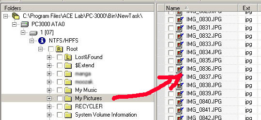

Hi guys, have you guys come across in Data Extractor sometimes you can see the full directory structures but when you click on the individual directory and not showing contents? But if you restart the task it will appear again. Is this DE software bugs or the actual directory structures are corrupted?
File comment: Click on "My Pictures" all files disapperas

Well, I'm not sure if it's a bug, but in fact sometimes costumers told me that it missed some data on their recoveries and then I run r-studio on the drive and found them all.
I think it has something to do with drive with bad sectors, that maybe DE can't overpass them well while reading structure.

IMHO depends on how DE read data and structures. So it is related to bad sectors. If you are using DE in "structure only" mode, it reads the related sectors every time you start the task (I suppose)...
A trick I use is to start the task with "Make data copy" flag on, and then go to structure window. In this way you need only to read one time from faulty drive, 'cause DE will use copied sector from target drive.

Right-click on the folder -> Rescan. Usually helps :)
