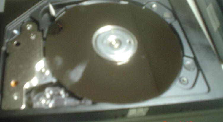

Hi to all!
update
1)when binding hd delays one 30 seconds for is ready (n40p)
2)hdd already arrived open and dirty platter with digital of the thumb of the user, of the opposing side of the data
:roll:

sempre wrote:
Hi to all!
update
:roll:
LOOK!

 Post subject: Re: MAXTOR N40P PROBLEM
PostPosted: November 12th, 2007, 0:25
Posts: 1517
Location: Mexico
Sempre, on this HDD the heads read´s under the platter , so there´s no problem if u get a finger print on this side, but if u had some scratch on the SA, under the platter u could be get some problems , i find one of this Maxtor slimline with a head crash, the only way its lef´s the platter with handle and a clean enviroment, if this hdd was checking by another people, maybe they tried the platter swap, and believe or not, some people left the platter on the another side.
Best Regards
