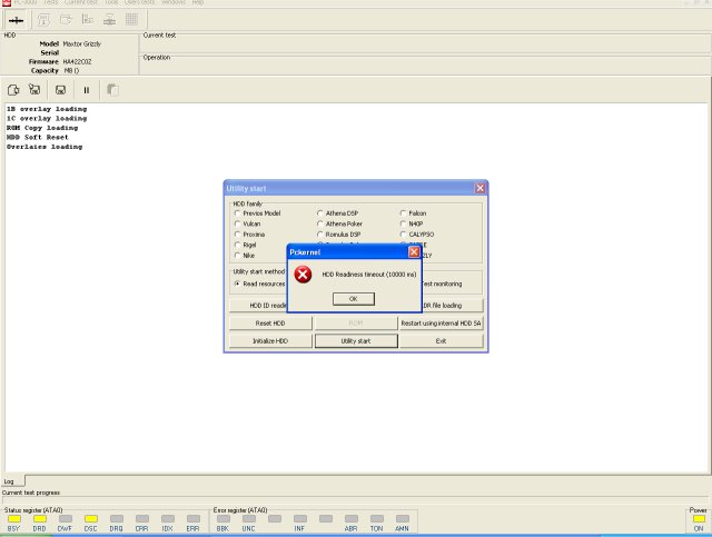

I have a Maxtor DiamondMax 11 500GB SATA Hard Disk drive (Model: 6H500F008A21L) which i believe may have a firmware problem. I'm not sure how to solve this problem and was hoping for some suggestions.
The drive powers on, the BSY light is on in the PC-3000 PCI for Windows, the drive makes a beep like clicking sound about 4-5 times, then that noise stops. The drive sounds like it's spinning normally now and it's ready under PC-3000.
The drive is detected as GRIZZLY and not it's correct model and no serial # is detected.
I have an identical PCB, swapped the boards - same problem. I also made a loader file from the identical disk i have and started my faulty drive with the loader, i got the following error below. Any tips on what to try next?
Data recovery is critical so do not want to take any actions which may erase the data. Any tips on what to try next?

Wait for some time till the drive gives DRDY and DSC .

After about 1 minute it does go to that state, but i still cannot do much with the drive. I have also changed the timeout to about 400 seconds, still it has that error. Any tips on what to try?

After going to ready state then enter utility .

When i do that it gives the error message i attached in the screenshot in my 1st post. :(

Loader loading procedure has been changed in new Maxtor drives (like Grizzly, Sabre2 and Shasta) and this PC3000 utility cannot load loader for these models at all
There is no free software to solve this issue
I think in new PC3000 UDMA this problem has been fixed (but I'm not sure)
