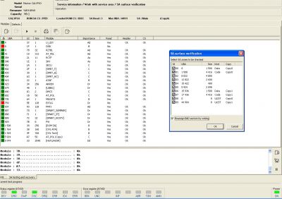

Hi All,
I have a Maxtor hard disk with a firmware problem. It's detected in BIOS as Maxtor CALYPSO.
The disk sounds normal and does not make any unusual sounds.
I am using PC-3000 PCI for Windows With Data Extractor. Scanning the module table it appears 2 modules are unreadable. 1 of these is critical to restore the drive to be able to recover the data (this is my goal).
I believe the disk may have a bad sector or problem reading for this module. I have run the option in PC-3000 called 'SA Surface Verification' and have ticked 'reassign bad sectors by writing' but this has not helped. The results are below as well as a screenshot attached.
Any suggestions on what else to try?
Thanks in advance for any assistance.
Zed
File comment: PC-3000 Screenshot
Applying SRV
SA writing test
Data writing
Data reading
Writing test finalized with error. Recovery is imposible.
SA surface verification
Zone Id ................................... 0
Start UBA ............................ 8
Size ................................. 1 500
8 ......................................... Maxtor techno command error. Command : 53. Code : 0111 C/H/S : 89717/3/8
759 ....................................... Maxtor techno command error. Command : 53. Code : 0111 C/H/S : 89718/3/375
760 ....................................... Maxtor techno command error. Command : 53. Code : 0111 C/H/S : 89718/3/375
761 ....................................... Maxtor techno command error. Command : 53. Code : 0111 C/H/S : 89718/3/375
Errors .................................... 4
Zone Id ................................... 1
Start UBA ............................ 1 508
Size ................................. 4 416
Errors .................................... 0
Zone Id ................................... 2
Start UBA ............................ 8 022
Size ................................. 4 800
Zone Id ................................... 3
Start UBA ............................ 12 822
Size ................................. 2 600
Zone Id ................................... 4
Start UBA ............................ 15 422
Size ................................. 400
Zone Id ................................... 5
Start UBA ............................ 5 924
Size ................................. 2 098
Zone Id ................................... 6
Start UBA ............................ 15 936
15 936 .................................... Maxtor techno command error. Command : 53. Code : 0111 C/H/S : 89758/3/192
16 682 .................................... Maxtor techno command error. Command : 53. Code : 0111 C/H/S : 89760/3/170
16 683 .................................... Maxtor techno command error. Command : 53. Code : 0111 C/H/S : 89760/3/170
Errors .................................... 3
Zone Id ................................... 7
Start UBA ............................ 17 436
Zone Id ................................... 8
Start UBA ............................ 0
Size ................................. 8
Errors .................................... 1
Zone Id ................................... 9
Start UBA ............................ 44 904
Test completed

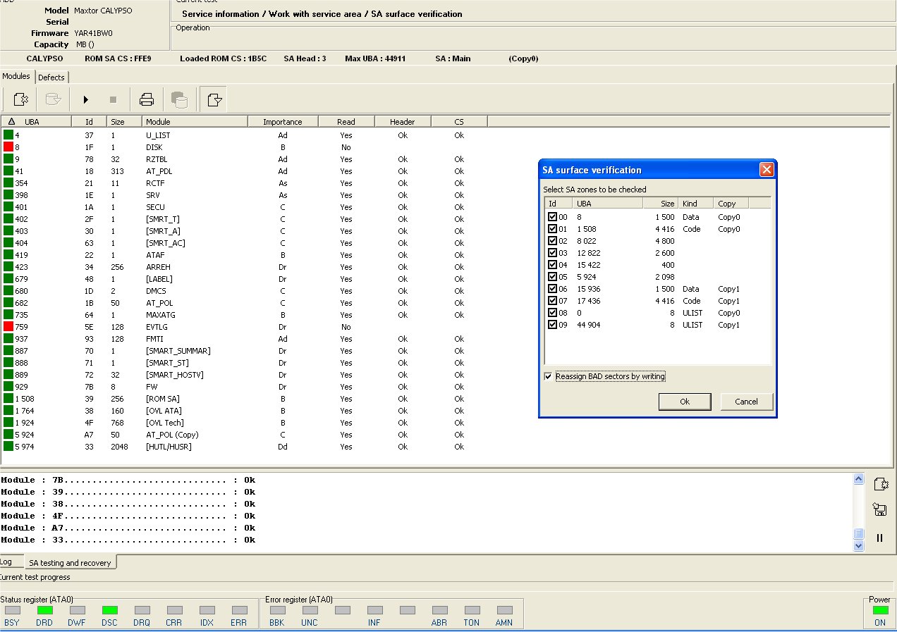

Hi ! normal capacity still undetected ? head map problem I think...Rewrite module #1F. Read again all modules and write back to SA.
I usually solve this problem using ISA. I don't know about PCI...

As far as I can understand, UBA 8 error means in ISA this model will be detected in safe mode as Cyl -1 Head 8 and so on (this is module #1F damaged). SA write test usually failed.

1 try to get a healthy identical one from the drive which has same mode, same capacity,same checksum,and overwrite then.
2 check the SA copy by running the other sa head and got a good 1F and overwrite .look,we may say the head you current operating is main one,and other heads working with the main one are secondary ,but they may have a sa copy too.

1. Put the hdd in safe-mode
2. Star with loader YCRXXXXX in alternate SA
3. Save modules and loader
4. No need data..., Run->Selfscan
