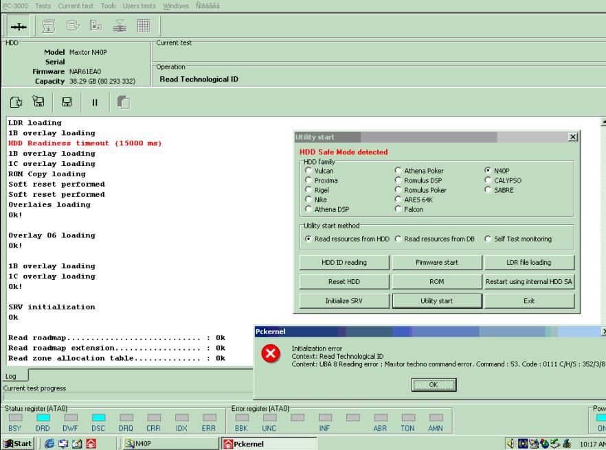

 Post subject: error hdd n40p
PostPosted: February 17th, 2009, 10:19
Posts: 1060
Hi to all! :mrgreen:
after to use loader of this error!
look

 Post subject: Re: error hdd n40p
PostPosted: February 18th, 2009, 0:05
Joined: March 15th, 2005, 12:49
Posts: 36
Location: Владивосток
It easy.
Write any module1F (Disk) for error correction.
PostPosted: February 18th, 2009, 5:00
Joined: January 23rd, 2009, 6:29
Posts: 110
bad loader
try another loader
PostPosted: February 18th, 2009, 8:56
Posts: 2984
If different LODR does not work, select 'Read Resources from Database' and load Road Map from database
PostPosted: February 18th, 2009, 9:20
Posts: 1060
Look... logs
2009SAMO.txt [997 Bytes]
Downloaded 825 times
20096E40.txt [7.84 KiB]
Downloaded 811 times
PostPosted: February 18th, 2009, 21:34
Posts: 36
27 1F 0008 0001 - - - DISK - disk ID module
